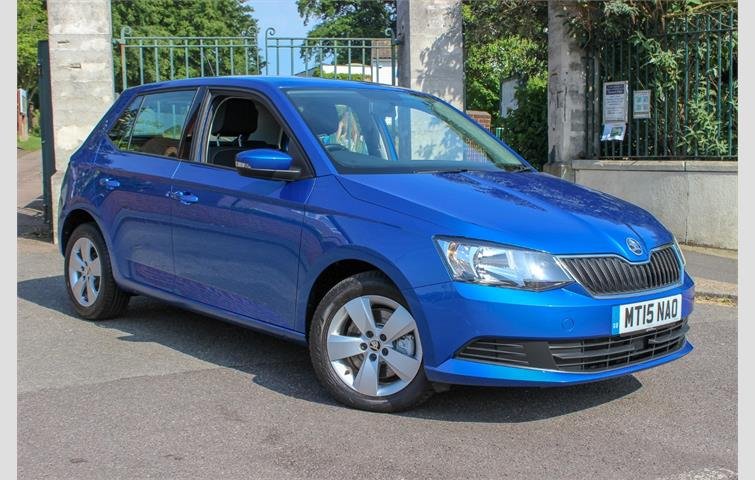

from thos headlights

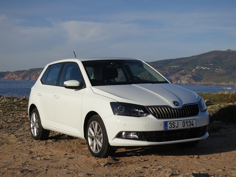

to this type of headlights
Needs coading. Dealership will not do it. So best ask round on the forum's. Or hope someone can on this site. They are not plug and play.
