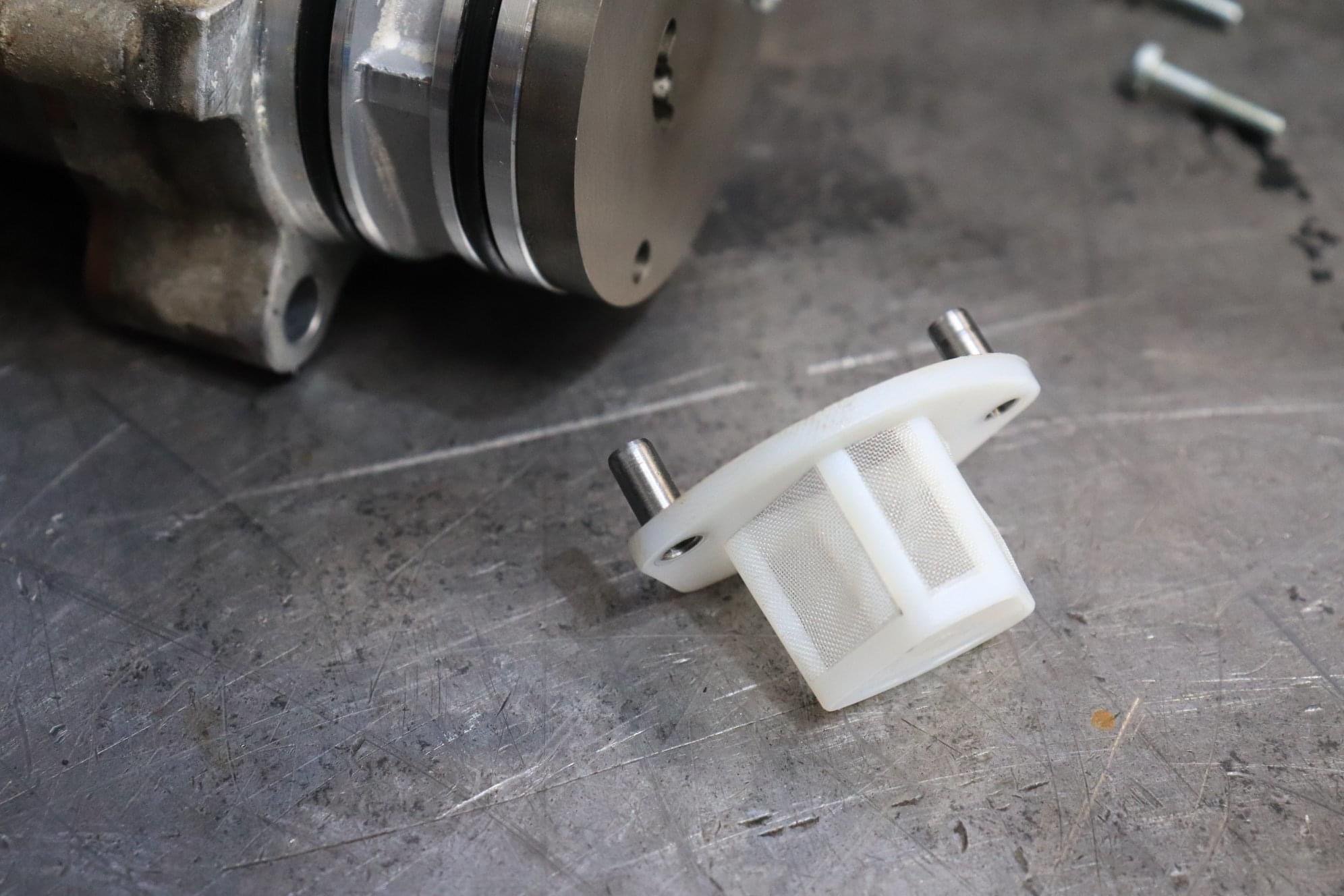

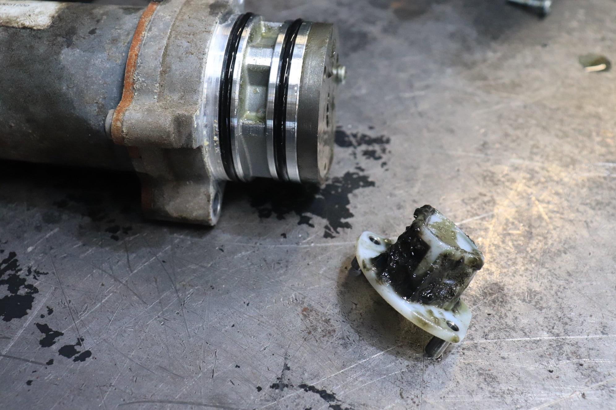

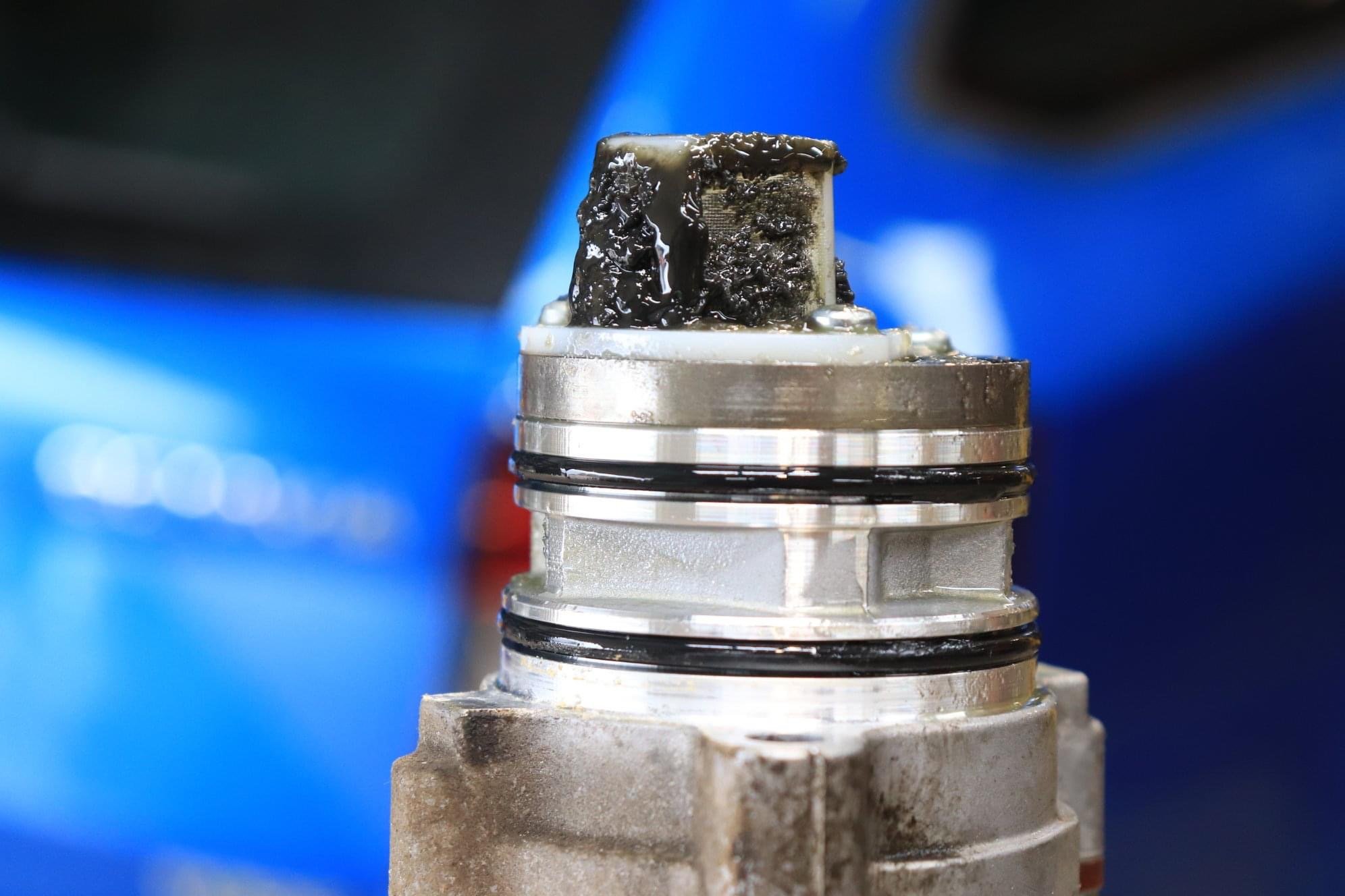

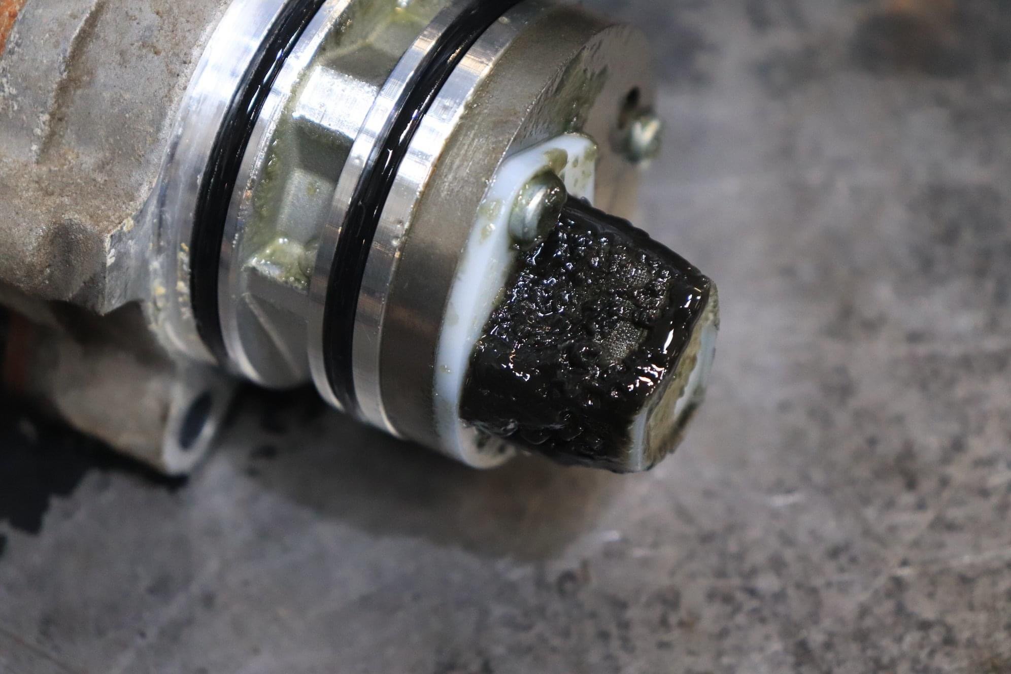

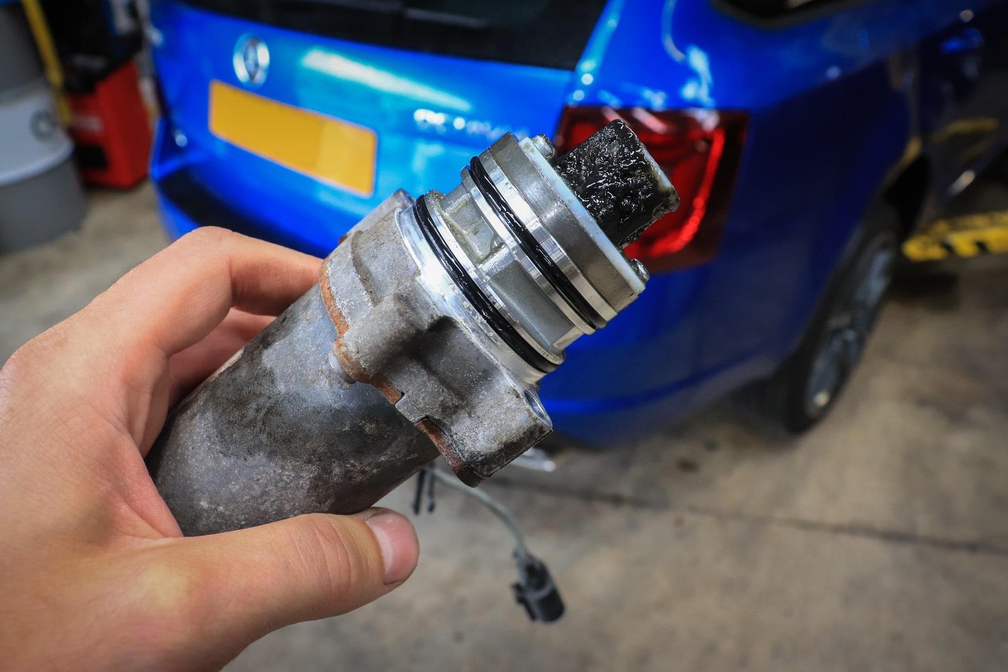

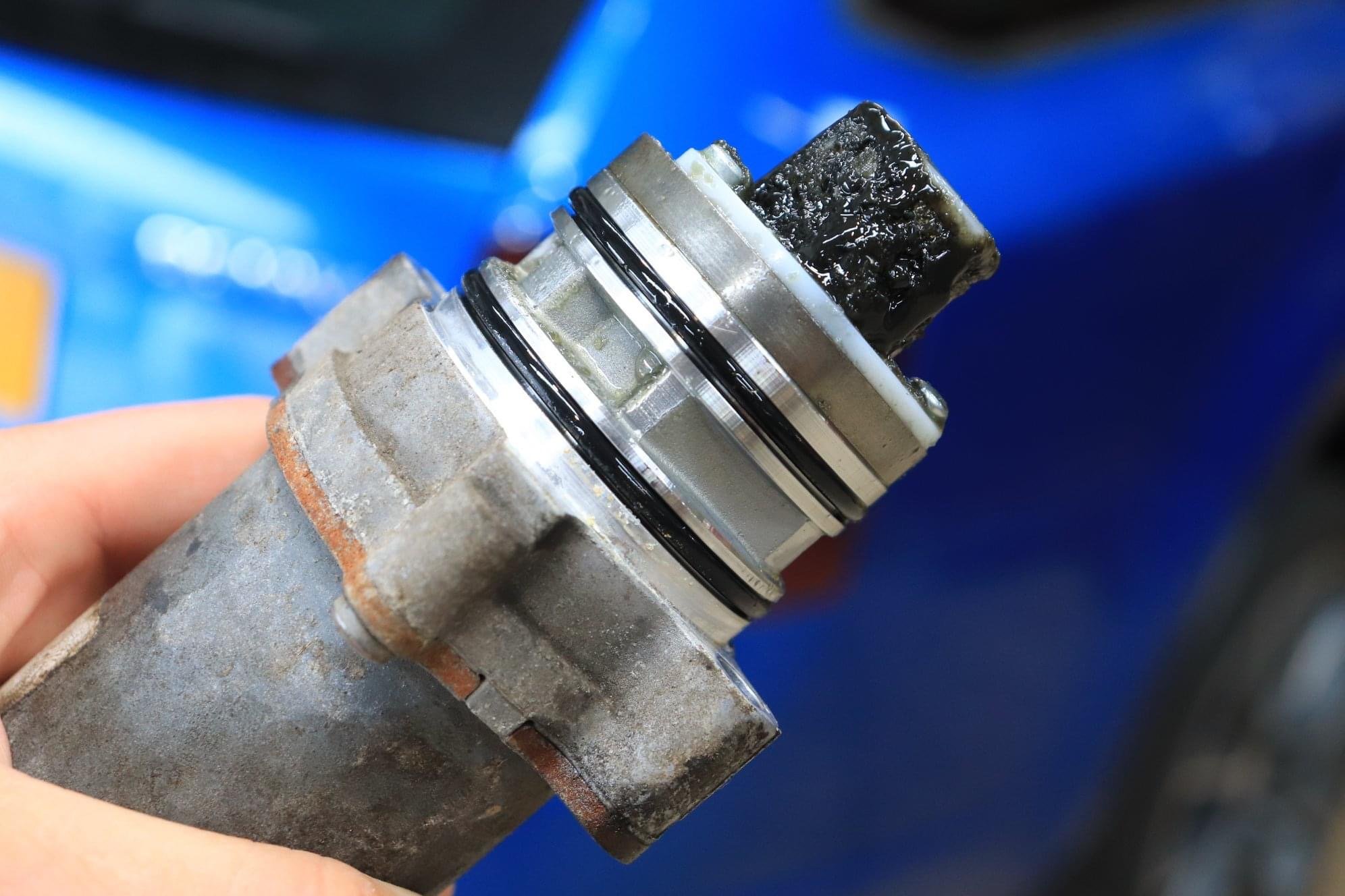

I own a 2018 Octavia vRS 4x4 Tdi, currently on 20200 miles and I decided to have the Haldex serviced (gauze clean and oil change) and good god am I glad I did.
As you can see from the pictures the gauze (which on the gen5 is the only accessible/ changeable filter) is completely caked in gunk and to be honest will most definitely been having a negative effect on the 4x4 system.
I strongly recommend you service yours at least at 20k intervals - certainly for the gen5, can’t speak for others!
