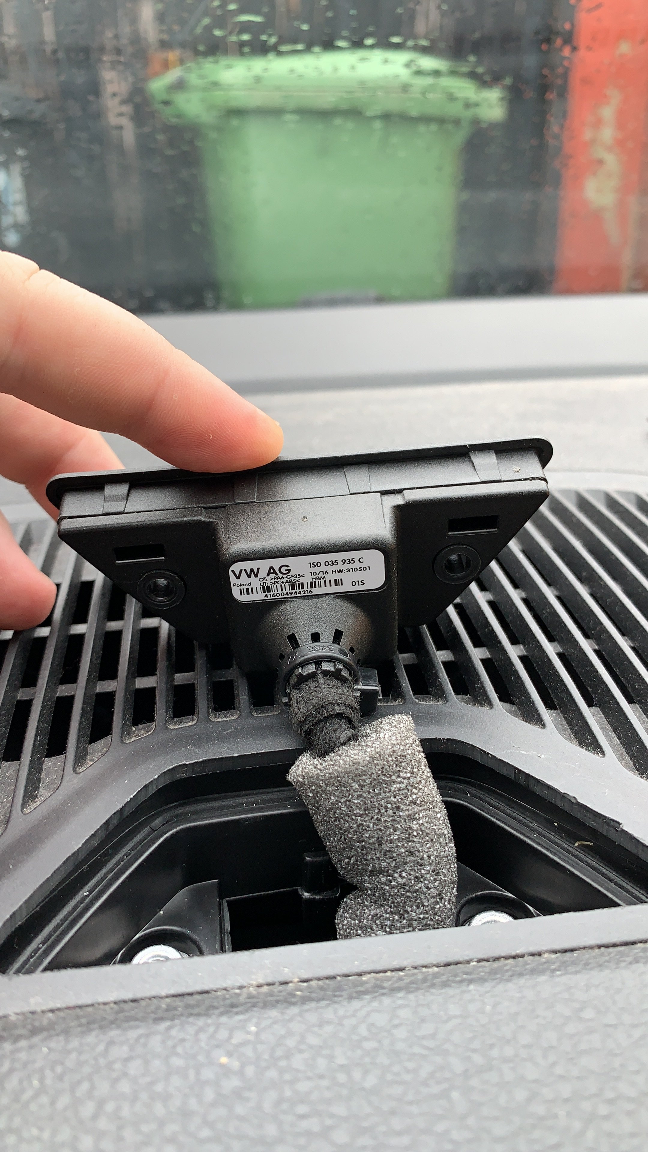

I have a 2016 Skoda Citigo & it has the GPS/Sat Nav dash mount. I recently purchased a replacement fitting so I could swap to the mobile phone mount but am having trouble replacing it. Does anyone have any advice?
I have attached pictures of my progress.

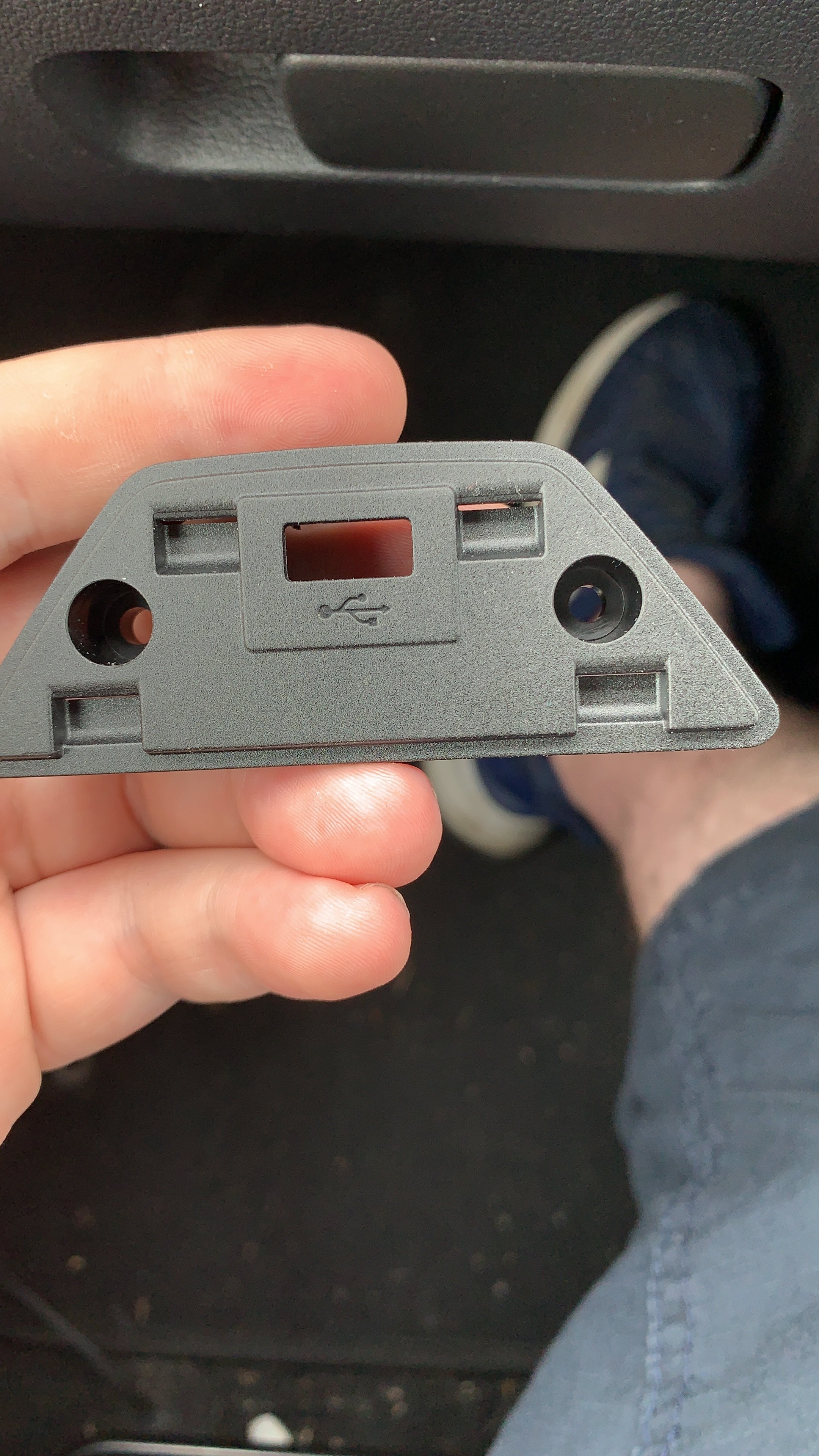

i brought the replacement part through eBay and arrived as only the top half of the connector to fit the new mount. In reality I just need to separate the plastic casing around the wires & replace it with my new one but I cannot seem to separate them

the file size limit isn’t helping me unfortunately. In the first image the seam under my finger is where I’m trying to separate the mount. The new mount adapter I want to use is the second picture and I only have what would be removed by separating the two parts along that seam in the first picture. I am not bothered about getting the usb up & running as my Phones battery life isn’t an issue so shouldn’t require the usb being functional
Ok, so it's just about getting the later mounting system (like mine I assume, with the clip-in grabber not shown) to simply be able to hold your phone, and all electrical considerations are not applicable....  I assumed the first pic looked like you could separate the two halves with 2 screws, but clearly it's not that simple from what you are saying. Are the two halves ultrasonically welded together? If so, you'll need a fine toothed hacksaw, or use a hot blade to melt and separate then epoxy the new top onto the old base?

Release the radio, and unplug the wiring. Release the blue socket from the main socket, and the antenna connector split. pullt is backwards up through the dashboard. its fixed twize with clips (you can just pull)
Now I'm about to find out if the radio, through the blue socket has a 12v output or a 5V / xAmp. If its a 5v i will put a USB cable direct on the blue socket  and wire it to the new mount in the dashboard.
