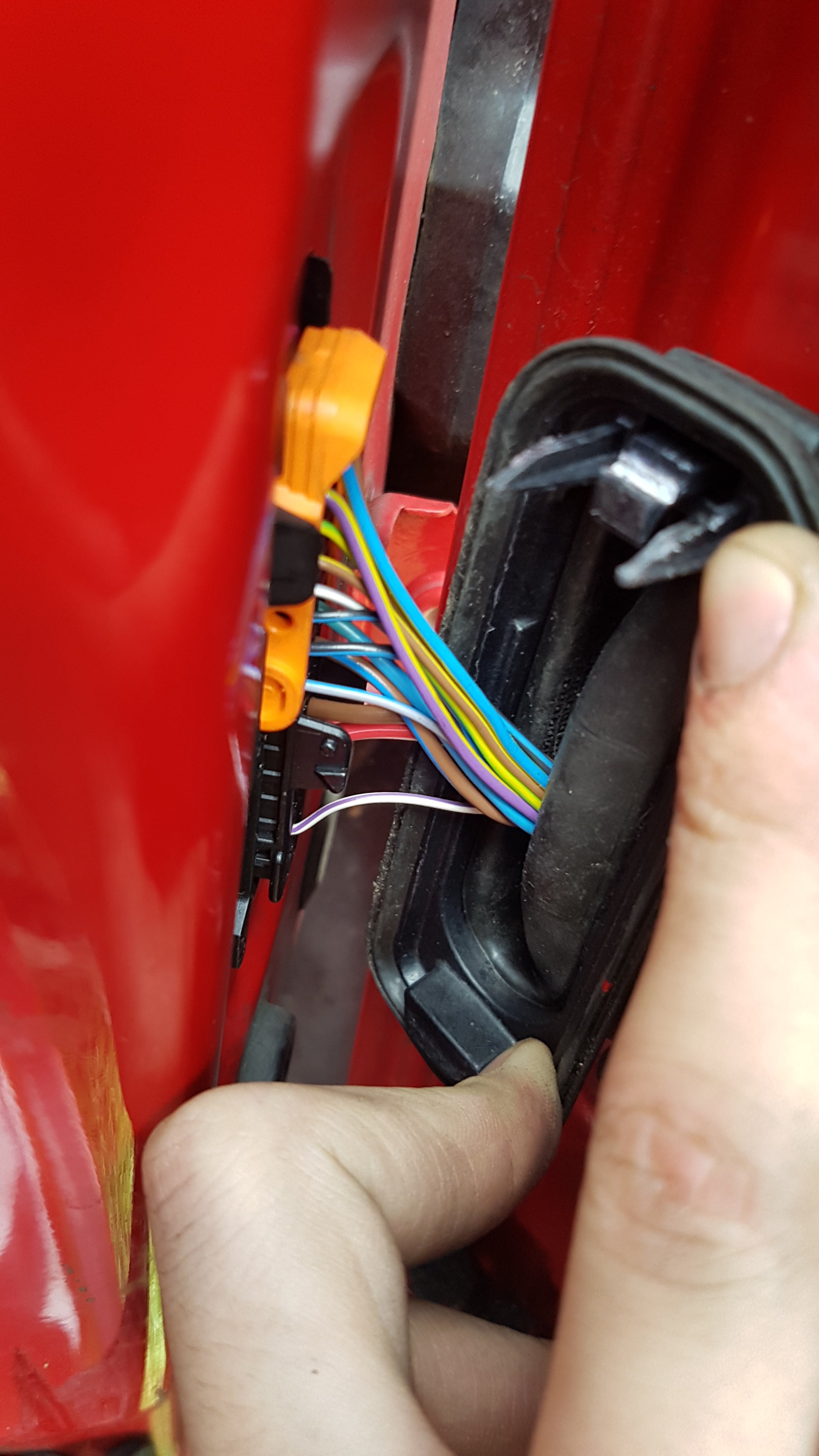

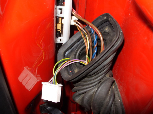

Have you checked for broken wires inside the door bellows?
Example...
Edited by TMB
All seems well there. May have to get behind the speaker at this rate.
