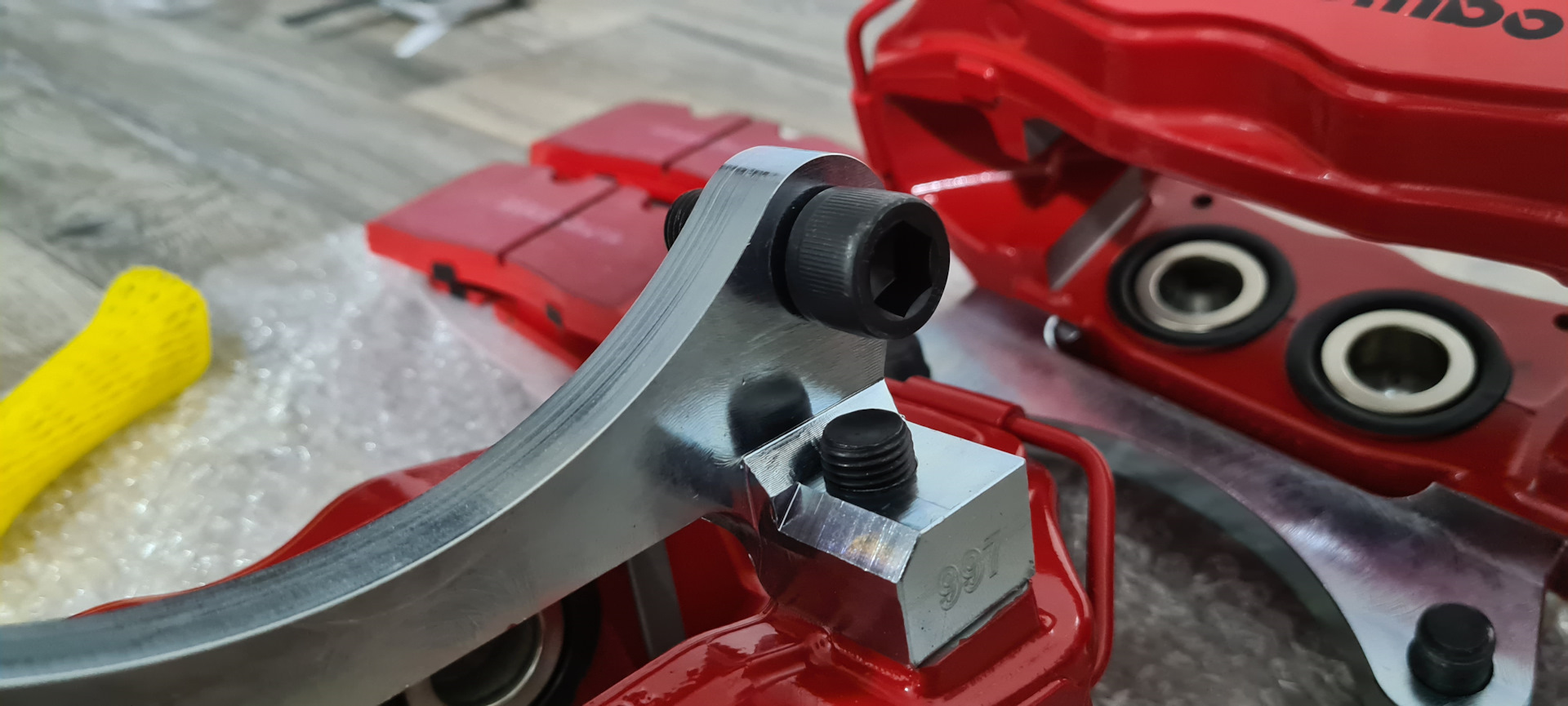

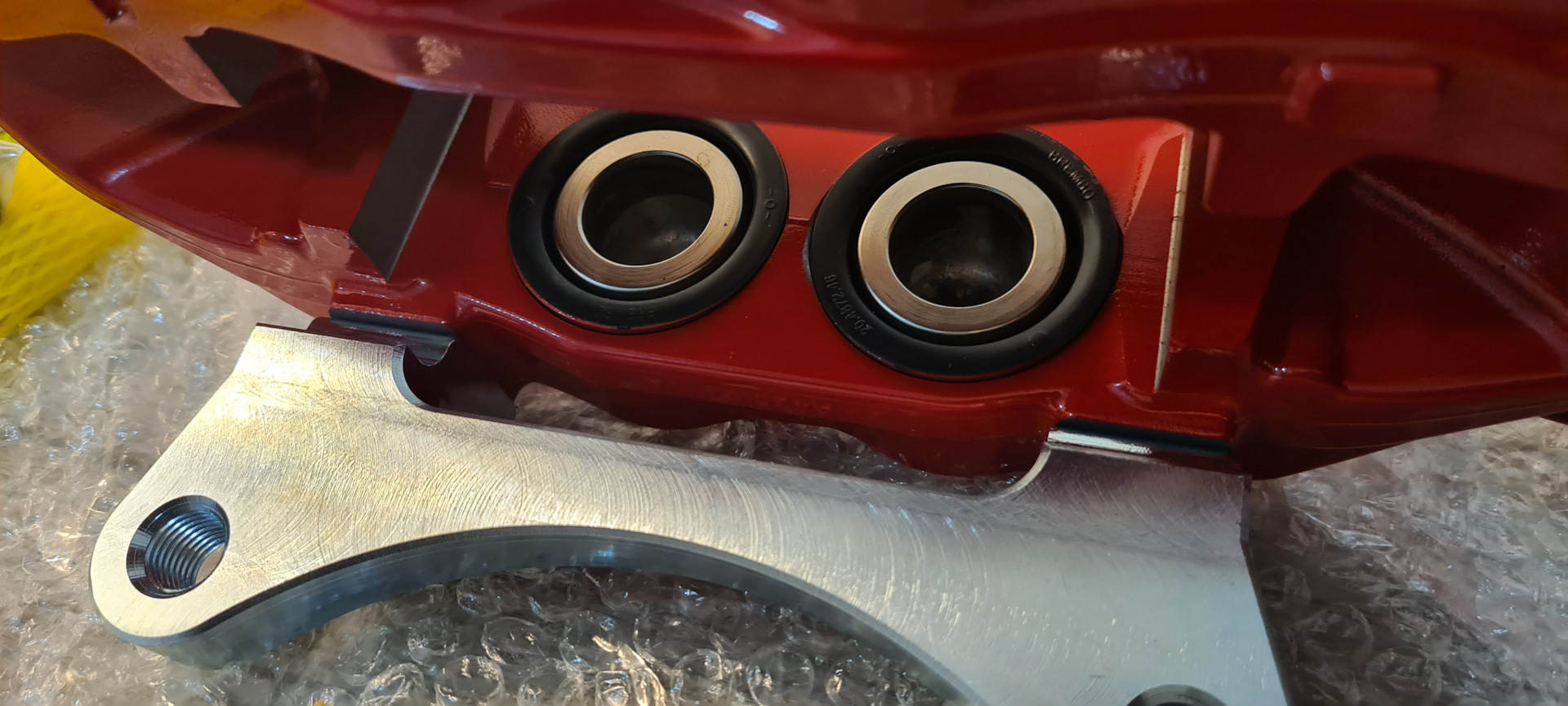

So , I took Brembo calipers from Renault Megane 3 RS 275hp
Brackets to fit 354mm disk

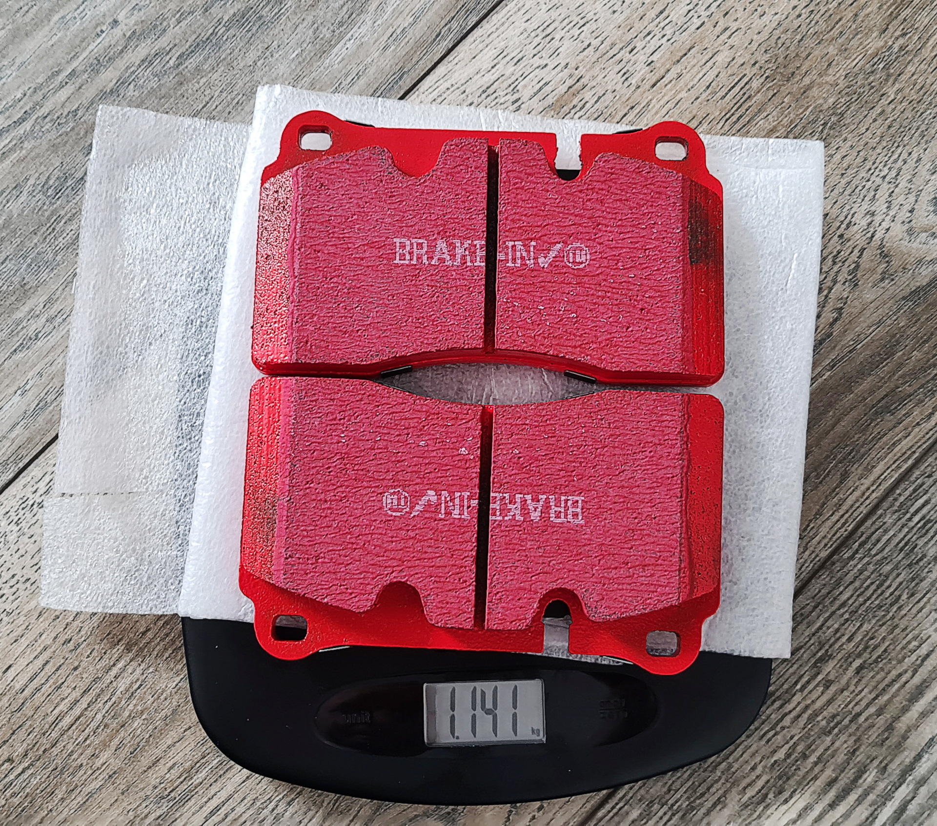

My favourite brake pads

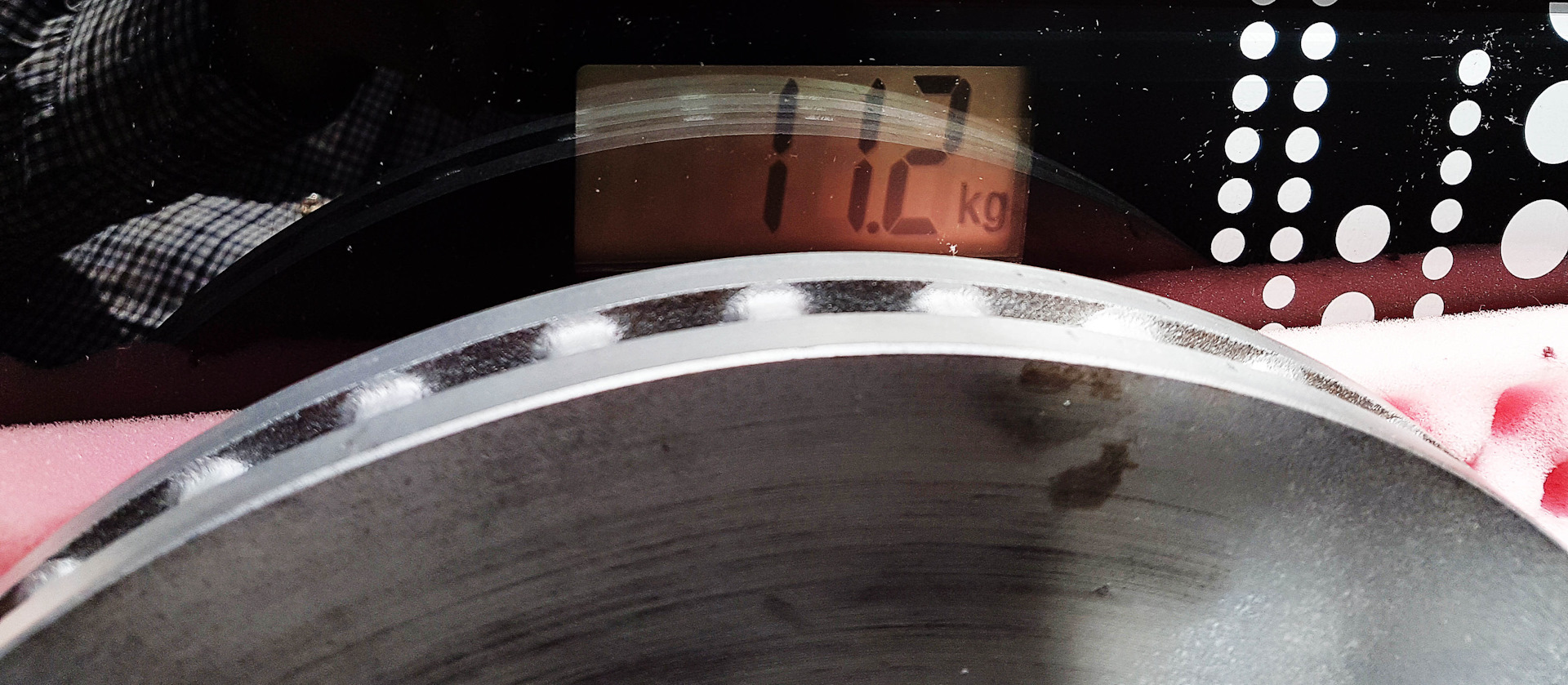

Brake disk temporary took EBC simple vented , as two peace cost to much for test.   This EBC rotor weight 11.800kg

In theory everything have to be bolt on , but this is what I think might not be the case, have a filing that bolts a bit to long, but when I install my new brakes  , will put here step by step guide  for ANY MQB car

Steel brackets for 345 Disk  ( There are options for 340 disk , but they are mostly aluminium alloys , so I decided to be on safe side) https://epytec.de/de/vw-golf-5-6-gti-audi-a3-tt-s3-8p-bremssatteladapter-renault-megane-rs-4-kolben-bremssattel-tuning-vo-13948

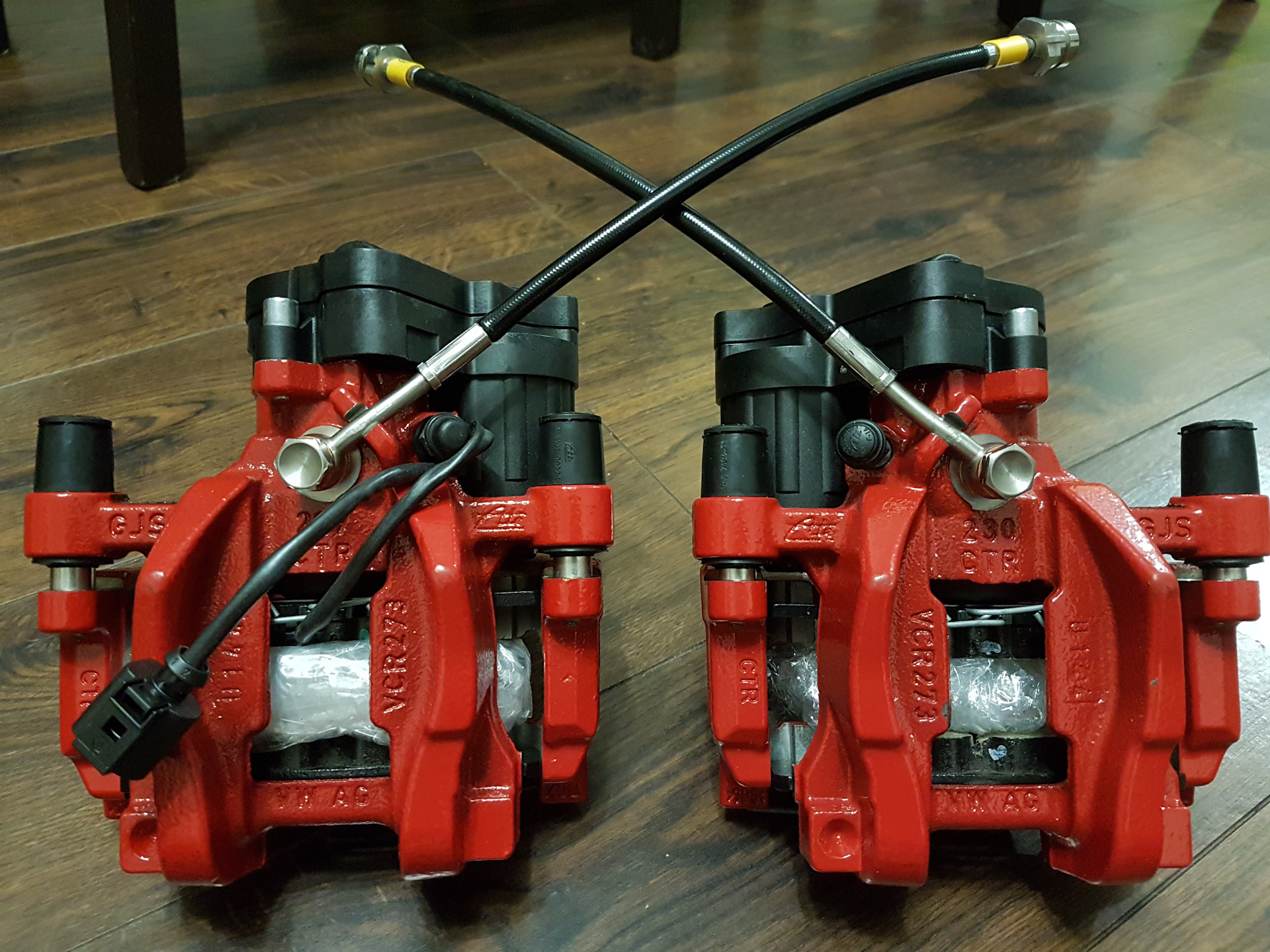

Rear brakes is way easier. The only place where you need to be a bit creative are dustshields if you running like me front wheel drive car.
Here are calipers ( brake lines attached are to short , and I am waiting for  new one at the moment as currently stock one are connected)
https://www.ebay.ie/itm/GENUINE-REAR-BRAKE-CALIPERS-310MM-VW-GOLF-Mk7-GTI-R-AUDI-A3-8V-S3-RS3-TTS-8S-NEW/303552076165?hash=item46ad1d1985:g:IQAAAOSw2H1d3~8v
Brakepads are this one ( I think , but I am waiting replacement as well , so  lets wait to confirm)- https://www.ebay.ie/itm/EBC-RedStuff-Rear-Pads-DP32173C-Golf-R-7-5-Audi-S3-8V-Leon-Red-Stuff/184375948982?ssPageName=STRK%3AMEBIDX%3AIT&_trksid=p2057872.m2749.l2649
The most interesting part of the setup is brake disk. Karoq with front wheel drive , do have solid 5x112  10mm depth , 272d ( as far as I remember)  and 58.9mm height rear disks.  4x4 have 50mm heigh disk ( aprox). So issue was that 10mm in heigh needs to be compensated  with some spacers for brake calipers, but that I found that AUDI TT 2008 , do have 22mm vented,  310mm diameter, and 58.3mm height disk which I installed bolt on  in my setup :)

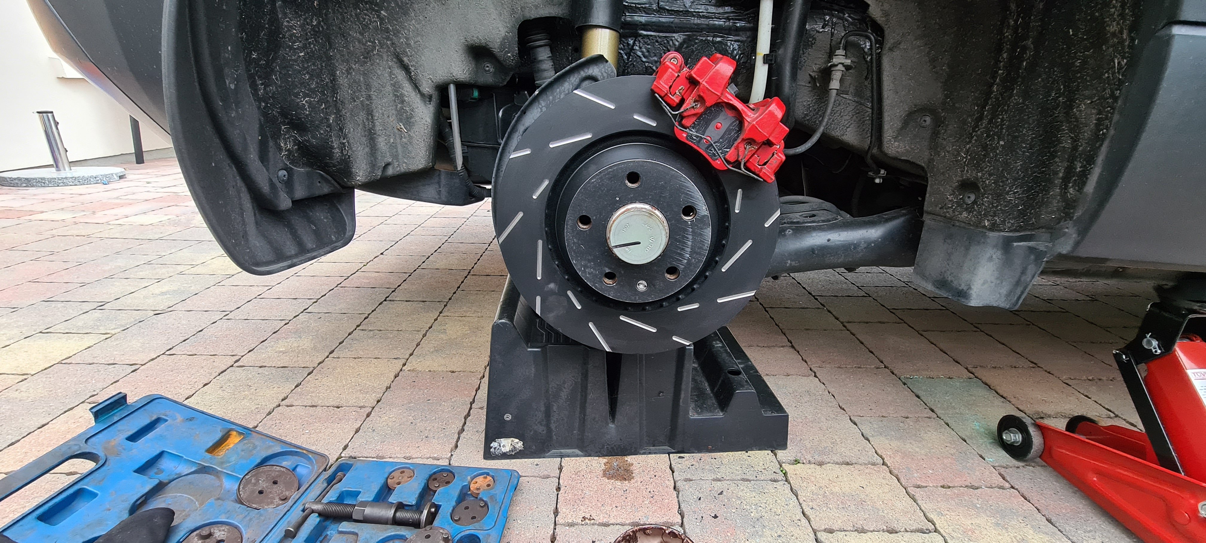

Did refresh of my rear brakes, as I relocate them from my previous skoda superb and brakepads effectively was used and 310mm brake disk I got was chepest one I could fine , as I was not sure if its fits to my Karoq.
Now brand new , but the same EBC Red Stuff brake pads and EBC slotted 310x22x60 brake disk. Still waiting braided brakelines  for rear.

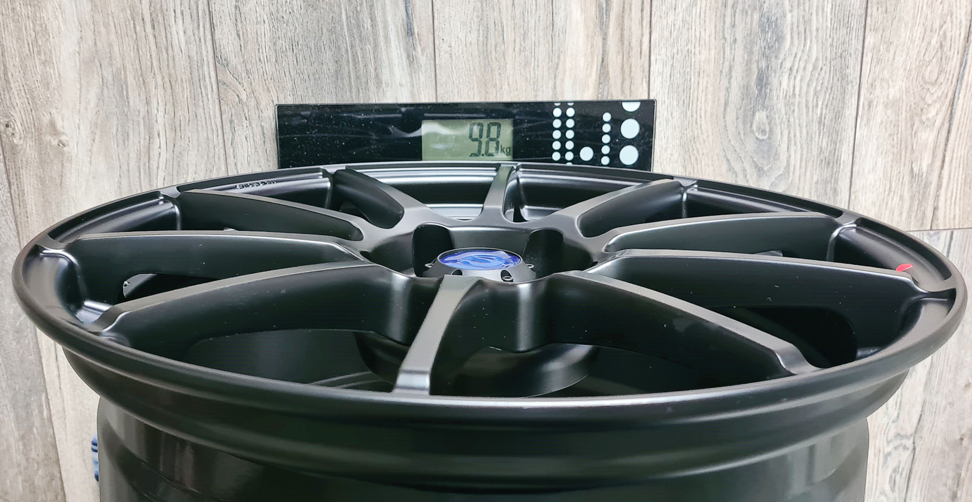

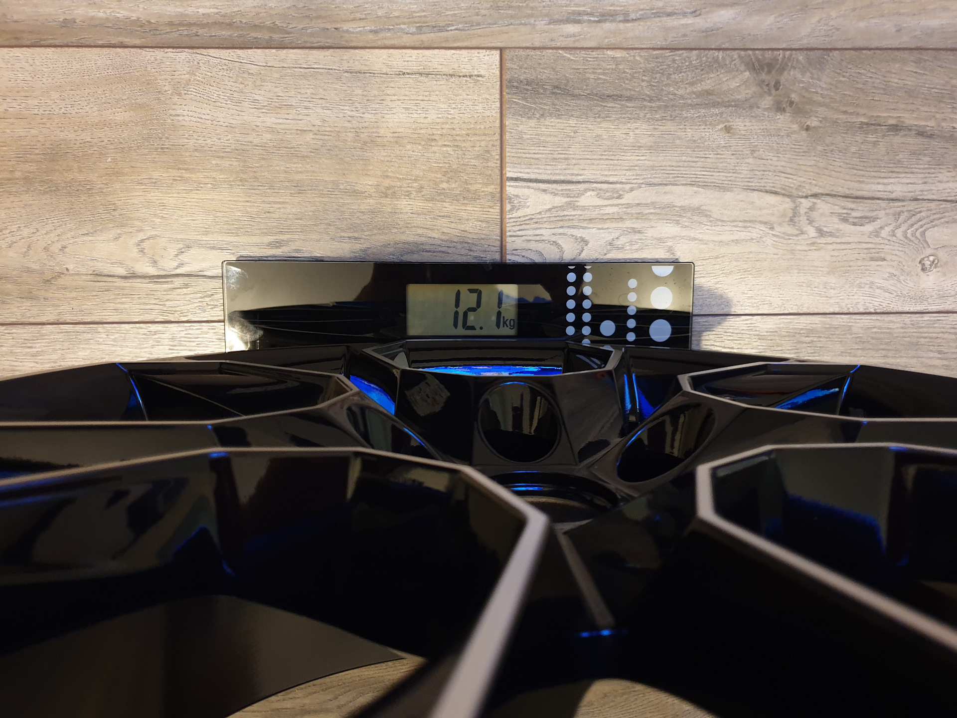

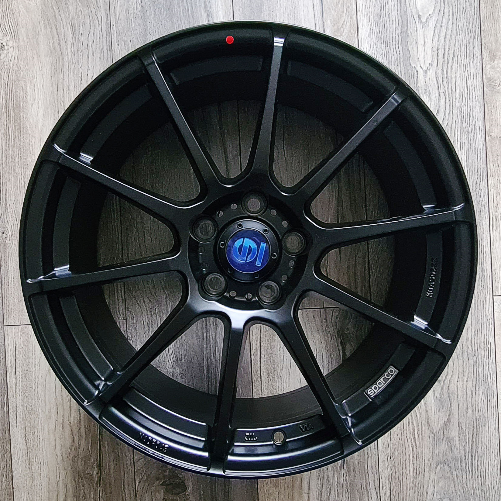

This project came to the final stage.  Tested callipers with ET45 wheels I have and failed. So I decided to put brand new Sparco Asseto Gara. J8xR18 ET35. So I will use the same tires.
Sparco wheels are 2.3 Kg lighter than my current Extreme replicas
Wheel design and high ET gives a lot of clearance for brake calipers

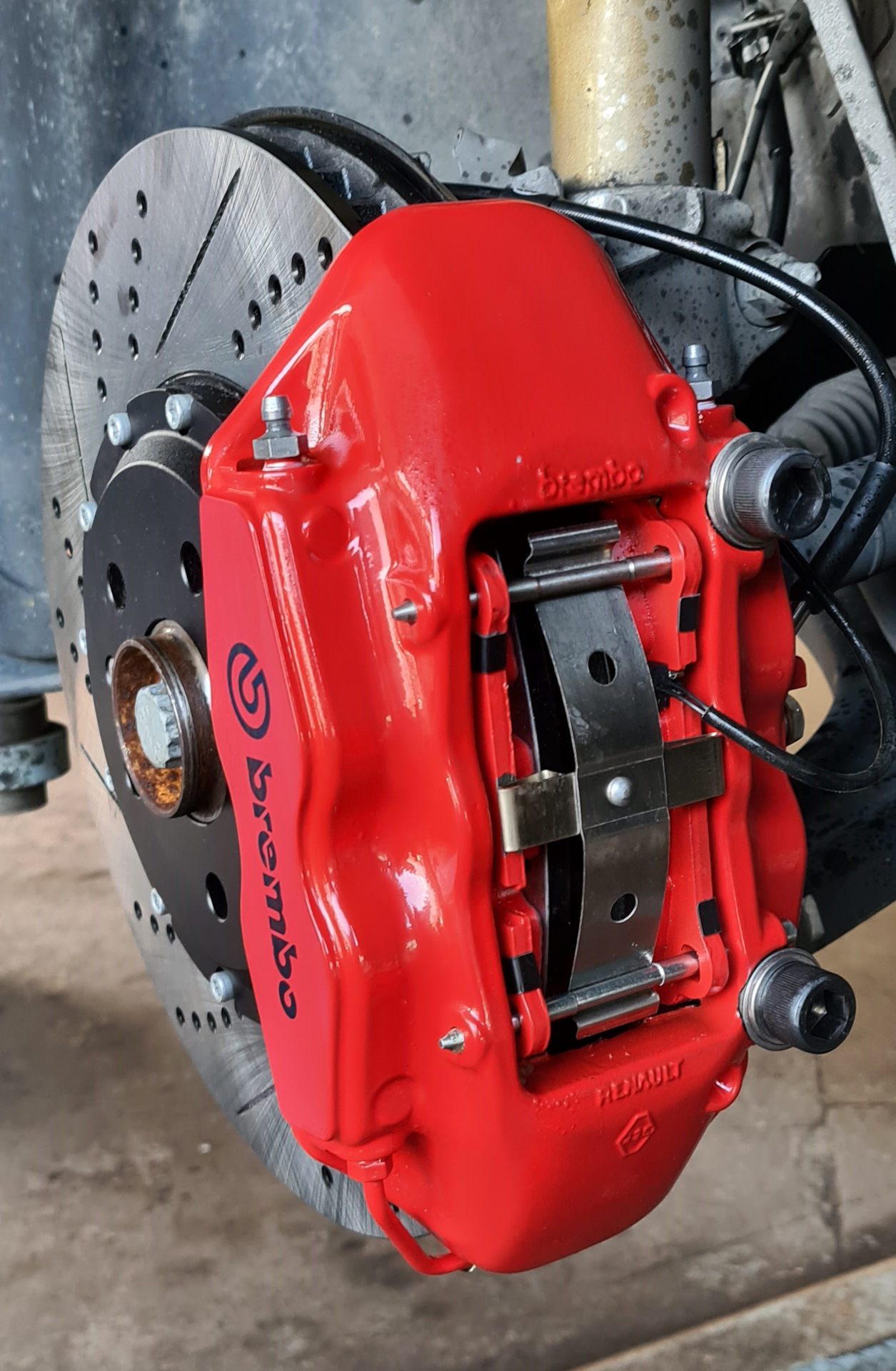

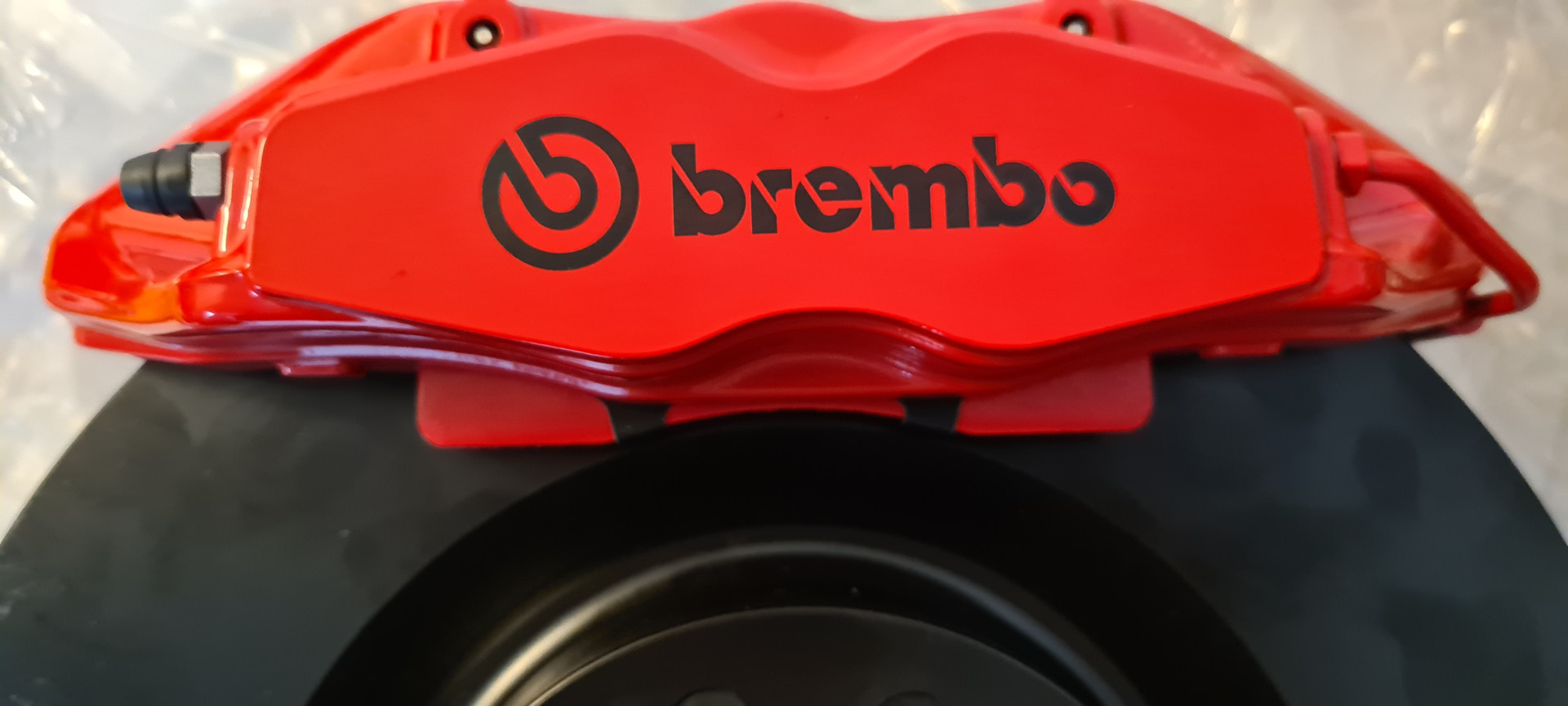

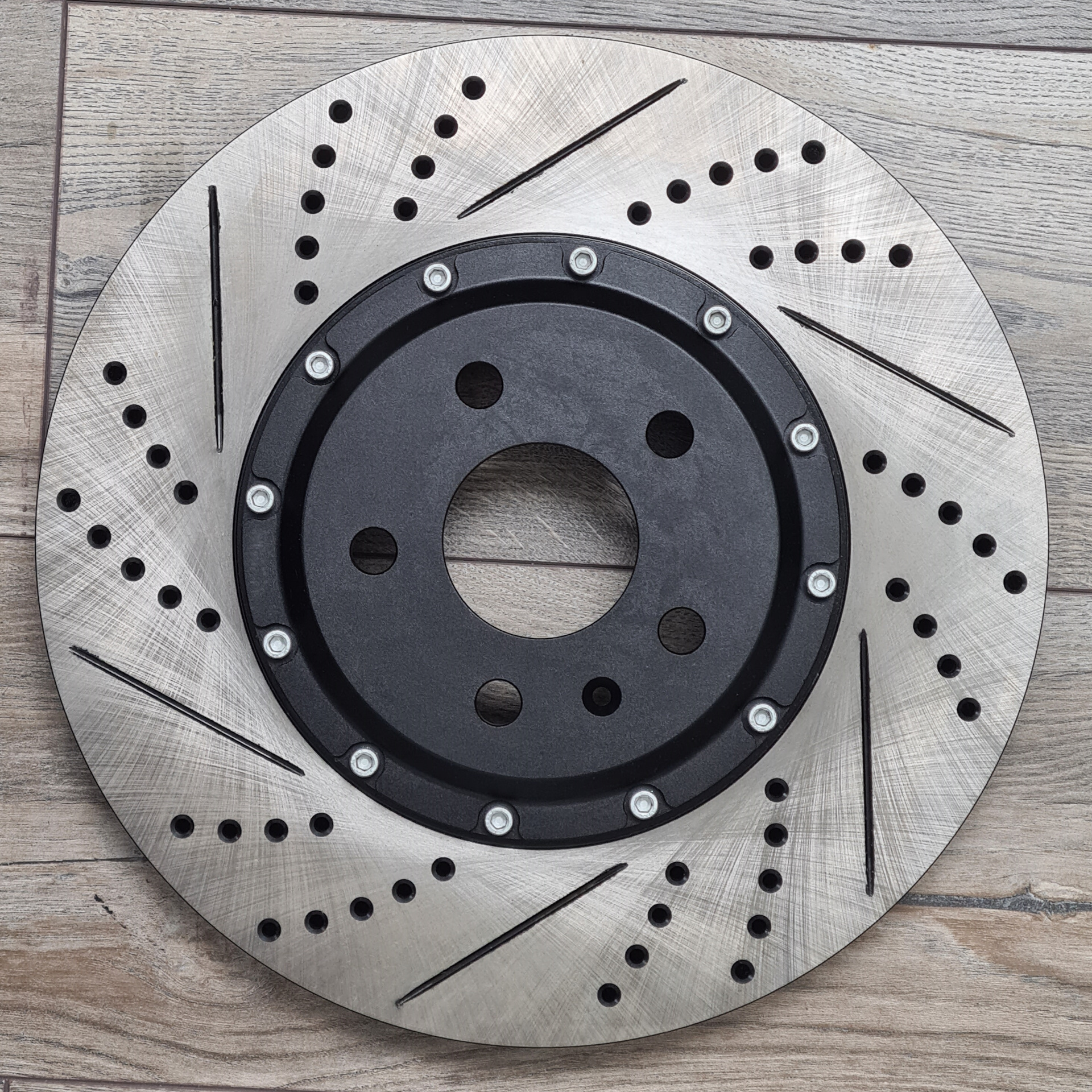

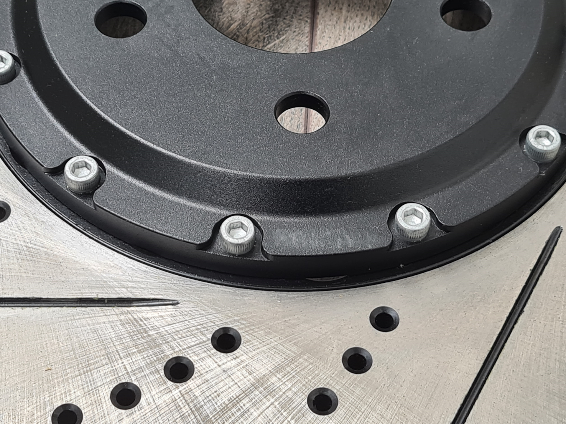

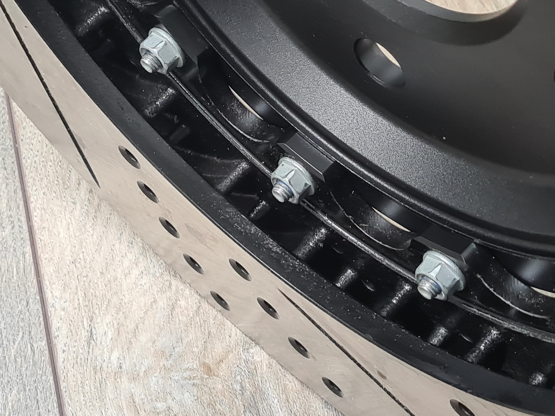

When I waited new alloys my new light two peace CEIKA brake rotors arrive. I expected them in 2 month time , but CEIKA was unbelievably quick. New disk are 345x30x50 and more than 2Kg lighter that solid 340x30x50.

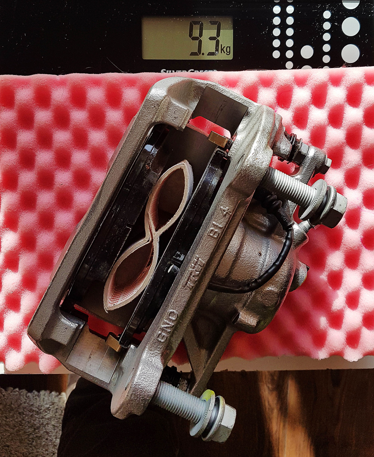

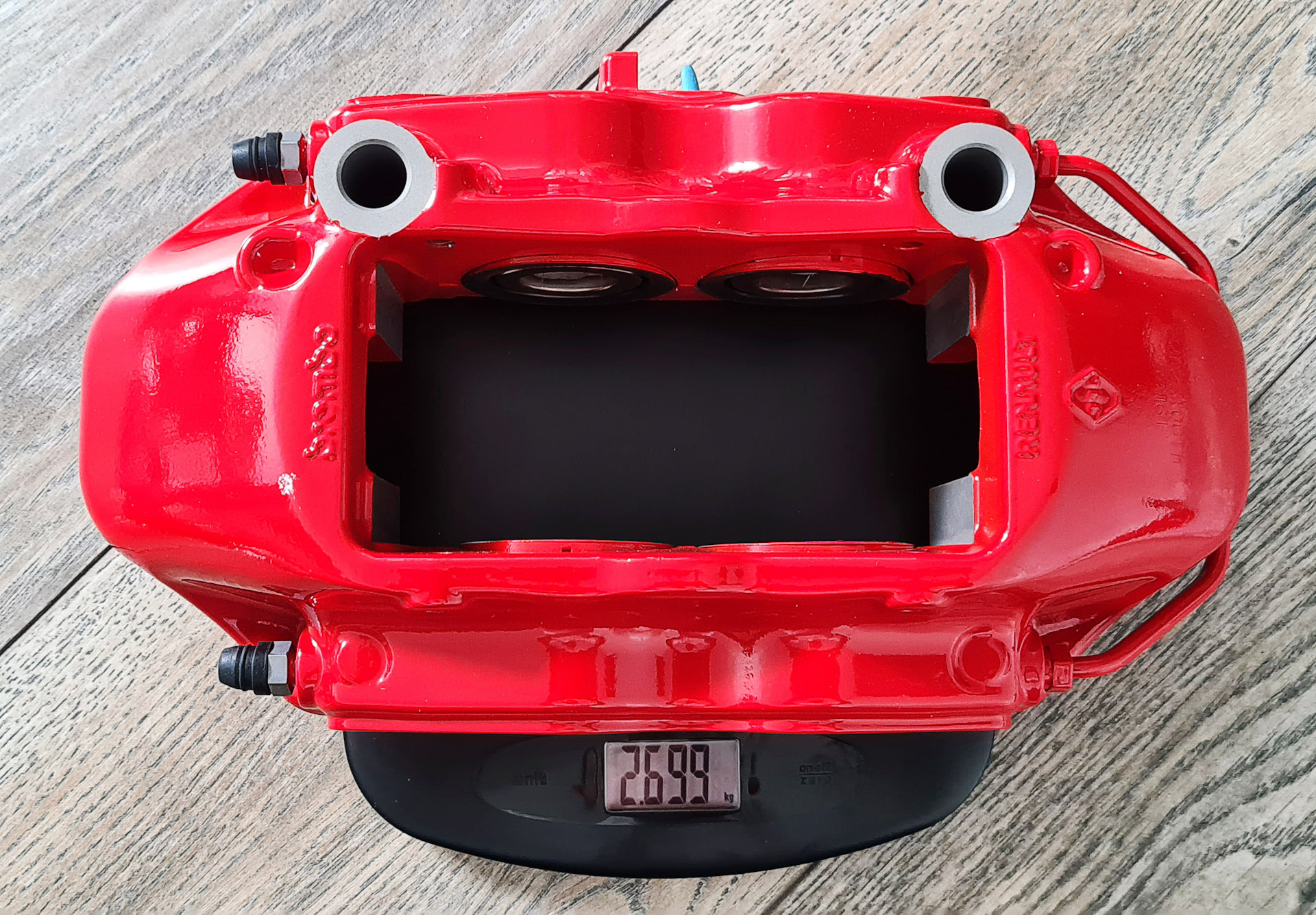

Fully assembled Brembo calipers with brakepads , brackets and bolts weight 5kg sharp. "Standard" calipers from 340mm Skoda Superb brakes weight 9.3Kg
Here is few more pictures of CEIKA beauty. Hopefully next photos will be of Installed alloys - brakes.
Rotors are directional with cooling

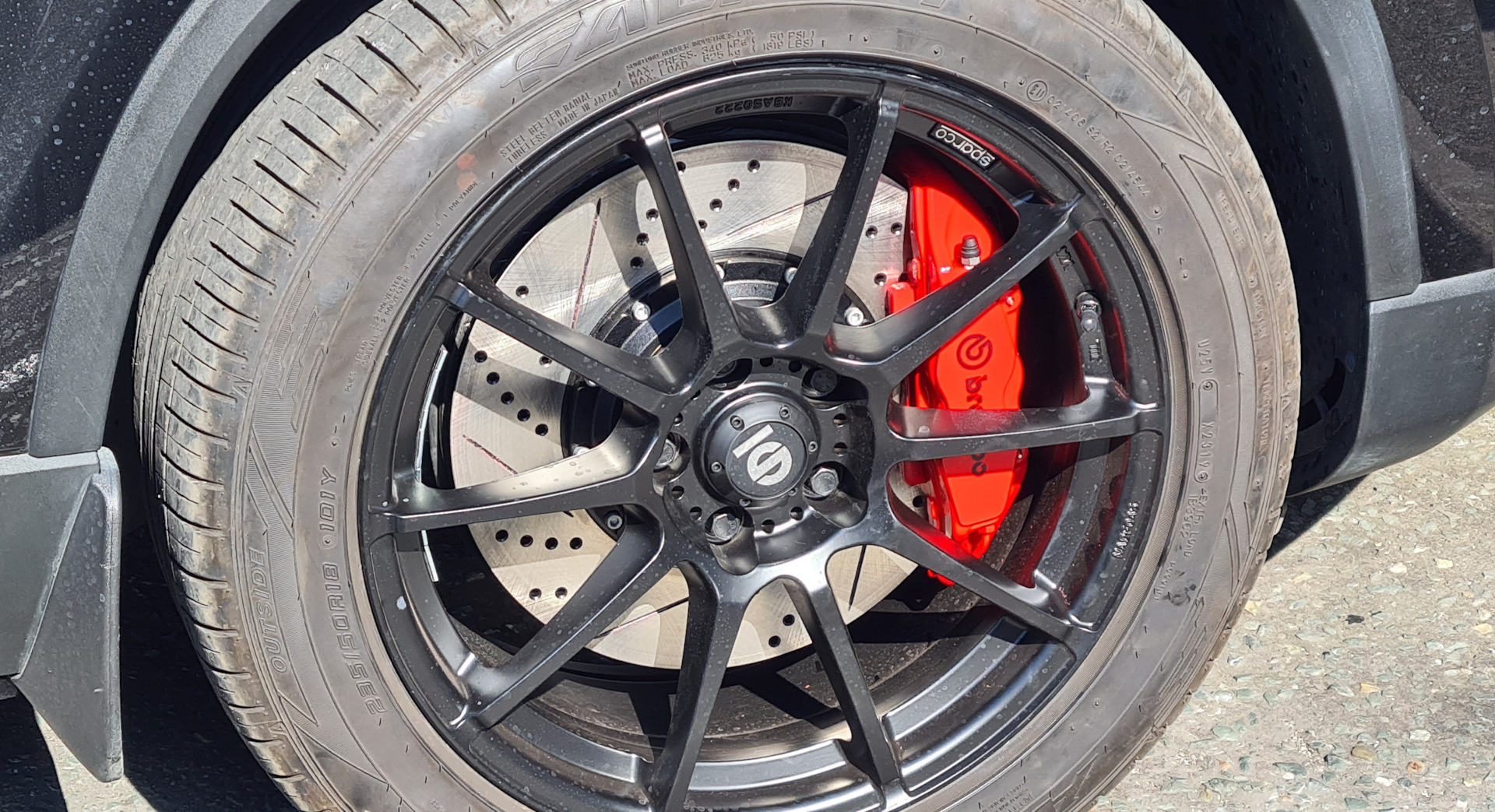

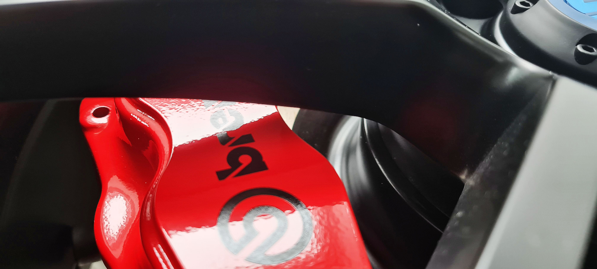

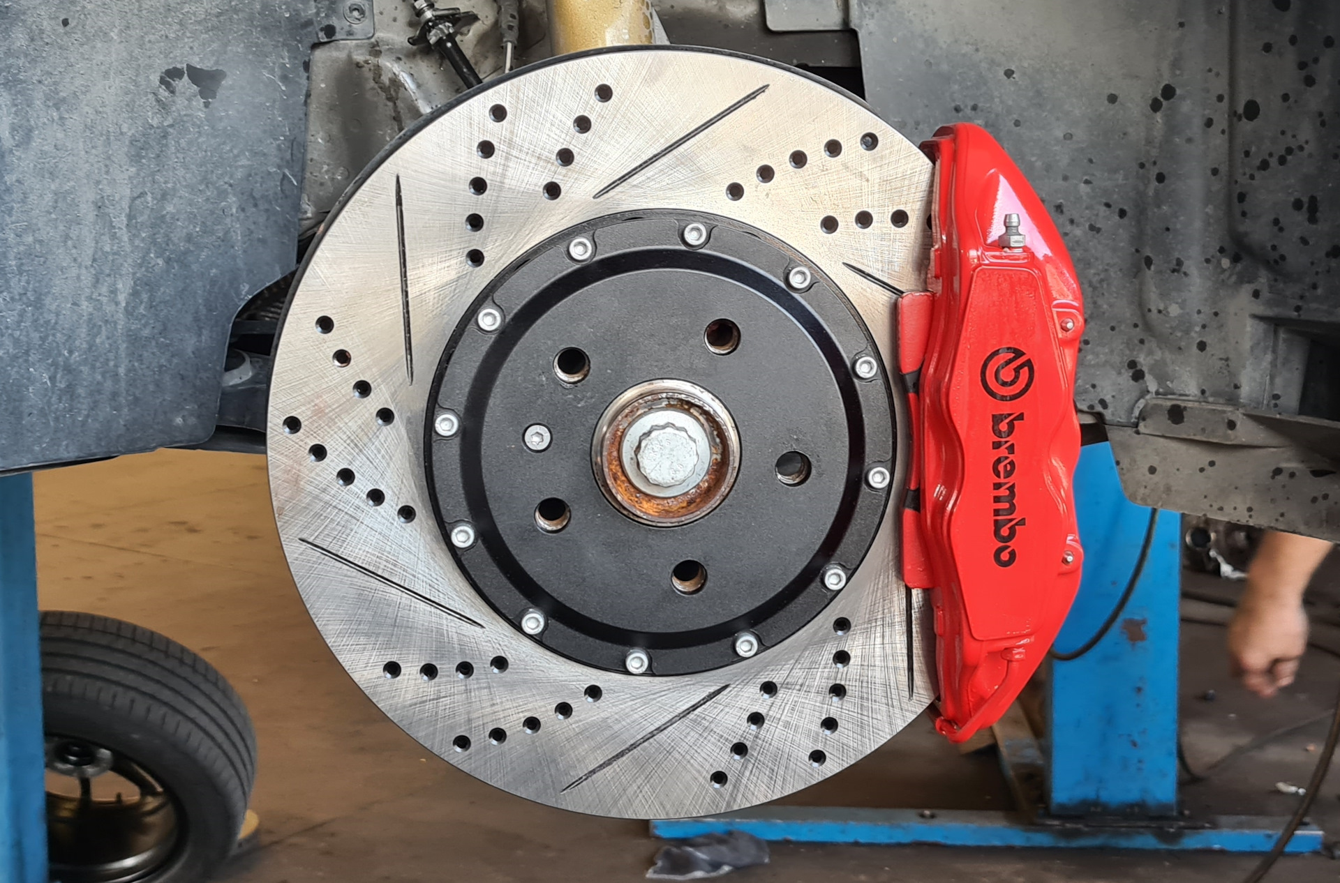

Finally got time to install everything. Here is the result. Sorry , car is not clean yet.
Clearance between wheel and caliper is good huge. Unfortunately there are only two offsets - 35 and 48mm. Mine set is 35 , and I am afraid that 48mm might not work without spacer.

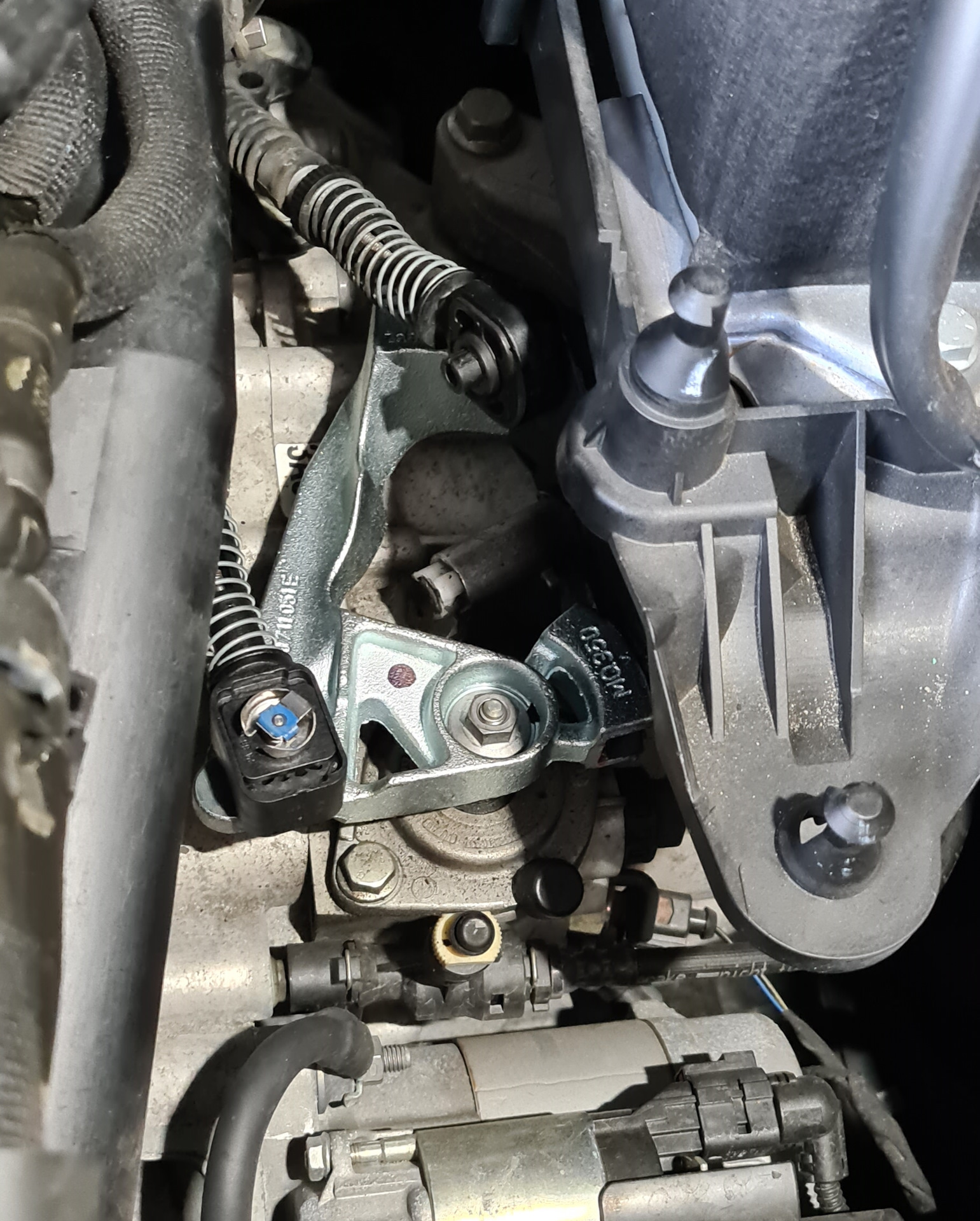

Just not to do double work , I did install short-shifter today as well.
Brakes, even not bedded, working great. Short-shifter allows me to shift gears with fingers only , without need  to move arm from armrest.
