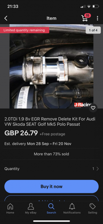

Hi so you can get the egr delete pipe for the fabia vrs 1.9tdi but I’ve seen the shorter delete pipe so you can keep the anti shudder valve, people say you will still get a engine management even with the shudder valve still plugged in then the egr vac pipe would still be connected to the delete pipe. Can some help as really you shouldn’t as everything still connected cheers John
I know it’s probably been repeated but can’t find it cheers
he's got a 1.6TDI not a PD. He made a mistake at the beginning.
