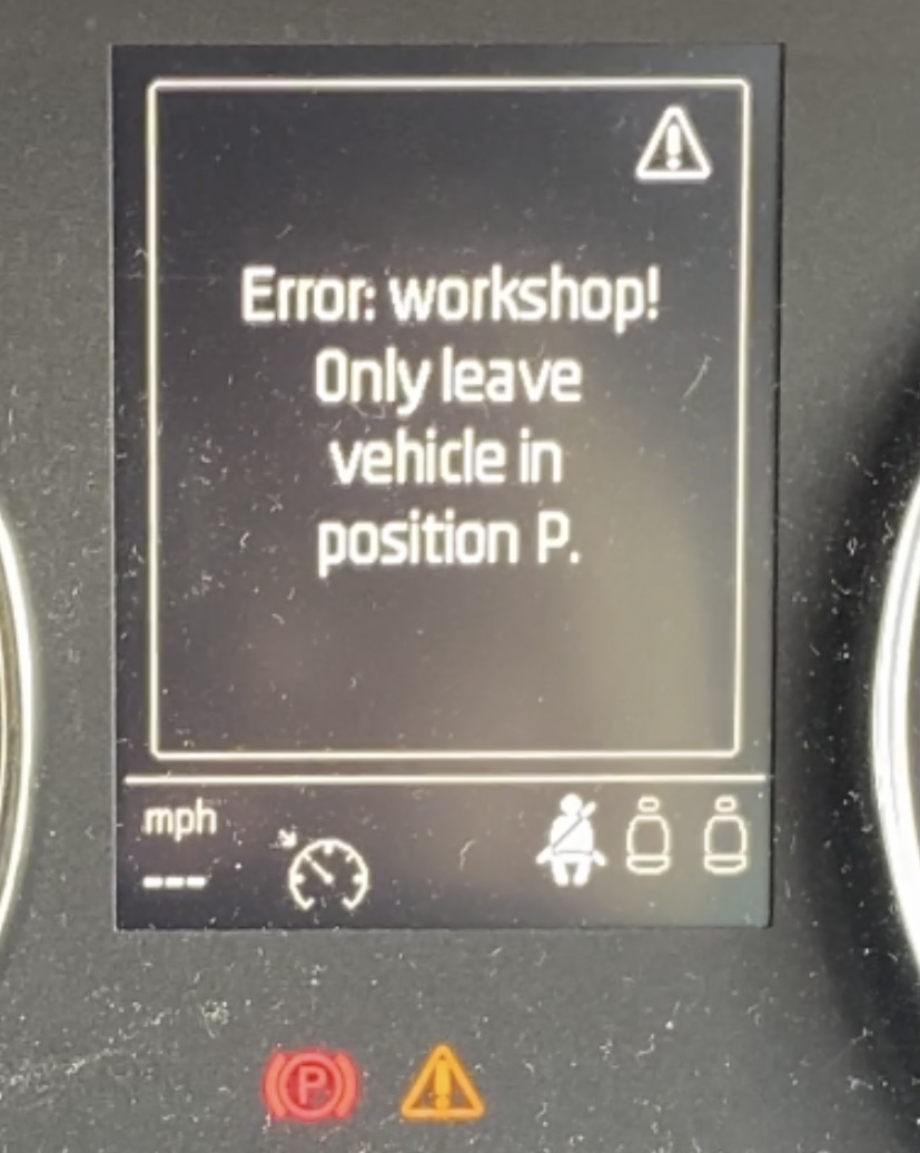

Got the dreaded message below today:
'Error: Workshop! Only leave vehicle in position P'
There are clearly two interpretations of this ,message:
1. The car must be left in P to the exclusion of all other possibilities (ie, don't drive)
2. When leaving the car, you must leave it in P (well, fine, I'll just take that is unnecessary advice)
I've done the usual internet trawl and it seems that this error generally does not indicate an actual  gearbox failure but instead a gearbox selector failure. Basically some switch in the actual selector (gearstick) stops working properly and the car is not 100% confident whether it is in P or not. So, it makes a point of reminding you to leave it in P when you leave the car.
If it is this selector issue I gather the expense is astronomical (obviously, cause it's related to the bl**dy DSG) but do I actually need it fixed? Or, at least do I need to fix it urgently? Sure it's annoying, but as lng as the actual cogs and bearing etc can keep turning without issue, the car is surely drivable.
Anyone been through this particular pantomime before?

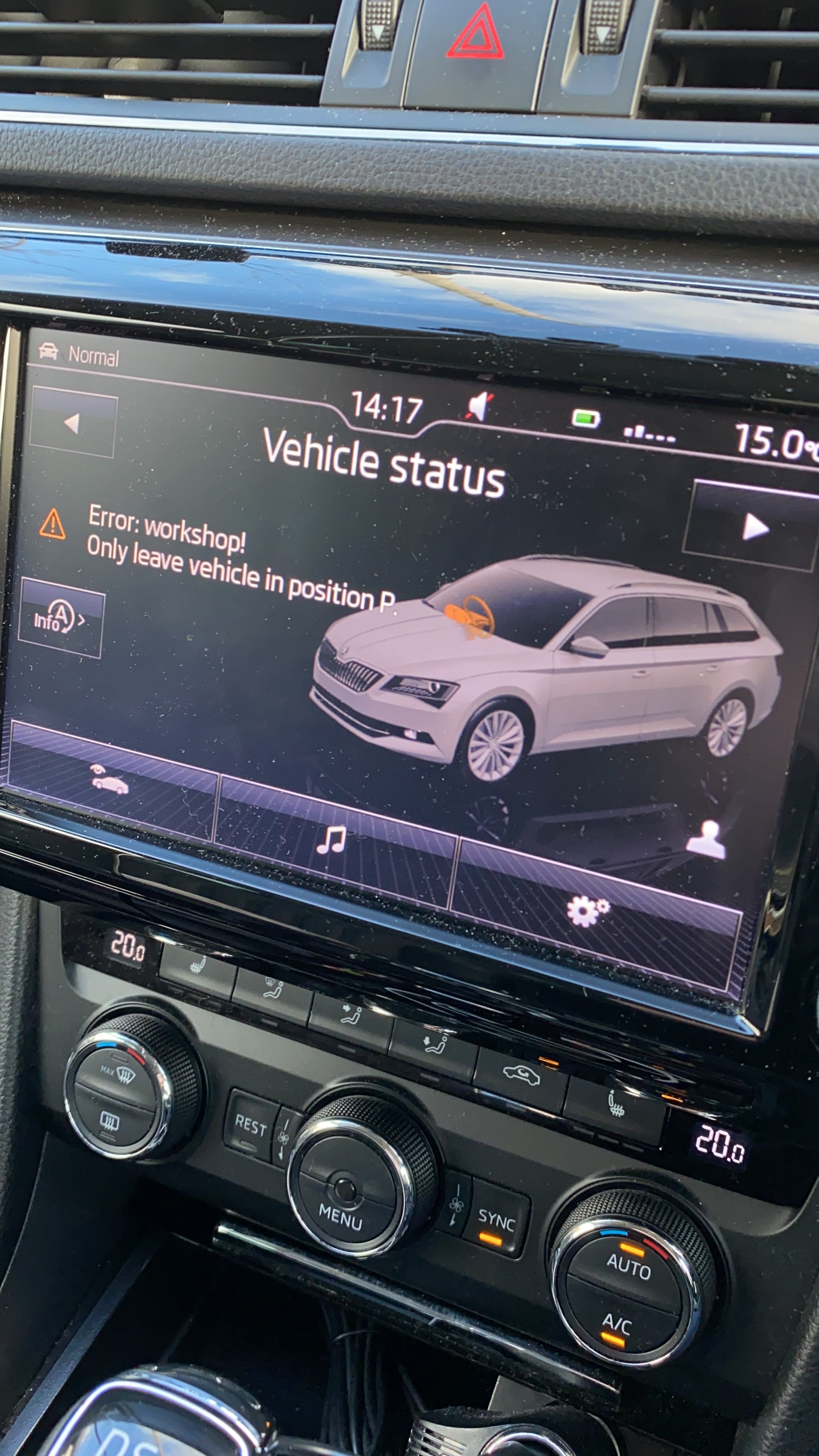

Ok so I had this error once a few weeks ago so quick I only managed see the word workshop before it went
Today it started on my 3rd journey of the day and it was as I started to drive away - it comes on the dash the message and warning triangle and on the screen is this the same as yours

It seems to be every journey tonight I did (home to nursery - nursery to school- school to home) so 3 times and after a few seconds of starting off. Stays in for a bit then disappears after say 1 minute
