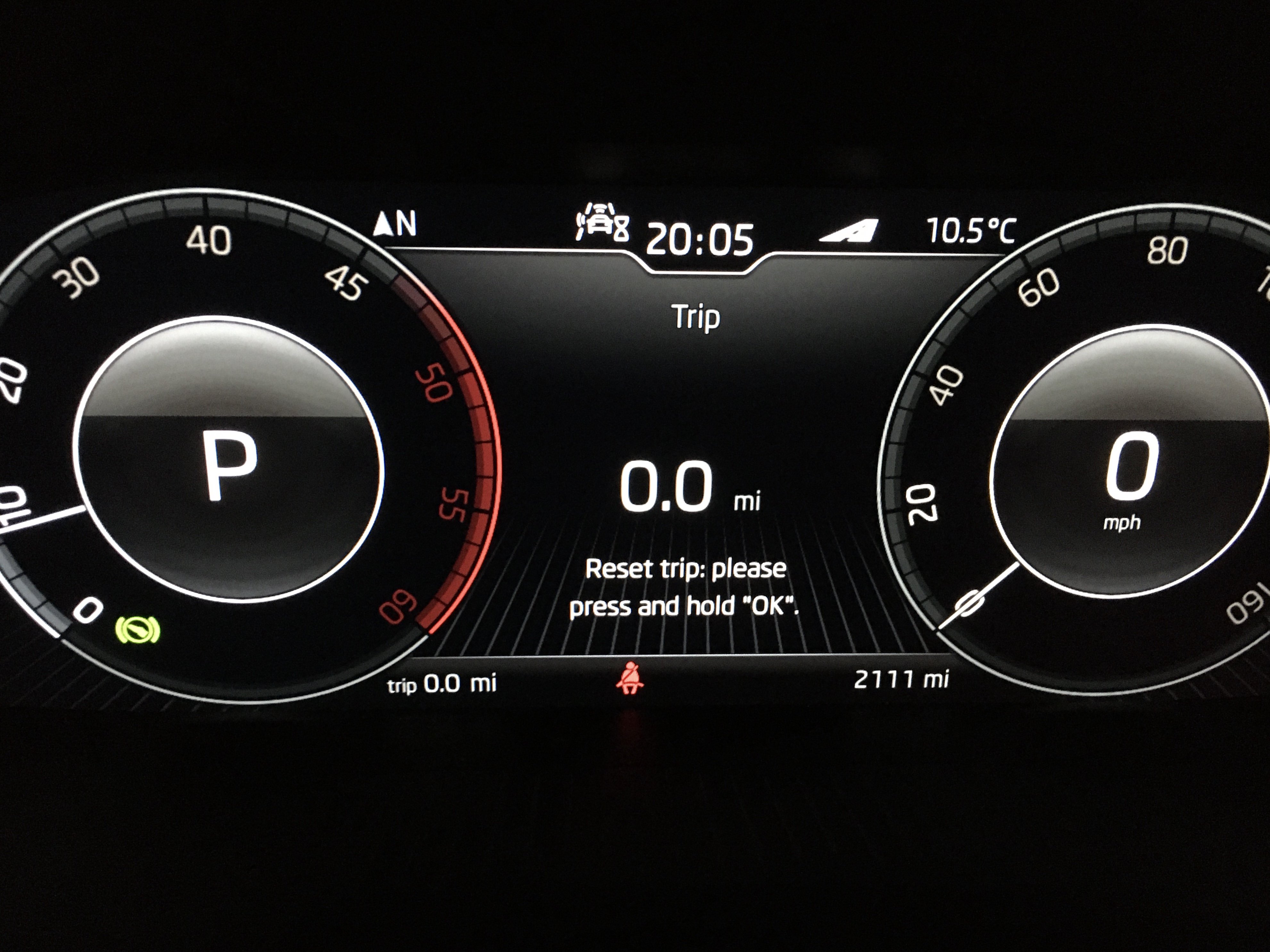

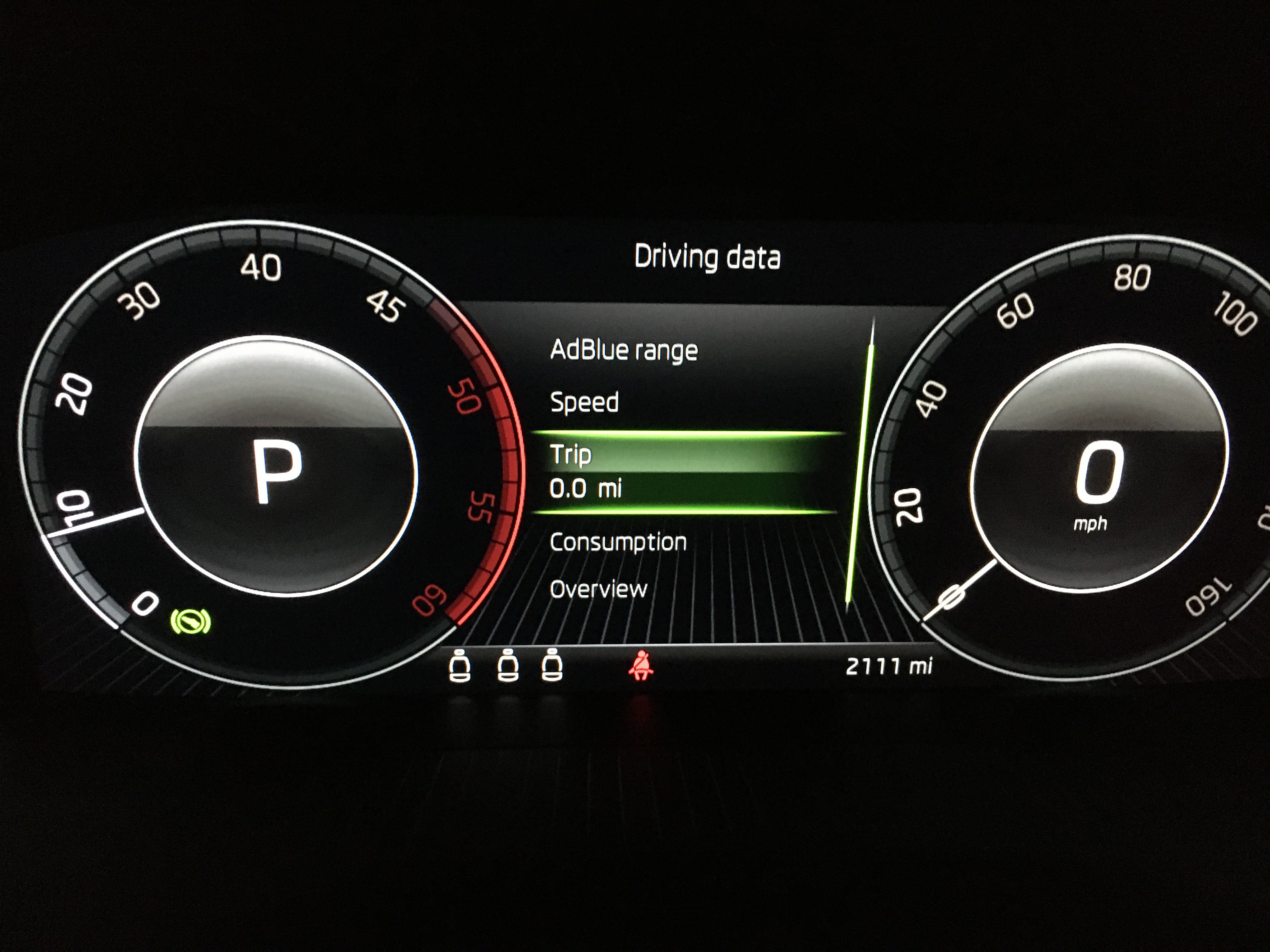

If the dash can show the Single Dial option as per Post 1, then it should be able to show other display options, including the Double Dials with choice of central information, such as driving data.
See 2 pics.
With Pic 1 on show, the trip data is reset to zero by holding down RH wheel button.
I reset Single data fields such as Trip distance almost every day using this technique.
I can’t imagine a Kamiq has a limitation on dash options compared with other VAG virtual cockpits.
