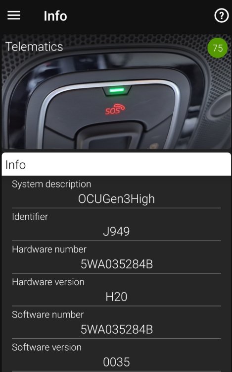

  4. Hi @r0bb10, I purchased an ODBEleven dongle to check my OCU version and to be able to clear the SVM error when I will (maybe) run the software update of the MIB. We talked about OCU in this thread before and checking my version I'm worried that it's very much out of date... See the attached screenshot. Any tips and info you may have to update it ? If not needed I wouldn't touch it though.
