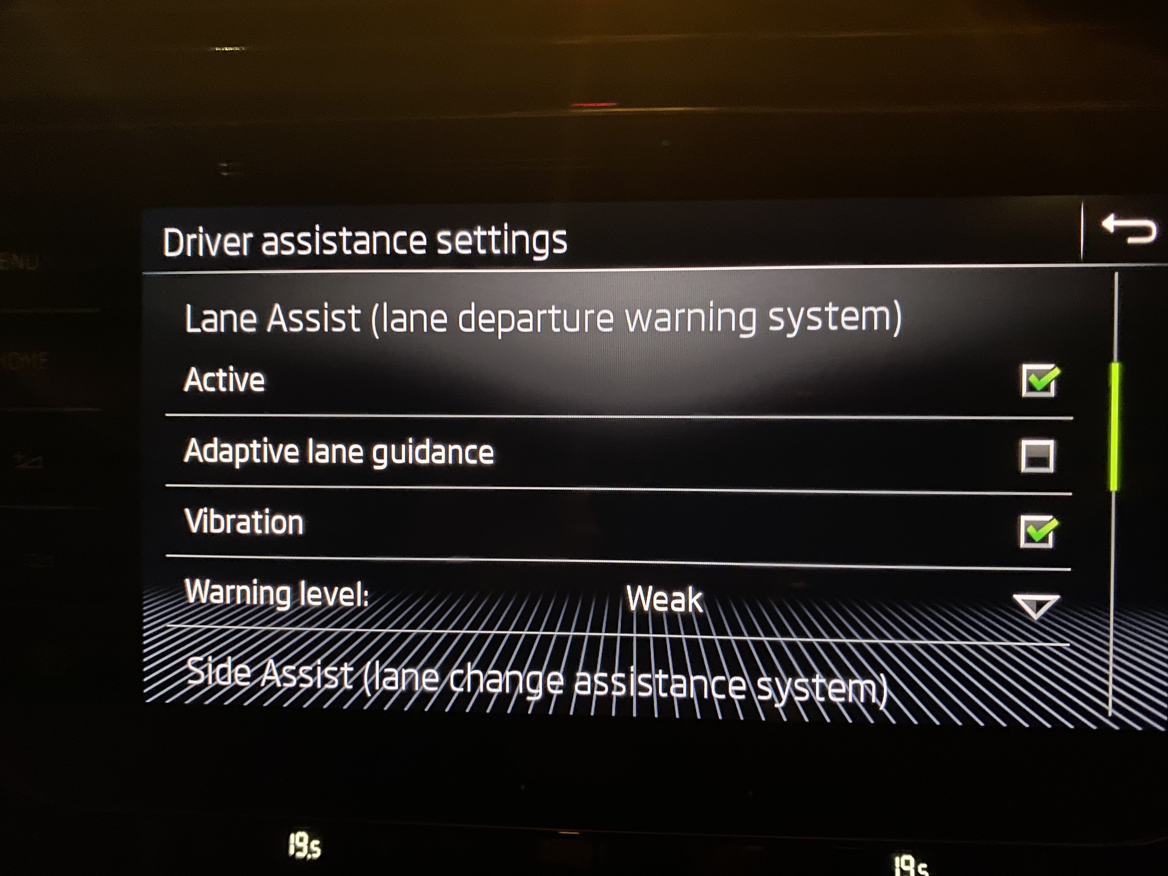

I followed the above and now have the adaptive lane guidance option but when I press it nothing happens. I can’t turn it into an “on” state. Normal lane guidance works fine and came with the car
Any advice would be great!

It seems I have added ALG to my car but this has not automatically enabled TJA. The coloured lanes graphic greys out when my speed drops to below about 40mph.
With ALG set active on a motorway I noticed a slight tendancy for the car to meander a little and not stay dead centre in the lane. I assume this is normal behavior.

That is not my experience on the motorway. I can see the car doing minute adjustments being centre of the lane. If it doesn't pick up the lines or the lines have disappeared, its a different story. The meandering you speak of use to happen when i didn't have the Active / Adaptive part on.
You can activate TJA as well. The only difference between the two is one enables it to work for speeds below 40mph but ONLY if ACC is on.
