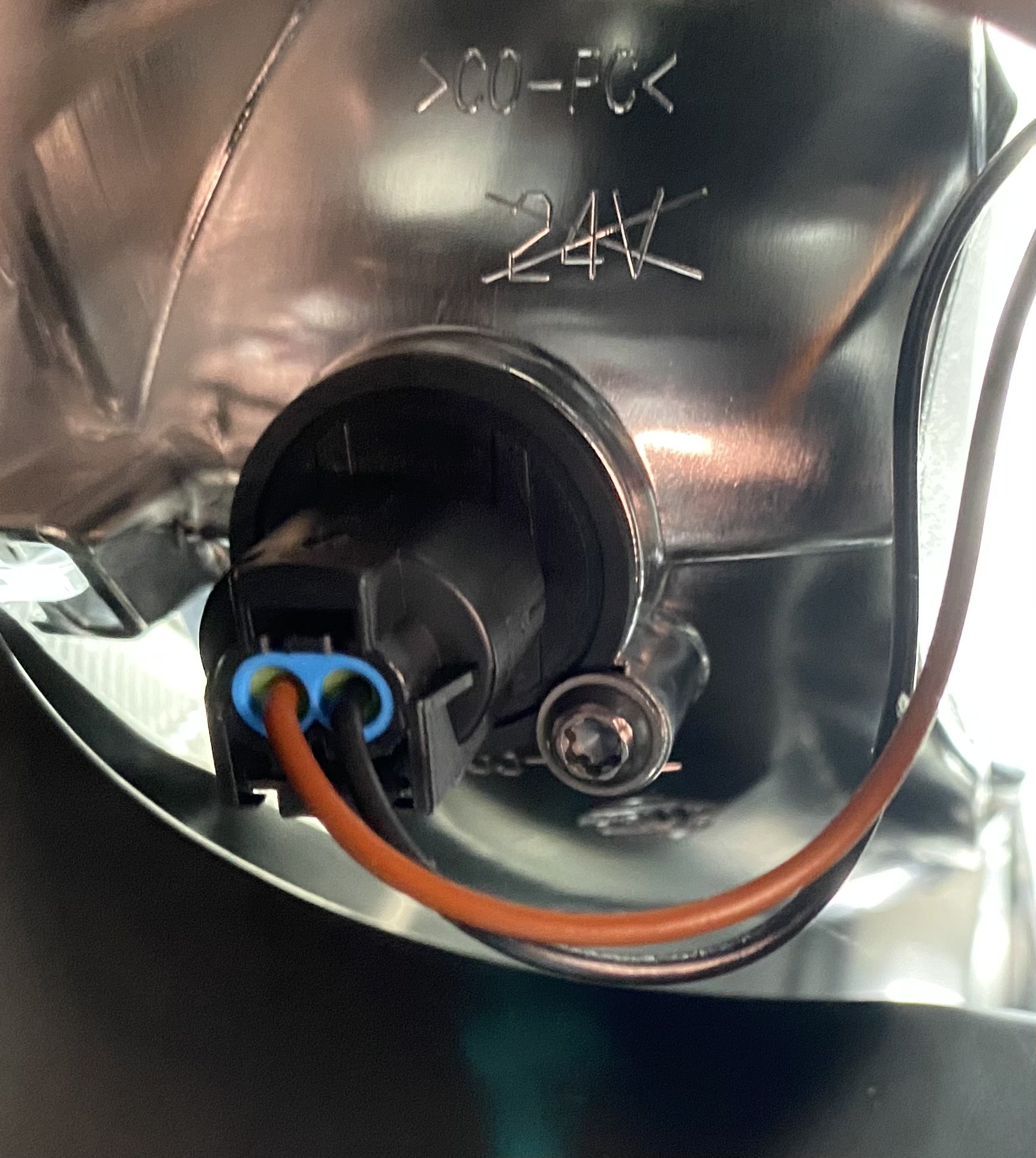

Okay, I went and had a look at the front indicators.
You pull off the circular rubber cover, and underneath this is what you (can’t) see…
The picture is of the left side, and the Torx screw is on the inboard side so reasonably easy to access by feel. Unfortunately the other side is not a mirror image, so the screw is between the bulb fitting and the inner wing on the right hand side.
I managed to get a T20 bit to engage with the screw, so I think that’s the correct size.
As I mentioned, the other thread implied that you only have to loosen the screw, not remove it. But since the black plastic bit is part of the bulb, I can’t immediately imagine how you can remove the bulb without removing the screw entirely - and I imagine it’d be a nightmare to get back in.
When I’m feeling braver I might try and remove it!
Edited by Dr_Mike_Oxgreen
(I made a similar picture with my phone...)
The screw is indeed probably a nightmare to get back in, probably that's why the workshop manual says to access these bulbs via the wheel arch. My front indicator bulbs (still the originals from 2011) still look OK, so I'm going to leave them where they are...
