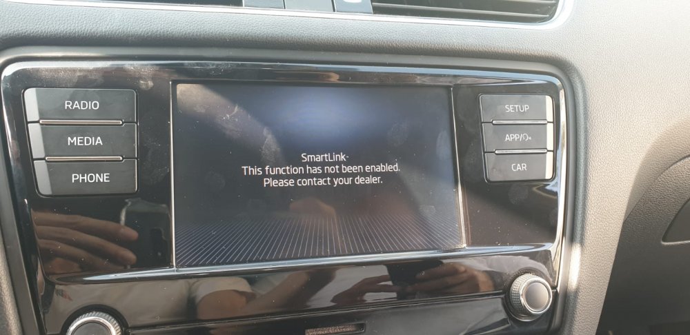

Smart link enable
If it's the same as the VW systems, you need an activation key that is only available from the dealer. They would also enable it.
Having said that, we tried this with our VW Beetle and the dealer said the enabling had failed and couldn't be done with this particular head unit. Even though it has the right buttons and 'App Connect' in the menu!
No - it has to be applied either by the dealer or in theory by yourself.
Oddly enough, you don't have a MENU key, but it you did, you would go and press/hold it and go to Software FeCC - find the part code for Smartlink - then put in your key that the dealer has given you (its on a piece of paper).  Then the feature is enabled.  You cannot enable this function via VCDS.  The other option is that you get hold of a hack MIB system....but that is a whole world of pain.
Sorry - Skoda dealer time I'm afraid.
Pretty sure activation can only be done using ODIS (dealer software).
The smartlink enablement codes need to be added against your VIN on the Skoda servers. Your headunit can then be updated with the new activations.

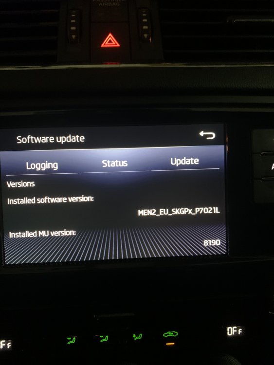

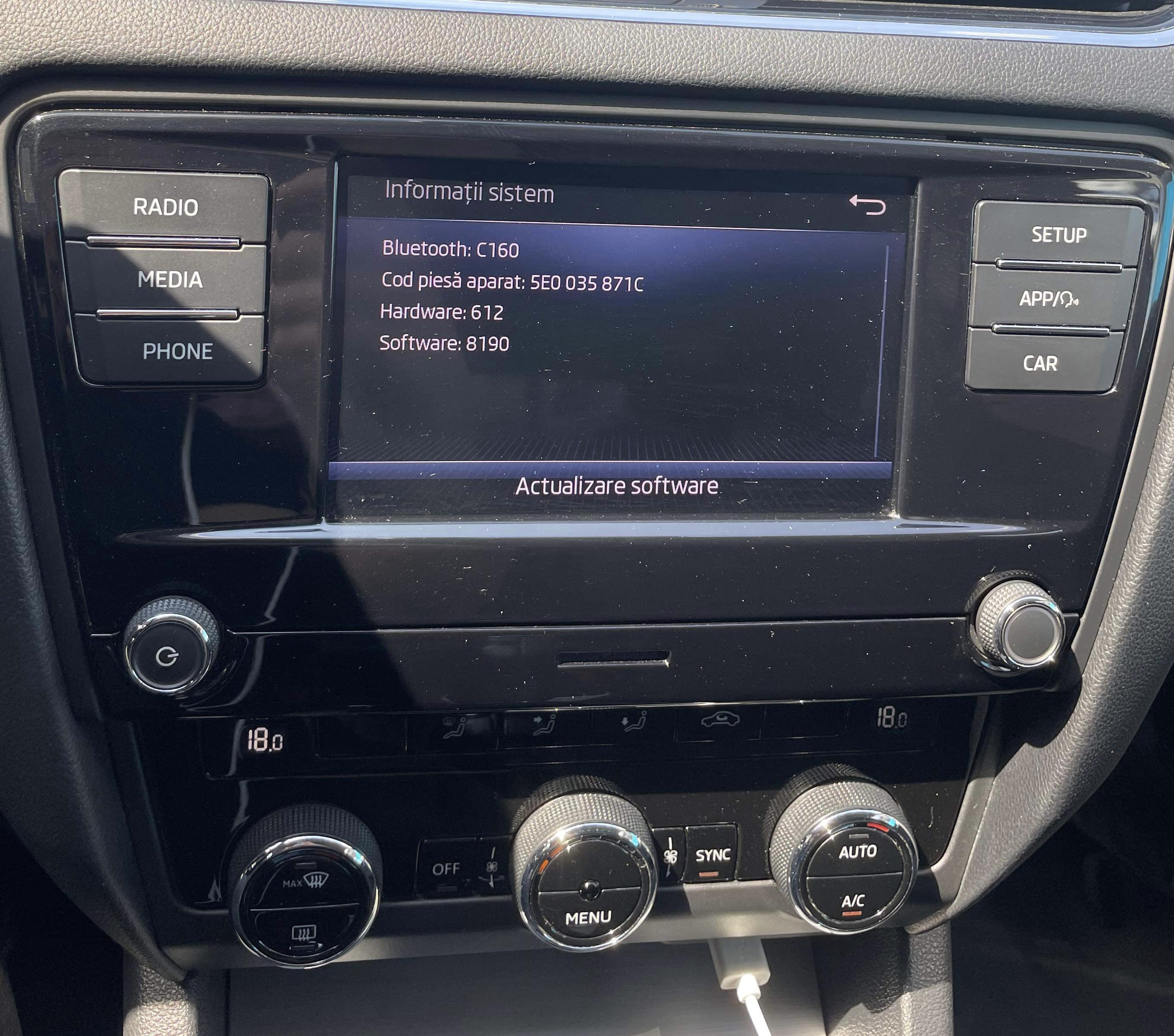

how do i know if i have discover or colombus?
Quote
From a quick search on the internet it seems your unit is a Swing unit so it's neither of them. Therefore, I'd assume the toolbox won't work on your unit.
fun...
so i have no choice to do it on the dealer...
274€ 🤦
