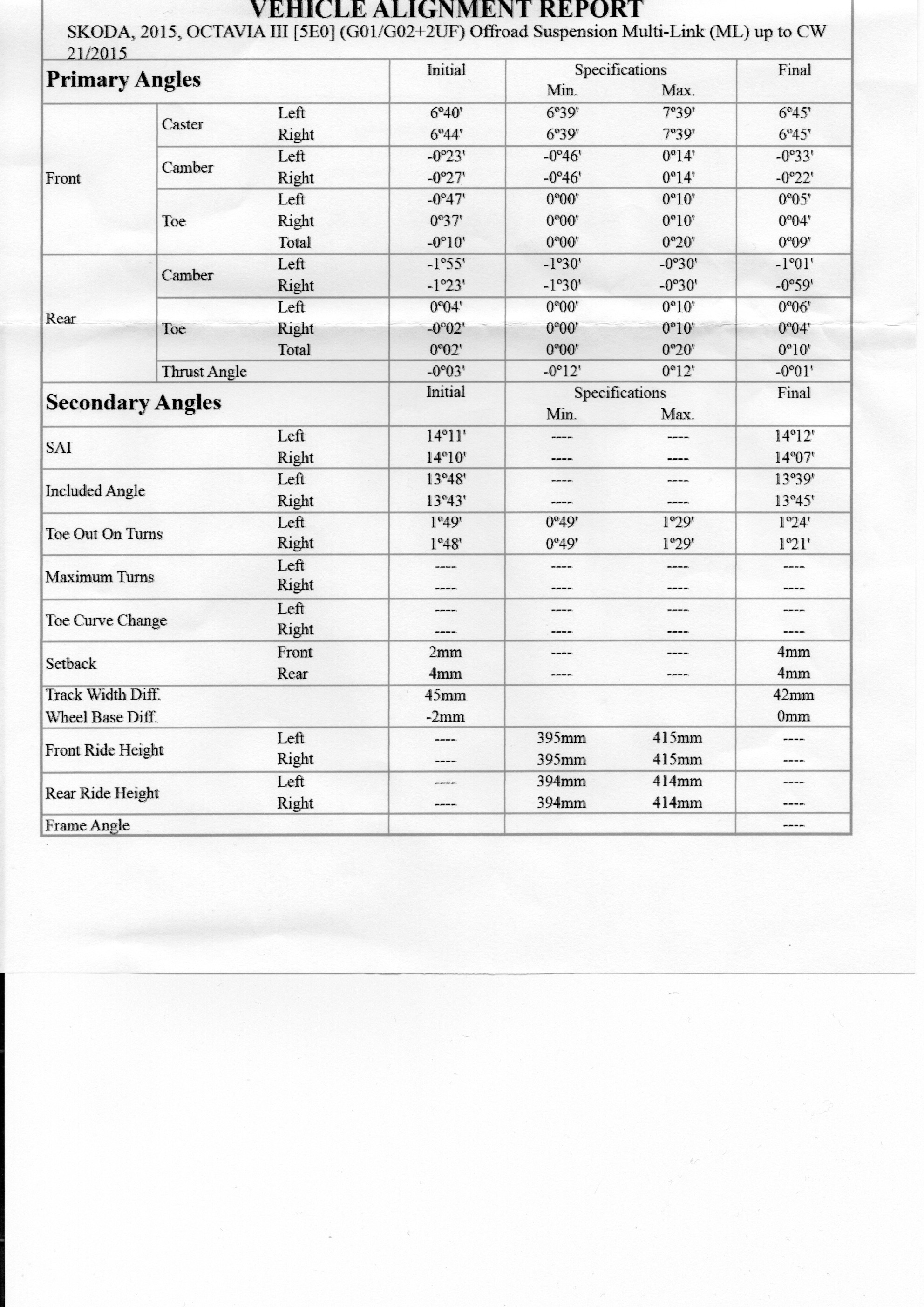

Don't know if this may help; independent alignment in Dec 2020 on my Scout 2015. I try to get my cars done very year as I tow, and drive on some sh*te roads.
