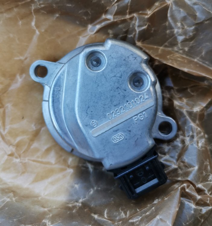

I've got a Bosch one (would have preferred genuine but couldn't find one quick enough) on click and collect from ECP, should be ready Tuesday morning - watched a video, should be a quick job (give swmbo a chance to wield her spanners again).
Picked the sensor up this morning, swmbo had it fitted in 10 mins..
EML out, car starts and runs lovely again.

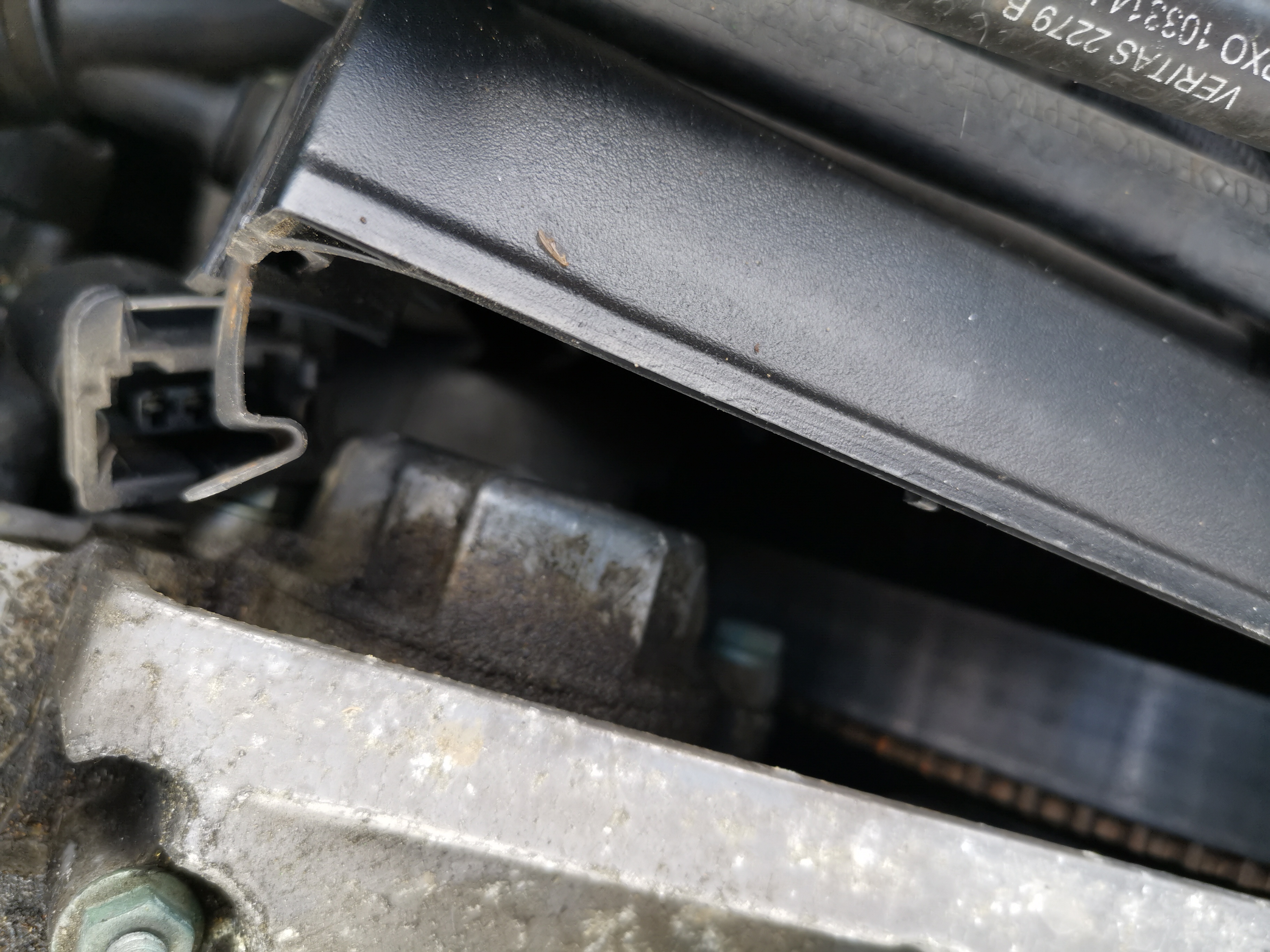

Tried to get some numbers from VCDS but couldn't find the relevant group.
Car starts and runs fine, not even a hint of a misfire, have visually checked all wiring and connections and they look good too..
**edit**
There's 2 codes for O2 sensors (I twisted the exhaust and now it's blowing, just cba to get under there right now - swmbo wants a new cat back anyway), could this be related since, I believe (from googling numerous VAG sites), that the cam sensor and emissions are linked?
