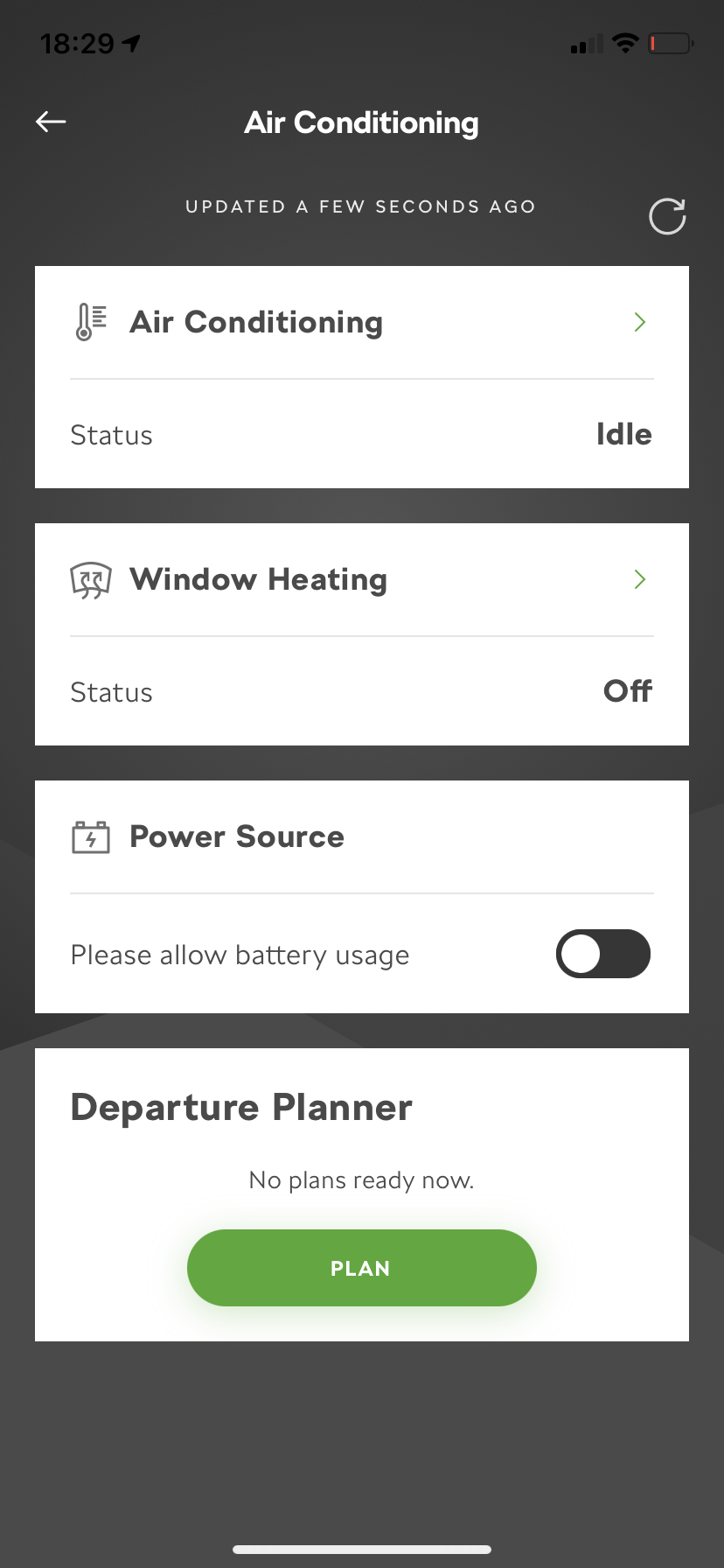

Did you have the option in the app "allow to use battery" (or something like that) in the pre-heating options? maybe it was only taking from the cable and that explain why it was weak.

mm, that explain things. If you set "Please allow battery usage" to ON (green) the heater should be strong enough (by what I have read so far).
Still it  will eat the battery and I have seen a lot of people complaining about error in the app, as you have mentioned. I hope they have fixed when I receive the car.

Yes, that most likely explains my issues with electric pre-heating. I just did not use it enough to actually figure this out :) I'm gonna rephrase my opinion on the aux heater:
If you need pre-heating only when charging the battery, then aux heater is not worth the cost. But if you want to pre-heat also when charging is not possible (traveling, etc), then definitely aux heater is worth the cost.
