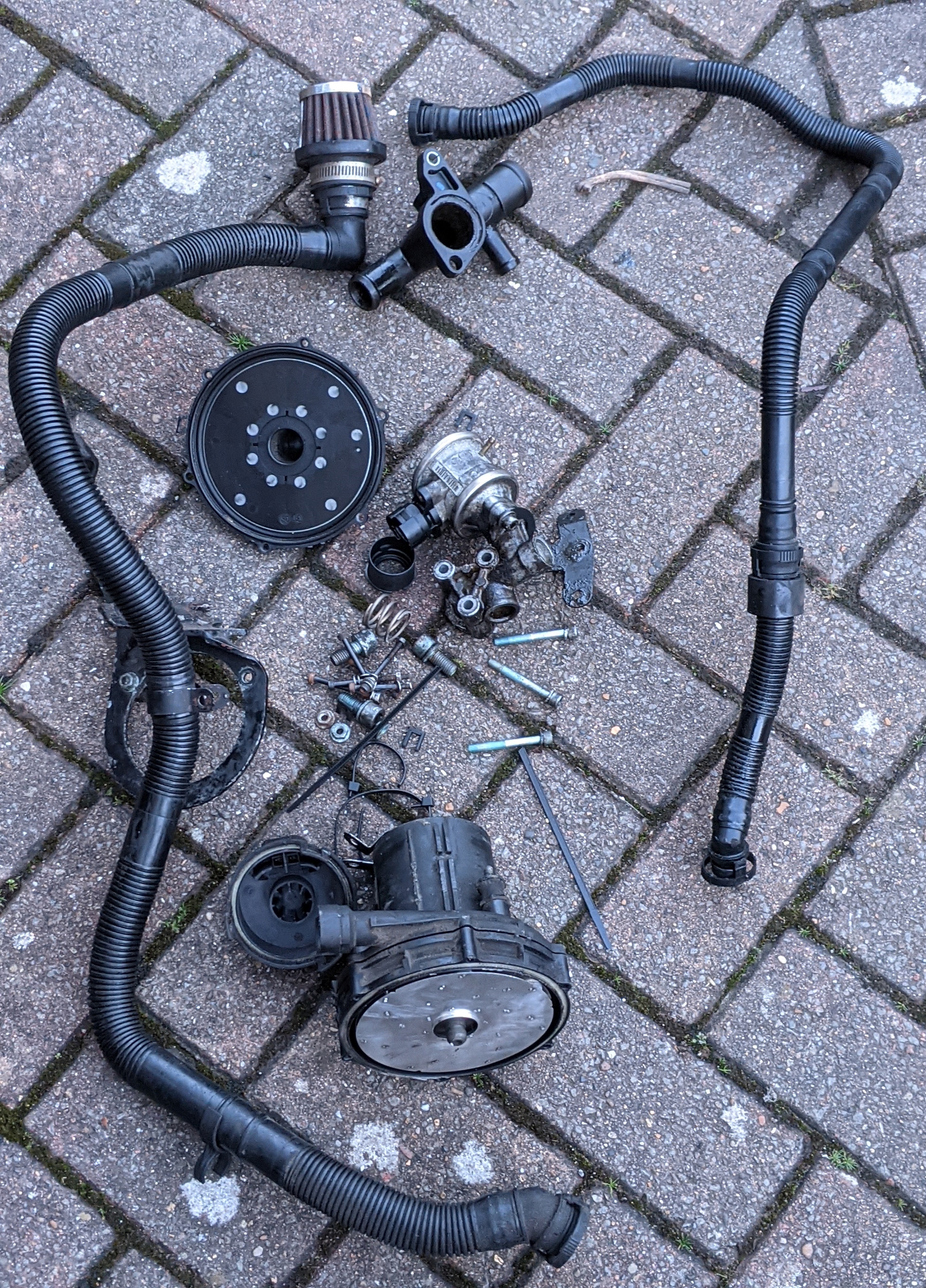

I've attached a photo of all the SAI bits on the drive after they came off the car.

That's a lot of hardware binned!!
Do like the idea of gaining space (and deleting unnecessary gubbins)
