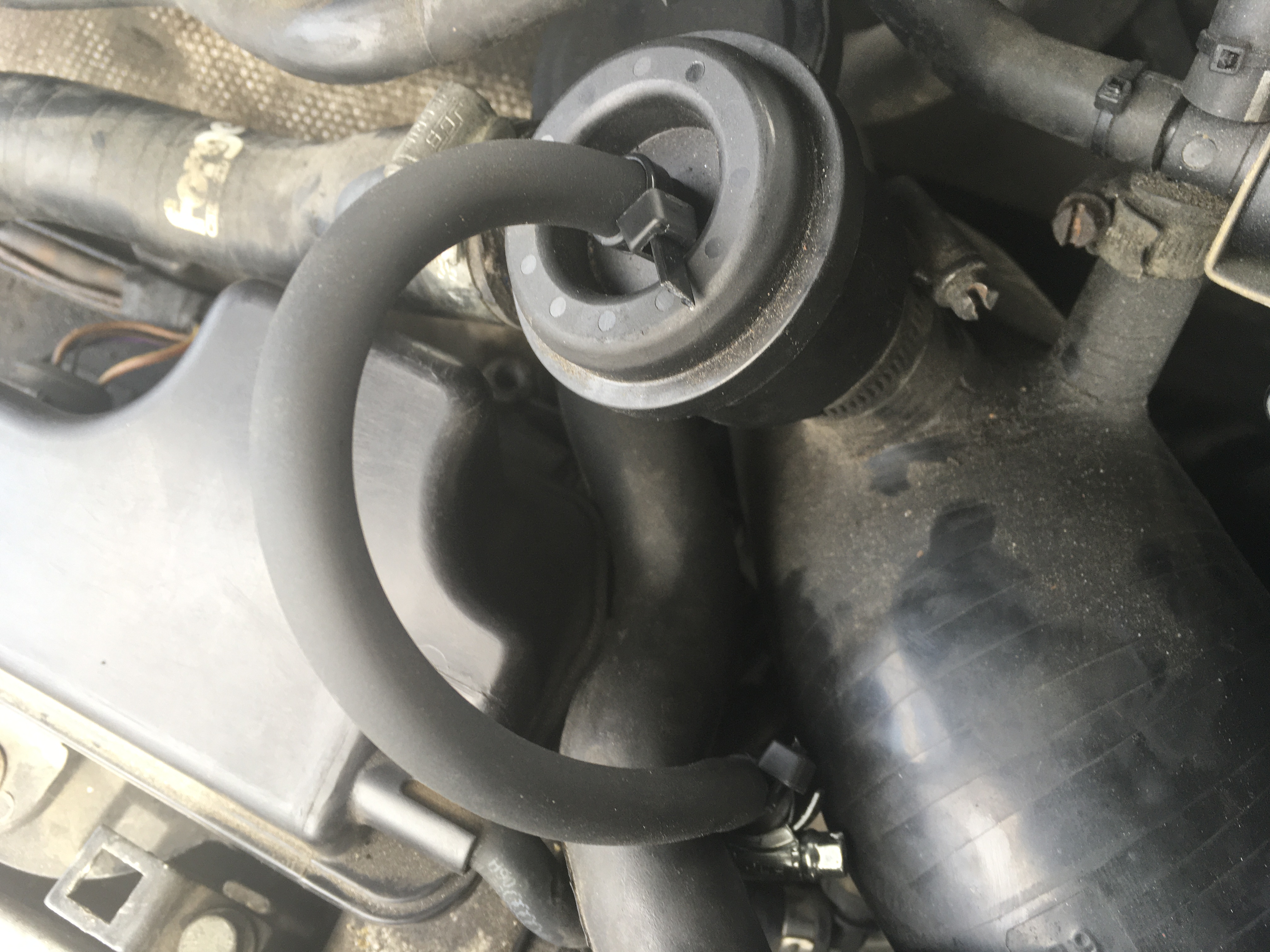

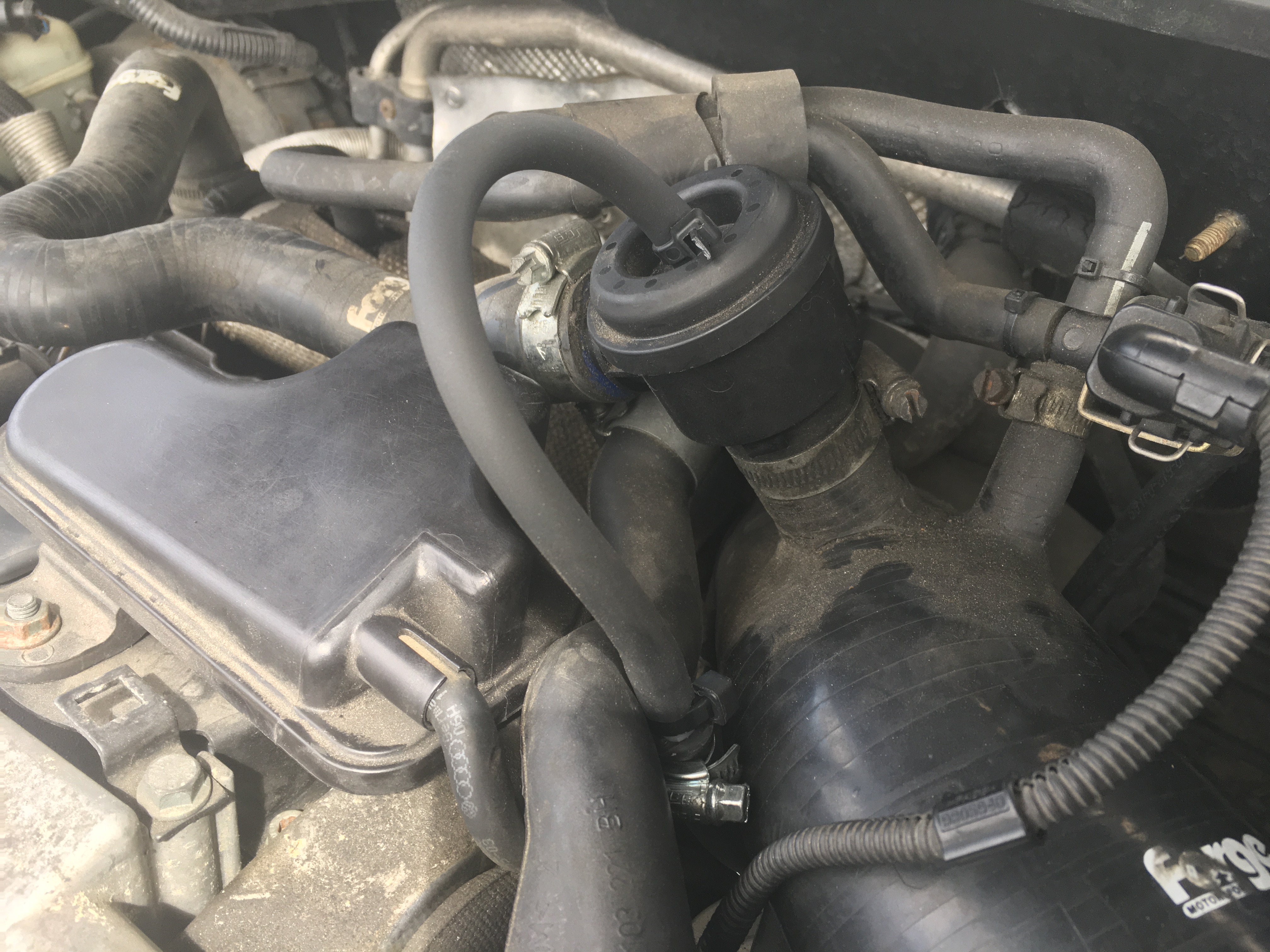

Just a small update. I reset the codes and drove the car. Within 20 miles the same 2 codes came up again:
17608 turbocharger recir valve mechanical malfunction
16795 sec air in system incorrect air flow
now i had a look to see if there was a split pipe and low and behold there is. The little pipe from the top of the DV to the Combi valve has split big time and needs replaced. I was going to delete the system anyway but i need the car back ASAP. And i dont want to drive the car with no vacuum hose connected to the top of the DV. I went to Halfords and bought 3.2mm vacuum hose and 5.0mm vacuum hose and neither fit over the combi valve. Can anyone tell me the part number for the little hose that connects the DV to the combi? Or what thickness hose i could use to go over the combi valve? My issue is that if i buy a 8mm inner diameter hose to go over the combi then it’ll be too big to be properly secured on the DV which is approx 4mm
Many thanks in advance
Edited by octaviavrs170
Managed to do a wee temporary repair by using a 6mm plastic connector and squeezing it onto the new 5mm vacuum hose. I used the original broken hose and shortened it to fit the combi unit in the original way and then using metal clips to secure it at all the connecting areas.
Will speak to Murray Skoda in Plymouth tomorrow order a new hose. I was going to delete the n249 n112 and sai systems but at the moment i need my car as on call for work.

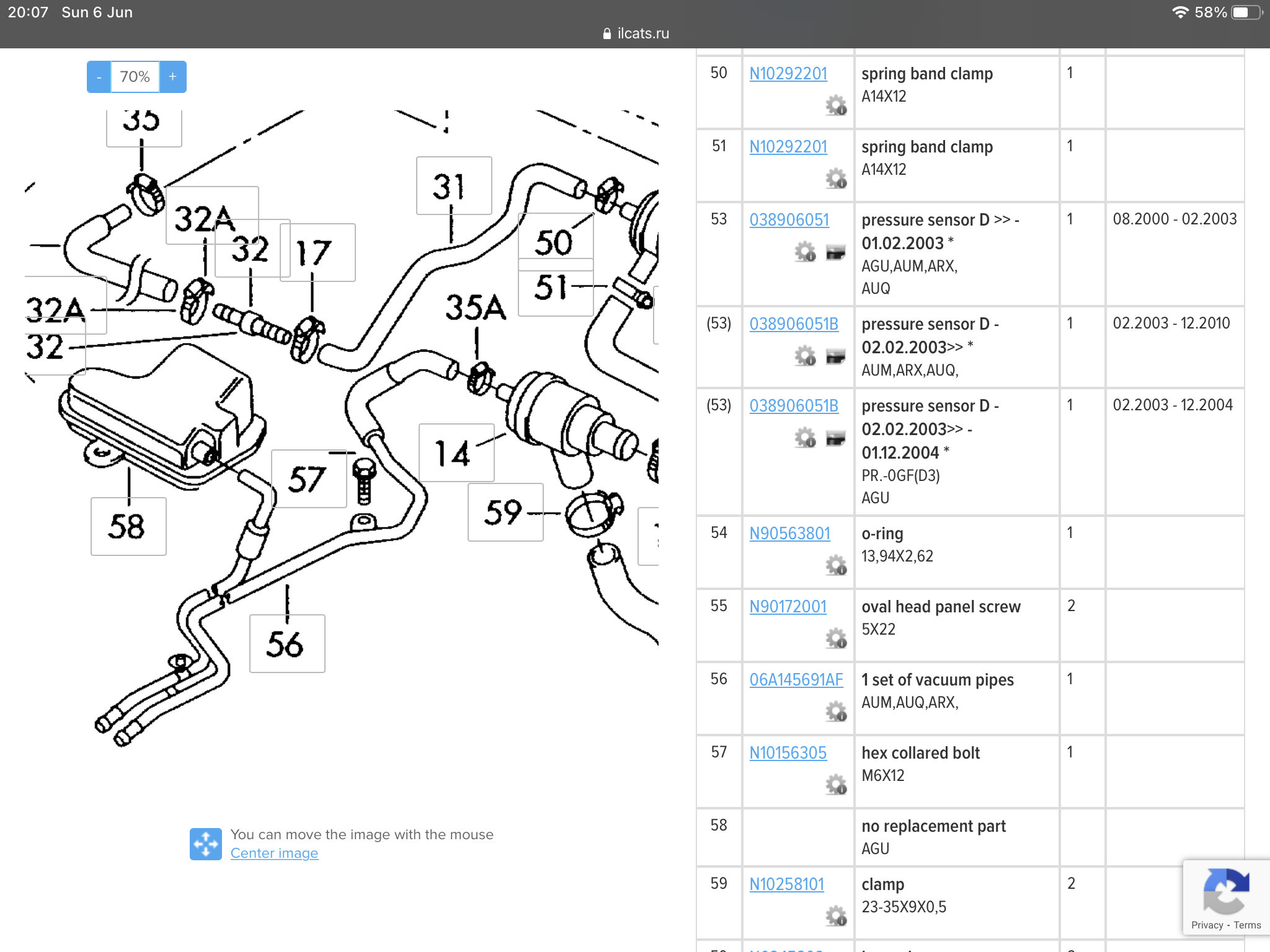

If anyone can find out the part number for the hose that goes from the top of the DV to the combi unit that would be great as it would save me trying to explain the part over the phone.
I'm 99% certain the number you need is 06A145691AF, but be warned, they are part of a set and are about £100. :sadsmile:

I’m assuming you mean that i need item no 56.... 1 set of vacuum pipes?
Well gave Skoda a call this morning to be told that they can’t sell the hose separate from the rest of the vacuum system and i need to buy the whole set of pipes...... £181!!!!!!!!!! :angry:

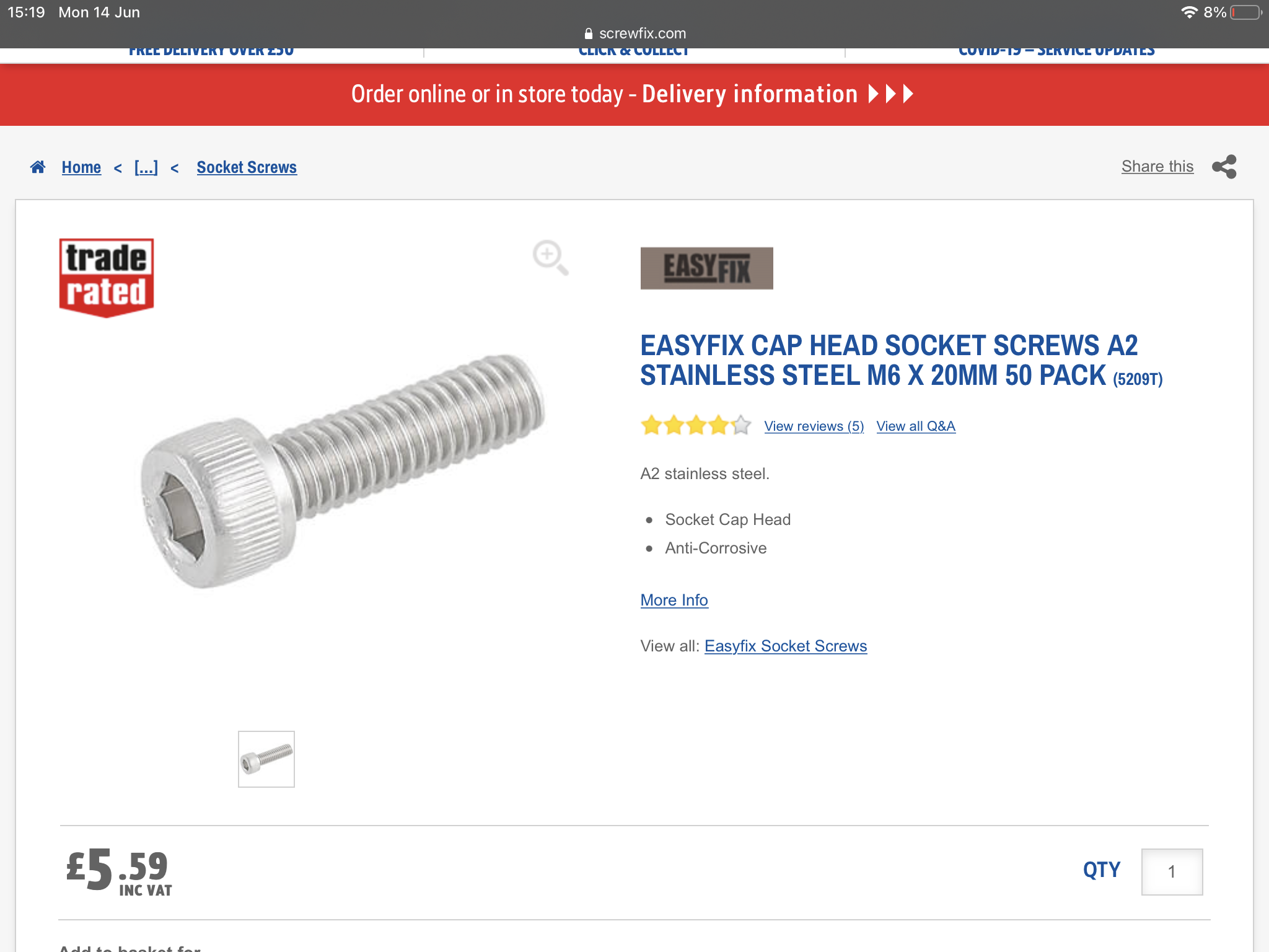

Ive been looking about for a replacement bolt for the ABS sensors. What’s the opinion on this from screwfix?
They look ok, just check the allen head is well formed, as it may not be an issue now when you fit them, but if the head is shallow, that will be a real pain in a few months if you have to remove them again for some reason.

I’ve ordered the m6x20mm for the sake of £5.59. If its a no no then I’ve only lost a fiver compared to much more.
