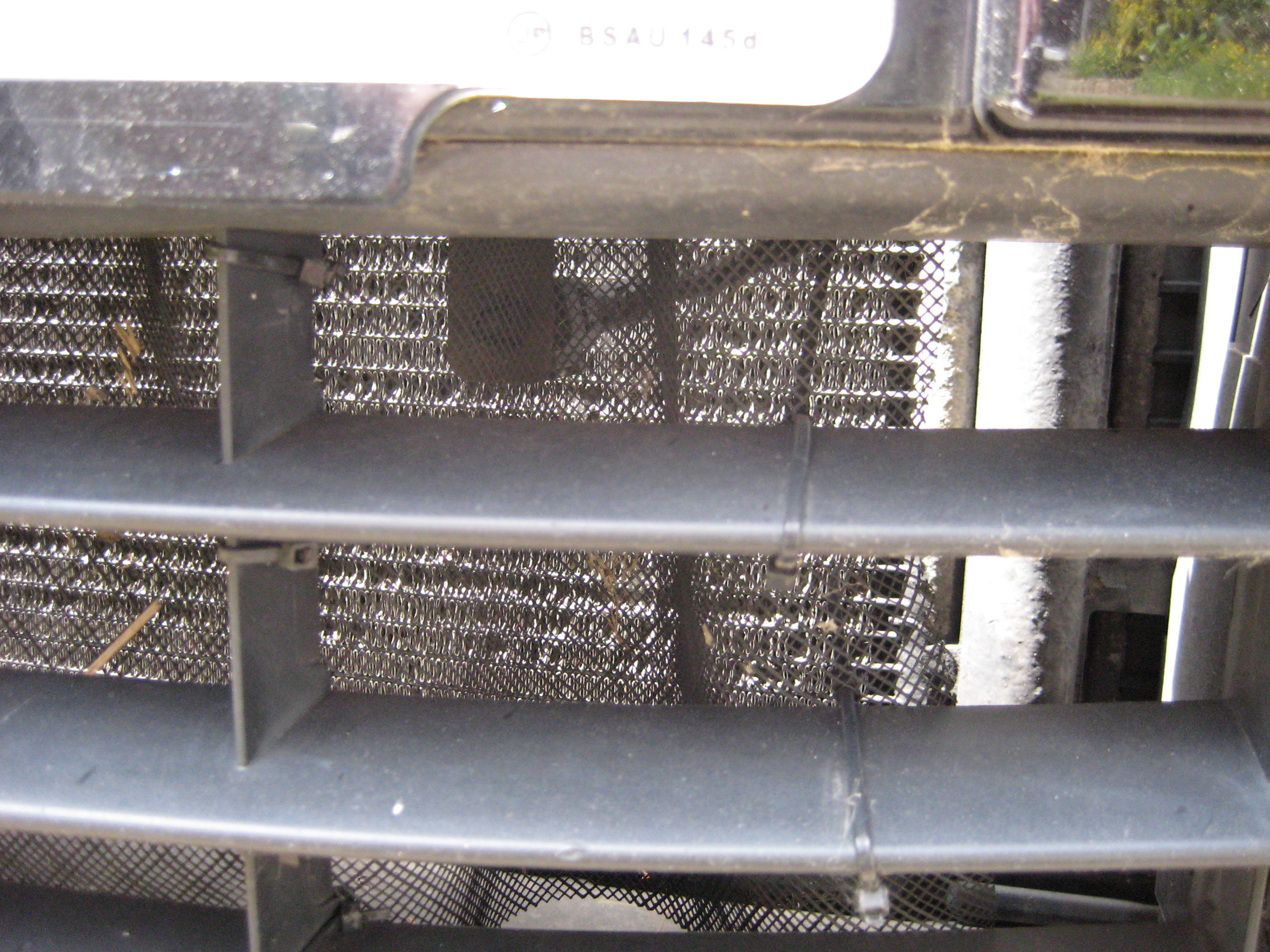

While your at it, consider putting mesh over the air input slats to stop stones hitting the condenser. When I did mine I found many small stones and bigger bits of concrete on the top of the bumper below the condenser.
Full details with photos and link to mesh were in many posts around 2015.
When completed, you will not notice the mesh unless you look for it.
I tried to find my posts on plastic mesh but it seems the links and photos no longer work.
So I took a photo.
It shows a view through the lower grill. You can see the unobtrusive small black tie wraps used to hold the mesh in place and on the right and lower part of the photo you can the mesh size. It lets through about 90% of the air. No need to add protection to the top grill as stones rarely reach the condenser.
 The lower part is the same now as when I installed it at ~30k miles ago; and no bent fins!
I believe the mesh net was sold for outdoor fish pond or garden use but I could not find the one I used.
However, I was surprised how many people sell protector net for car condensers now- including Skoda.
I would not buy the Skoda one as it sits tight up against the fins and I am not sure it would work with the bits of concrete I initially found. Do a search
