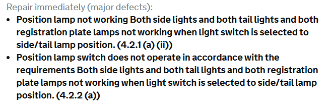

Mk mk2 vRS just failed it's MOT on the side and tail lights. After looking at previous posts it sounded like it was an incorrect fail due to the side lights just being dummy lights but I no longer think that is the case.

Any advice would be greatly appreciated! At the moment I believe the issue resulting in a failed MOT is that on the side light setting there is no DRL and rear number plate light illuminated.
