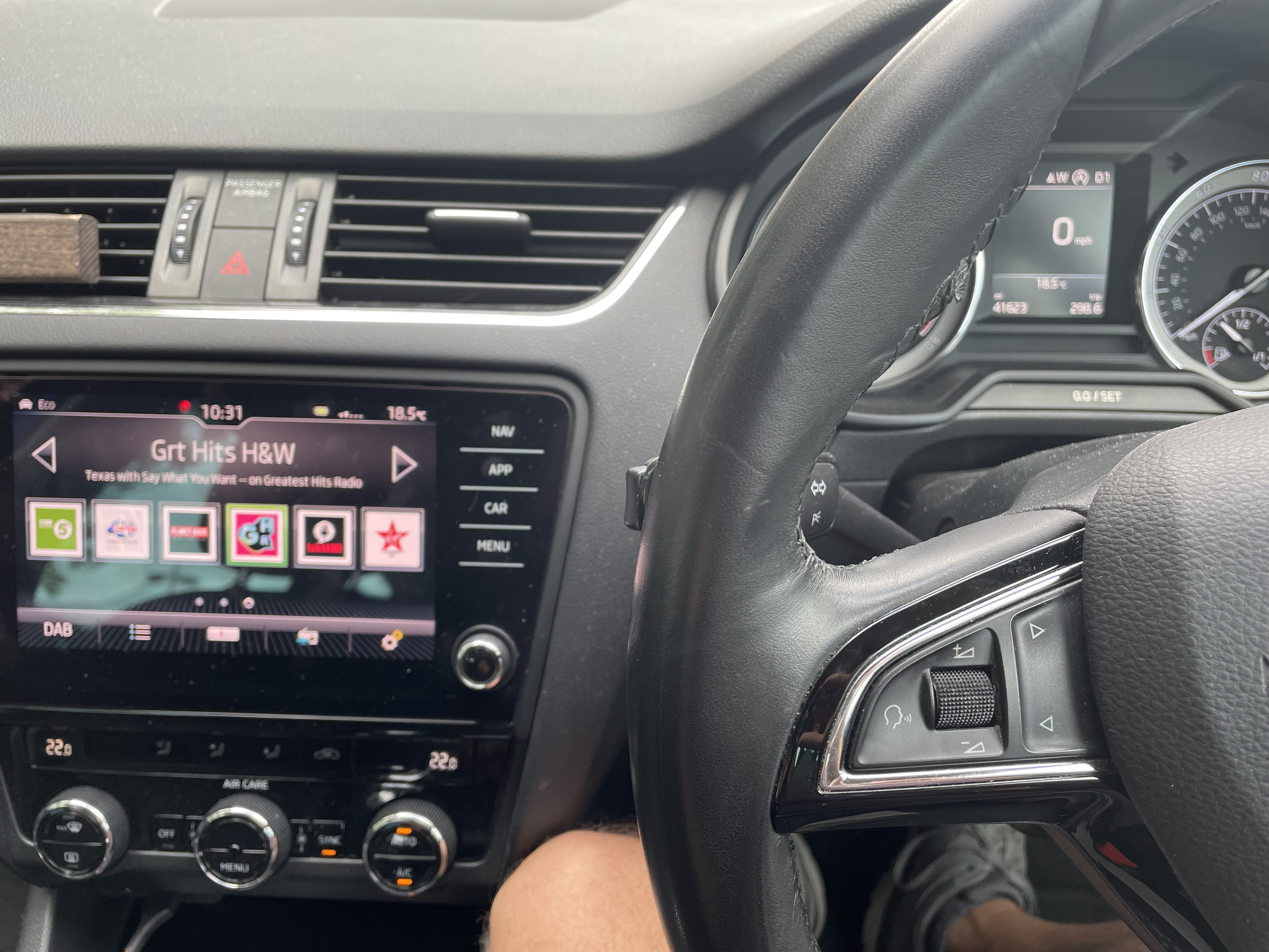

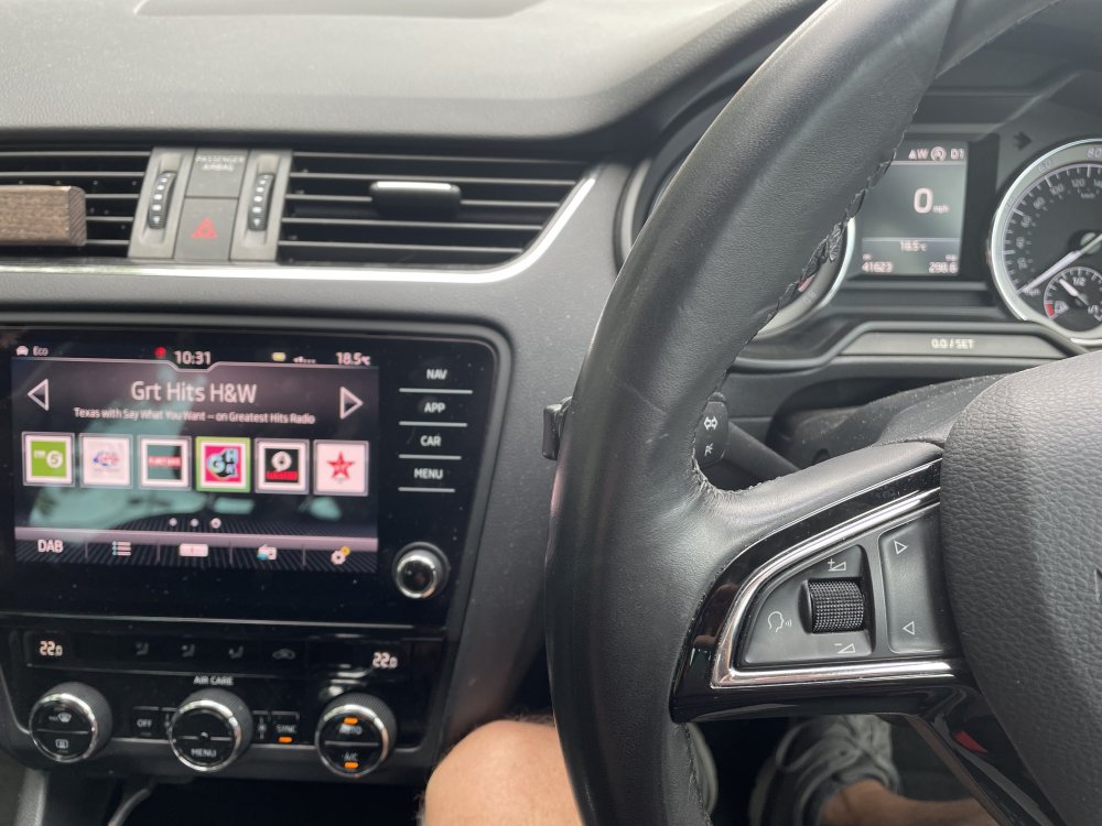

I've also had a strange situation where the information on the head unit is different from the Maxidot display. I rarely go in to Eco-Mode, but decided to switch to it last week. The Head unit shows Eco, the button on the console is orange as it does when in Eco or Sport, but the maxi dot display says D and not E. It appears that although 2 elements were showing that I was in eco-mode against the maxidot display saying otherwise, the car was not in eco-mode at all. This I could tell as the car did not display coasting when no throttle applied.
Sorry for the appalling photo, but you can see the head unit showing Eco and the Maxidot displaying D and not E against the gear.
