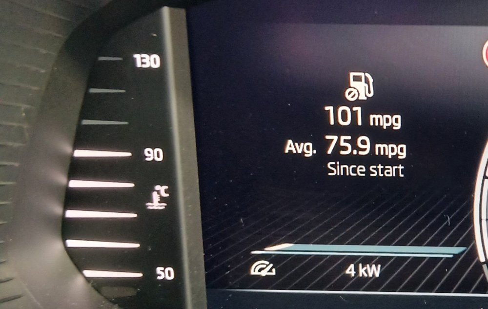

Impressibe MPG
Skoda Scala 1.0TSI (110 bhp) 6 speed manual Whilst I fully accept that MPG data is NOT fully accurate from the dash screen, nevertheless I was significantly impressed to have achieved the below figure whilst on a 40 mile journey this past week. Roads were mostly dual carriageway and speed kept to around 55mph. Anyone else achieved something similar or even better ??
