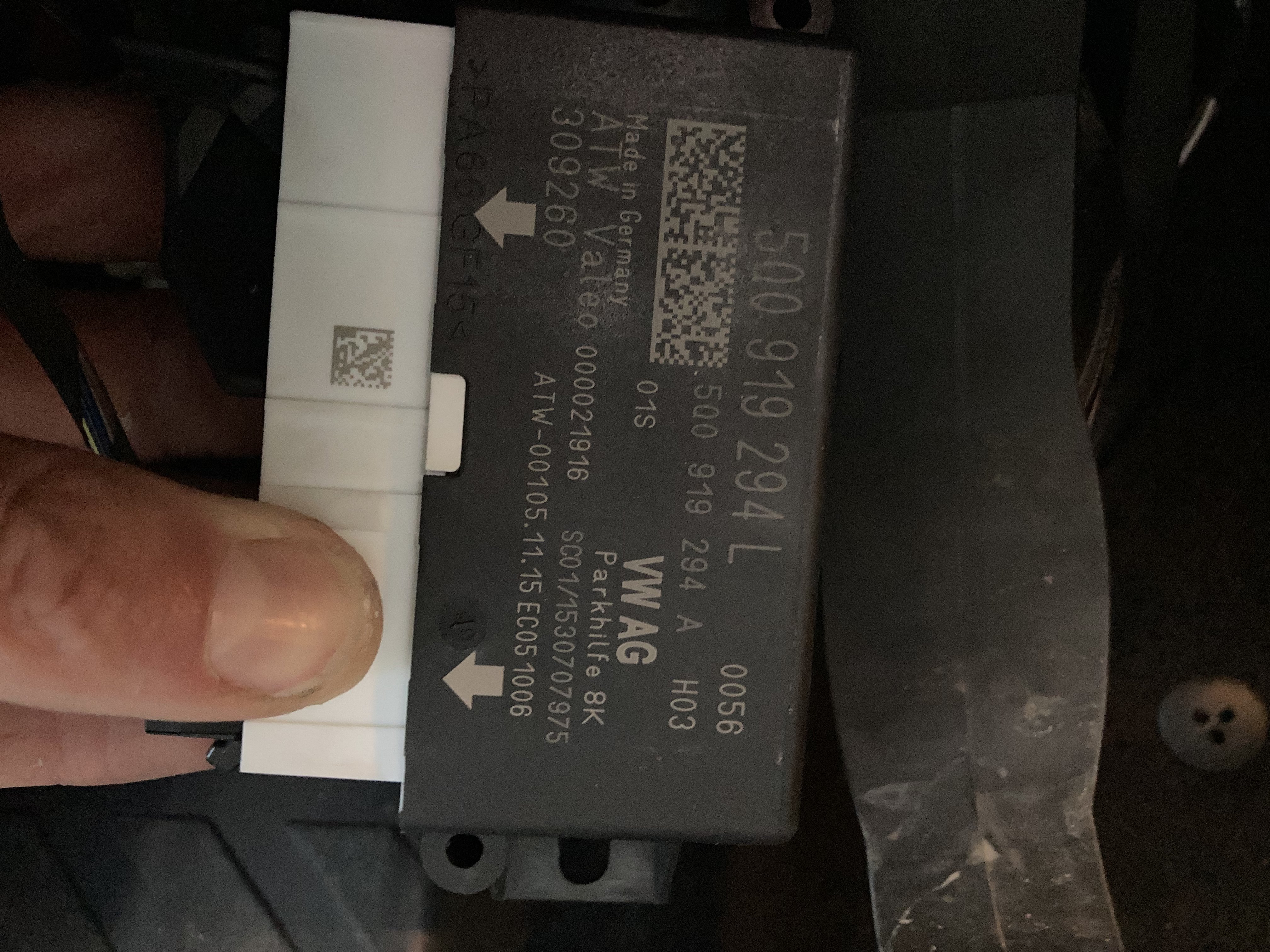

last week my front pdc stopped workking, got the car to a mate who read the car out en got next problem
B10F514
Front Pdc buzzer is in fault, a ground problem or so…
now do i like to know where could o find the buzzer or is it the pdc ecu thatz next to the clutch pedal i do need to replace? Like the picture underneed?
greetings
pdc front buzzer is on top of front fuse box behind glovebox on rhd car.
So on Lhd car should be there to or? So  somewhere next to fusebox? End it isent the the samething as in the picture?
