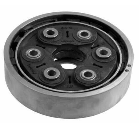

Could it be the rubber delaminating in the rear propshaft joint?
