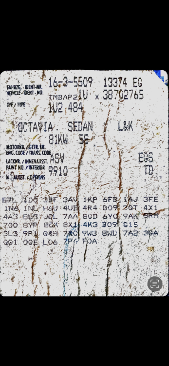

Hi I’m trying to find my ecu number for my mk1 53 plate 1.9 tdi without having to look under wipers ect as not very machanicly minded is there a way to find this I’ve got the sticker from inside the boot but not sure if it’s on this  if anyone could help would be very grateful thanks 3AA8C03A-8FAA-45DA-AA11-B68B40FB9AB3.thumb.png.382e5532ecaa5e4b7d46f0c92fa39321.png

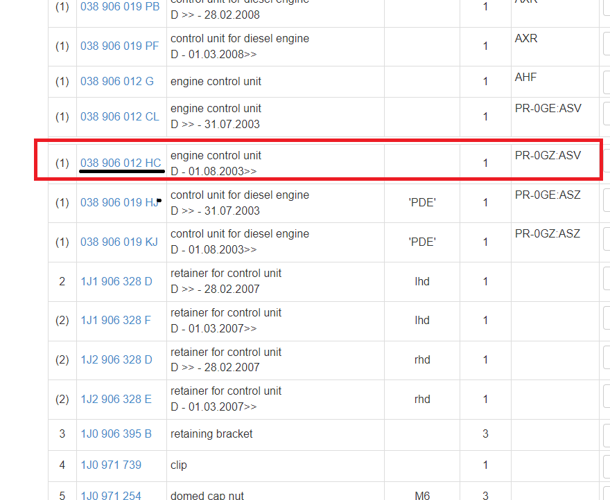

According to the parts catalogue, for an ASV engine built on or after 1st August 2003 the engine ECU will be part number  038 906 012 HC:
