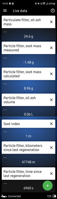

@310golfr there you go, not sure about those ash levels, is that a shot dpf or?
Looks like your dpf only has around  25 g of Ash, so there should be plenty life left in it.
Problem is the regens are too often.
9g of soot after 48km (30 miles)
= a regen every 130km (80 miles or so )
Even with lots of stop starts and a cold engine, ie  all town driving, you should get around 180 miles before the car regens.
Was told also that those 9g are calculated, and that measured is the real value, but both are conserning, i was thinking of trying to remove the dpf, straight pipe it, code it out, just to eliminate it from the equation, to see if indeed its the dpf, as its was easier then trying to get to the charge cooler..
