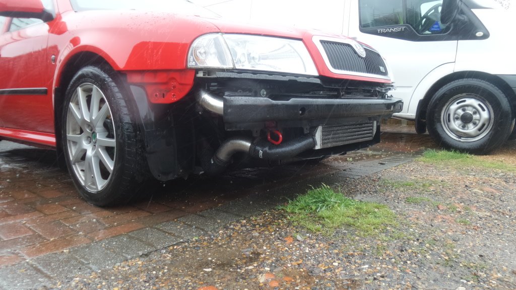

When fitting a FMIC it's not necessarily bigger is better because you can go too big. It's more about building a system that'll provide a good flow. Here's what I have on mine:
As you can see, it's certainly not massive but it does flow really well and when I last put it on the rollers it ran 225bhp consistantly without dropping off during the back to back runs which can happen on poor setups that can't cope with the rising temperatures. I'm also running a 3 inch downpipe and decat to further aid flow and I have a phenolic inlet manifold gasket to help with reducing heat transfer from the head to the inlet manifold.
I'm afraid I can't help on sourcing the FMIC parts unfortunately as I bought my setup from a friend when he broke his car, all I do know about it is that the pipework is custom made stuff.

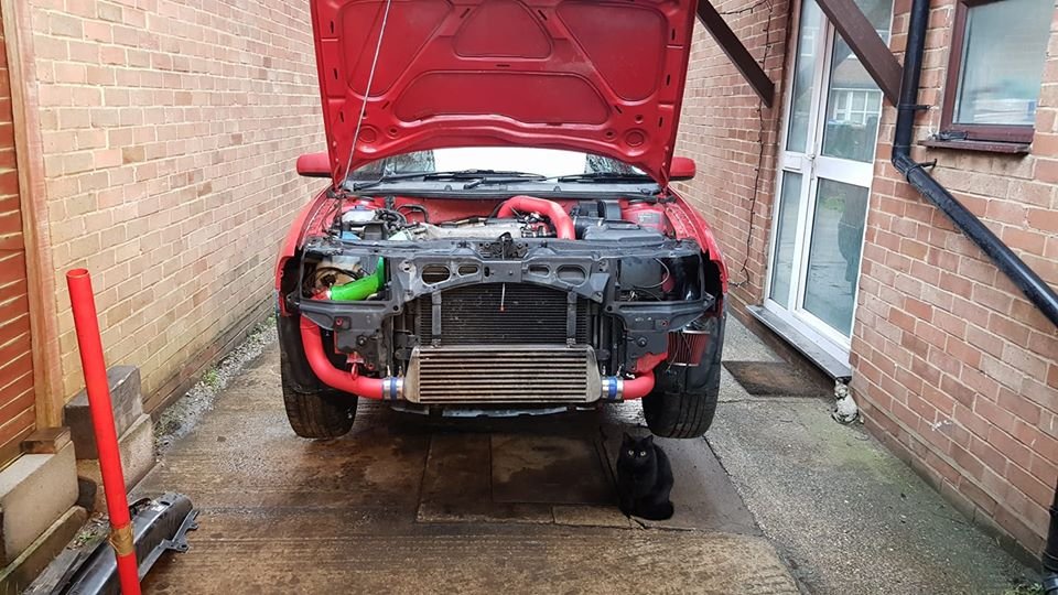

56 minutes ago, Endoof said:
I would 100% like a twin pass, which one are you running?
Only pic I've got at the moment. It's a full THS setup. Slight modification to the slam panel (inside) so the pipes site in place. It can't be seen at all once the bumper is on. I have a bracket that supports the weight of the FMIC neatly, and it bolts to the slam panel. Unlike a lot of other people who attach it to their front panel.
