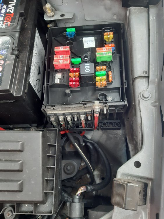

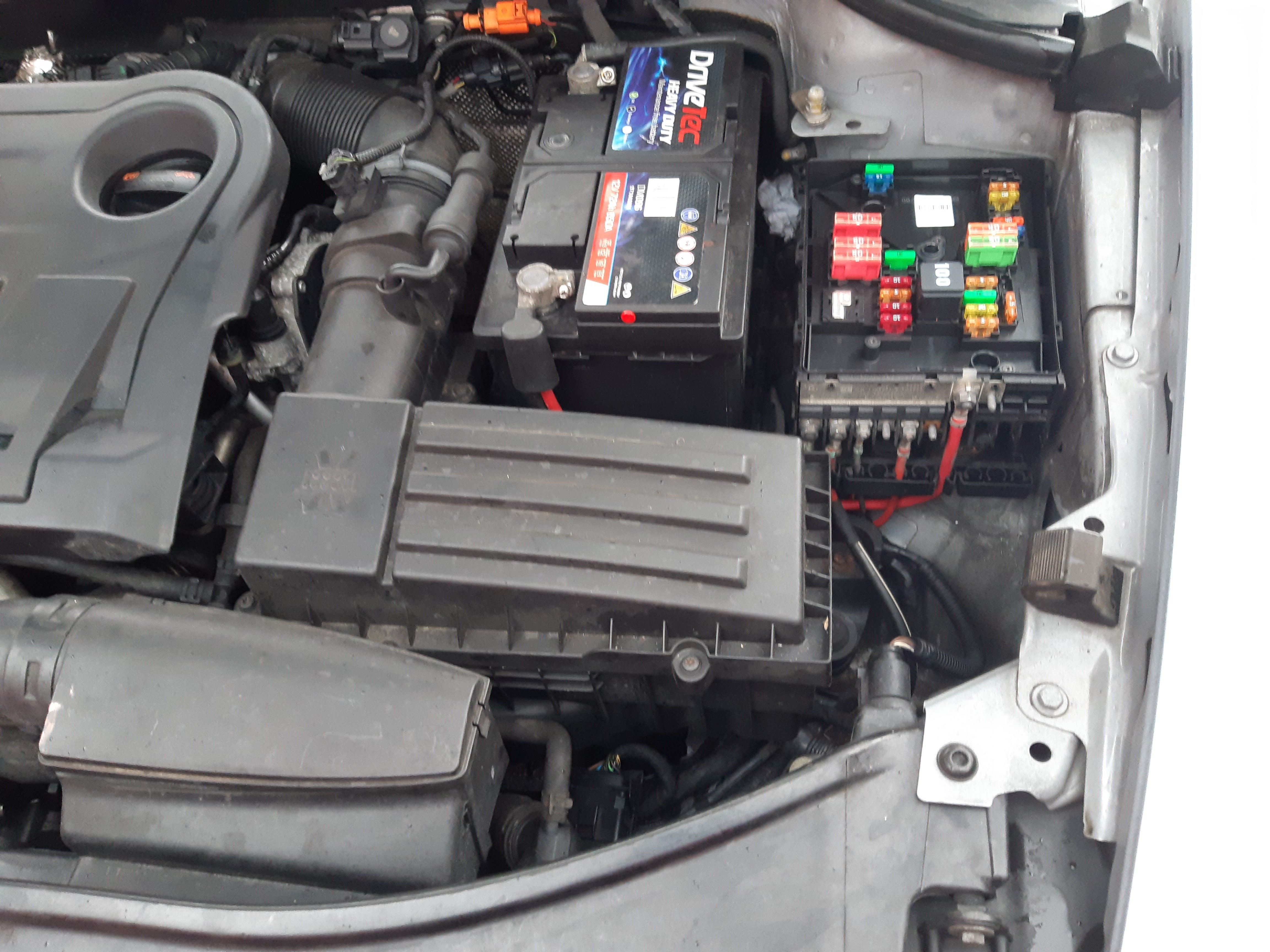

Haynes says it's found at the side of the AC relay in the left hand side of the engine compartment for LHD models. I can't see these relays on either side
of the engine compartment? The engine has to be running to allow the RHW switch to be operated so I can't hear if there is a relay clicking anywhere
when I do turn the switch on.

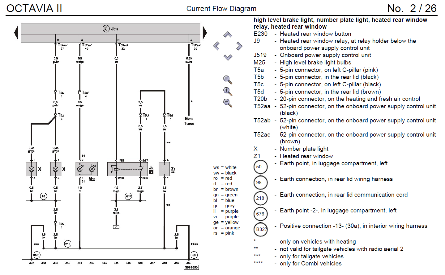

I expect it'll be the same as a similar aged Octavia:
So it'll be next to the BCM in the drivers footwell above the pedals.

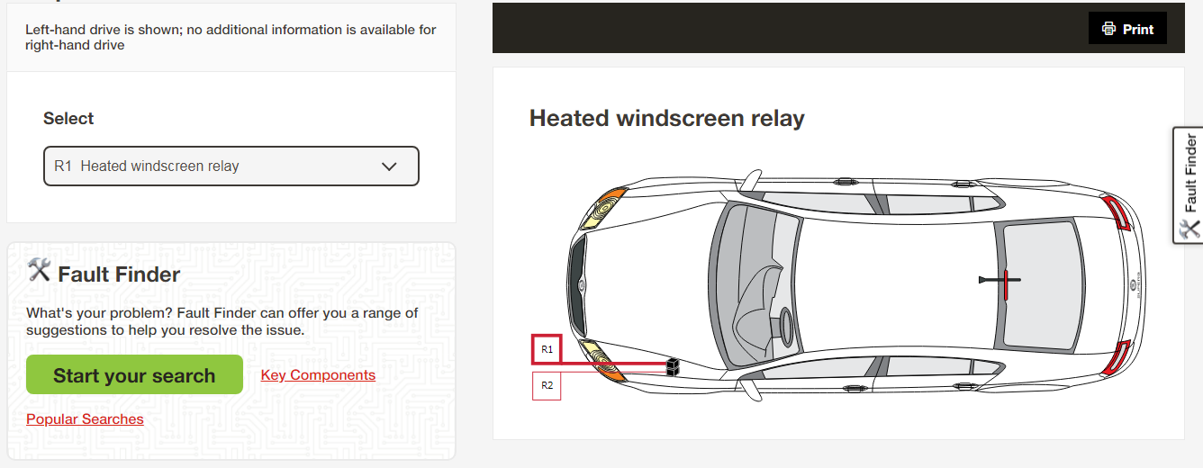

look here
