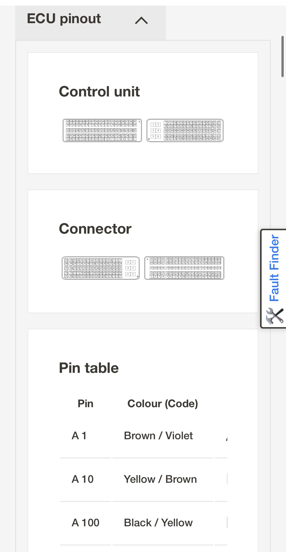

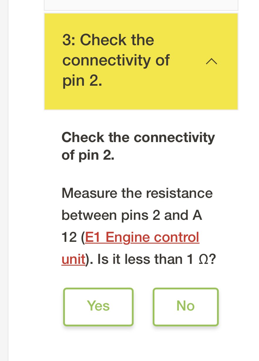

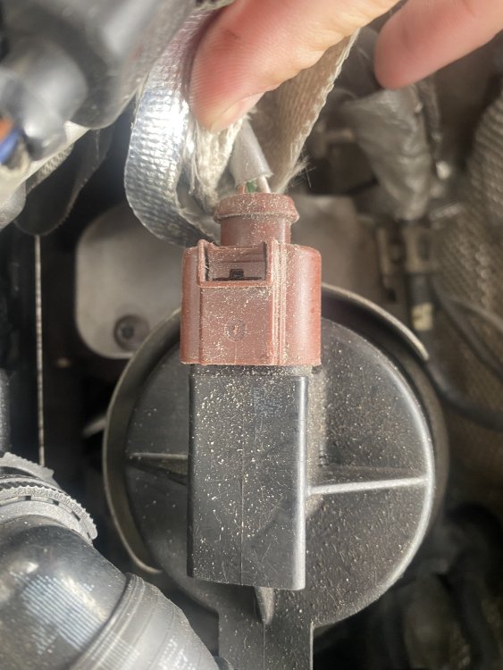

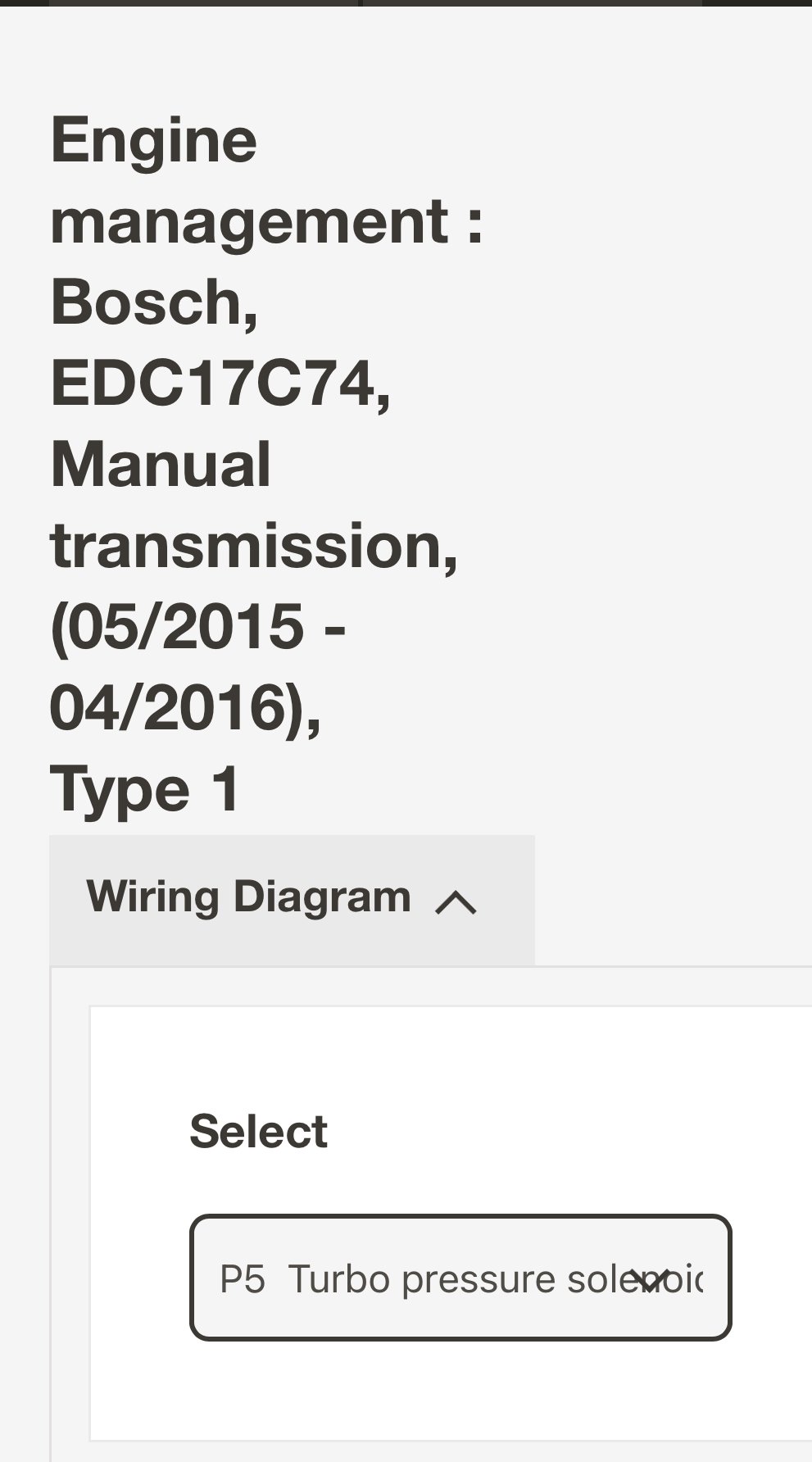

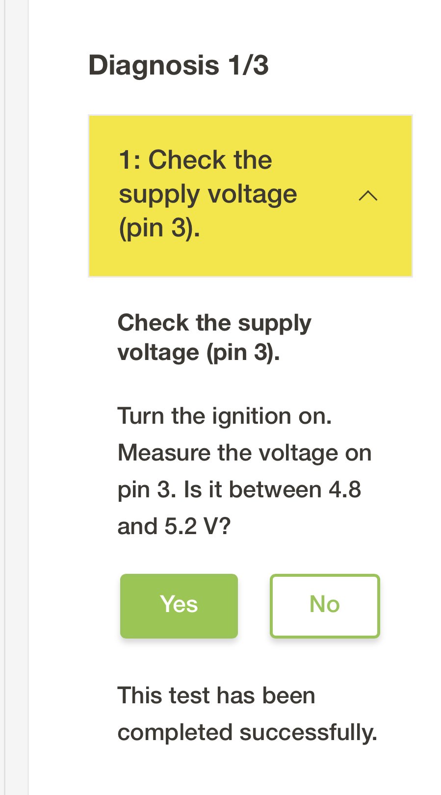

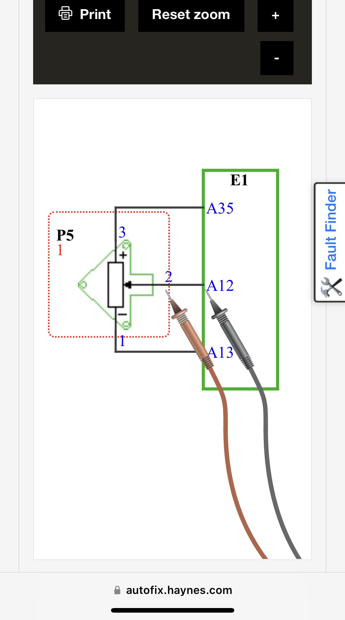

P2563 taking me to the Turbo actuator connection. I’ve tested the voltage as described for the white & brown wires, and both are fine. But the next part asks me to test the connectivity between the green white and the ECU.

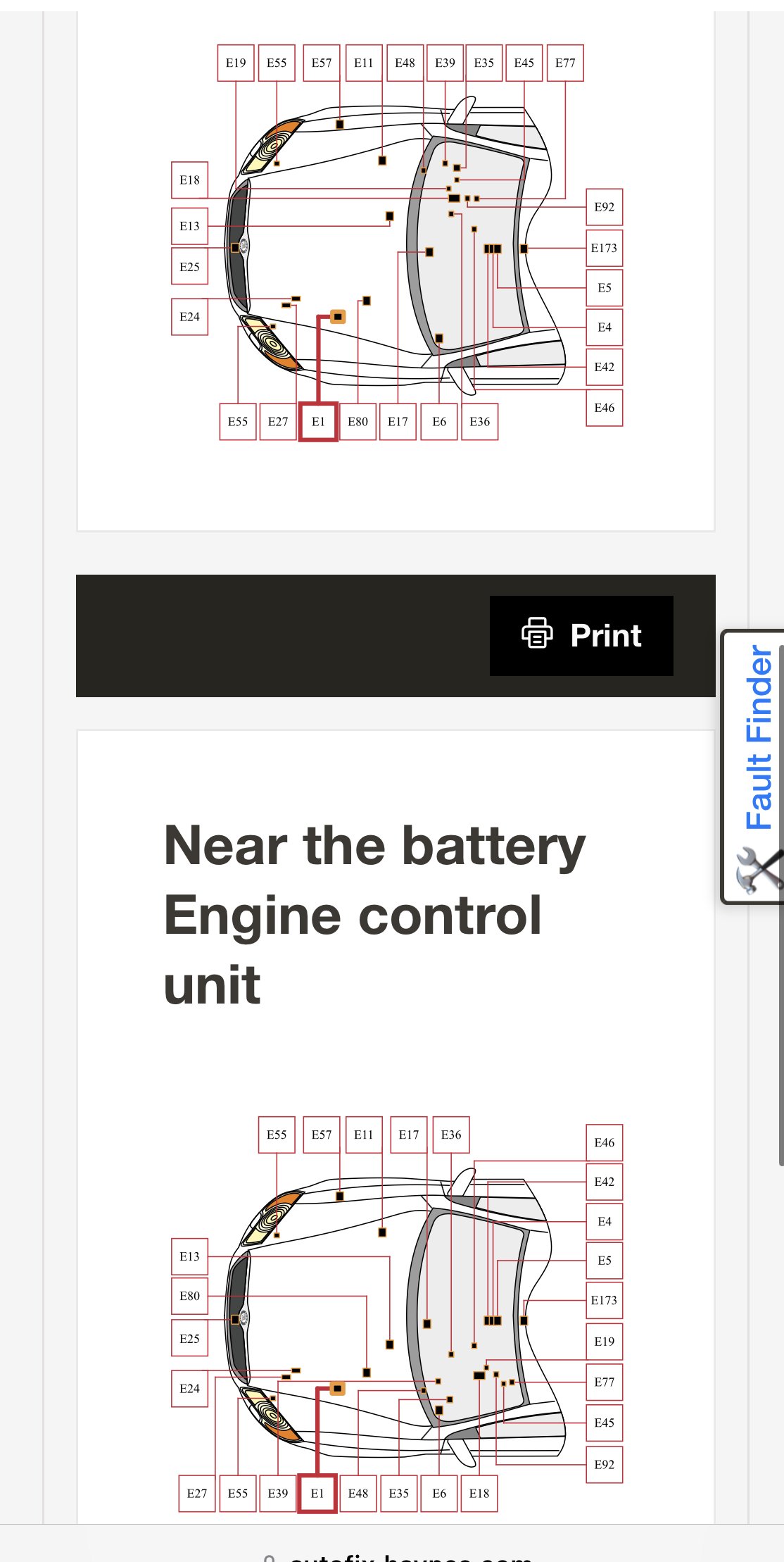

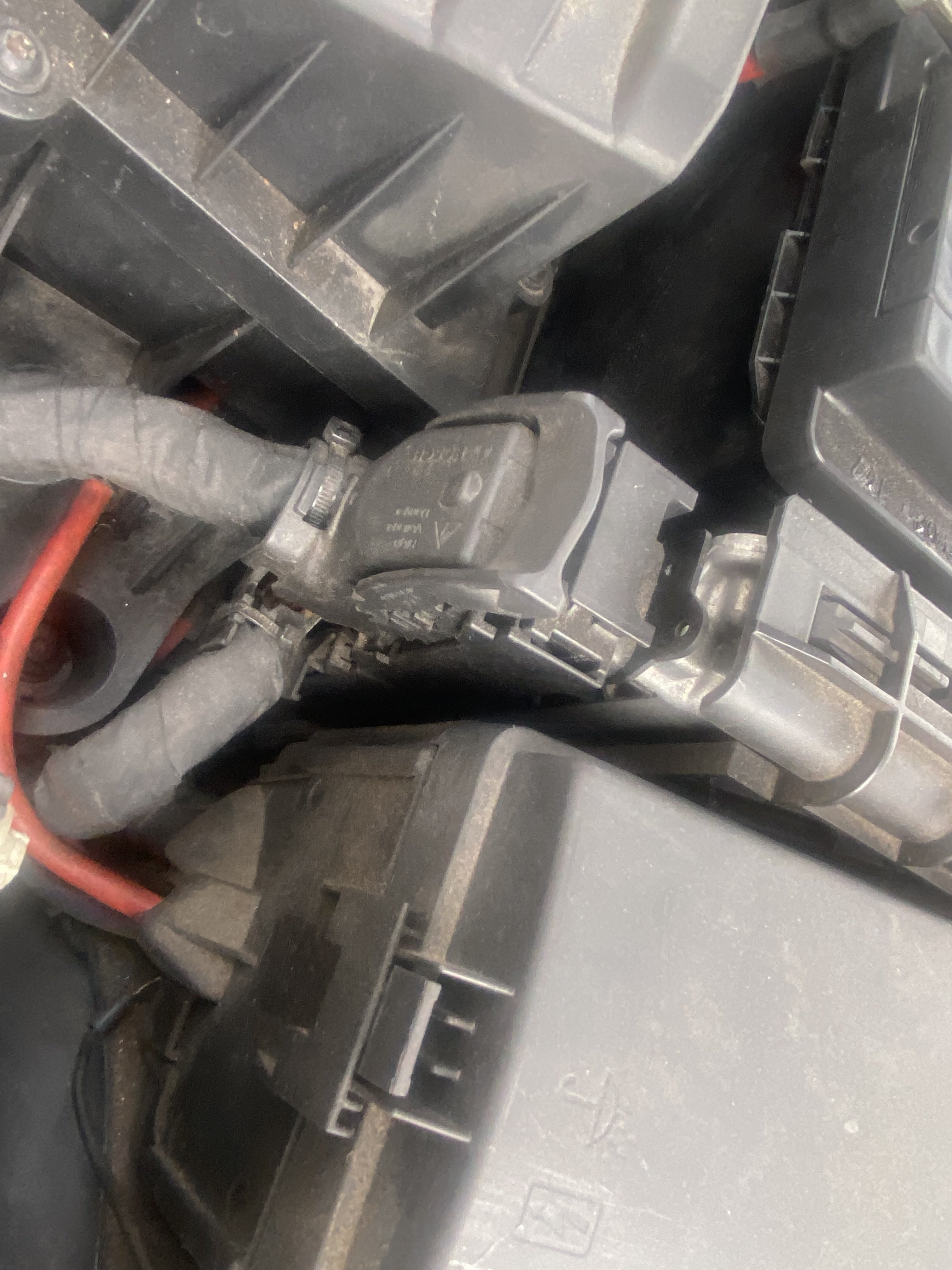

Looking at the diagram, I think it is the one in the picture, do I just unplug that? And find A12? Is it safe to pull an ECu plug?
Ive been giving you OEM data and wiring diagrams from the start, why purchase more of what you have?

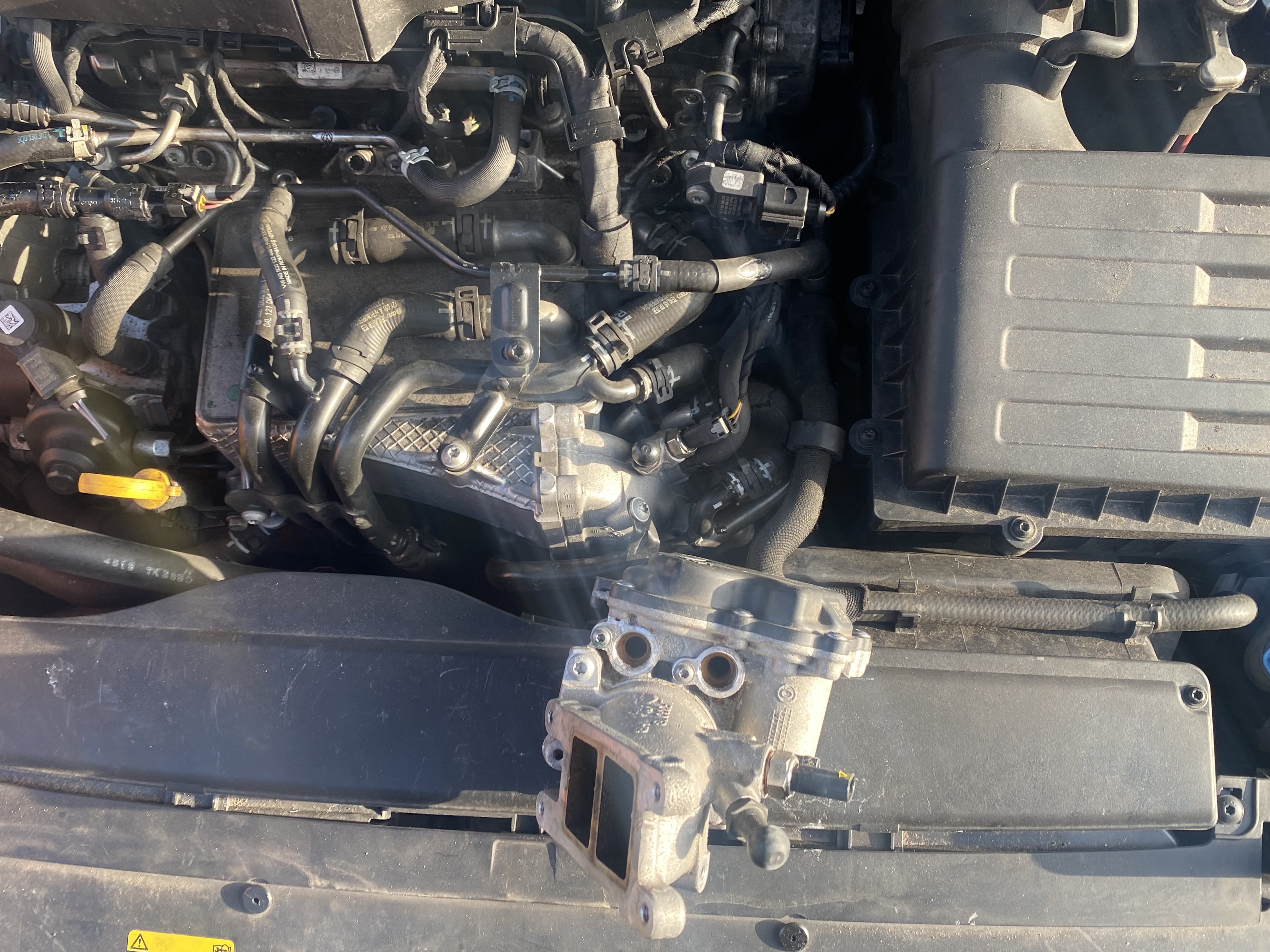

I changed the Throttle body with a used which cost pennies. Fault not fixed. Investigation those wires is next.
