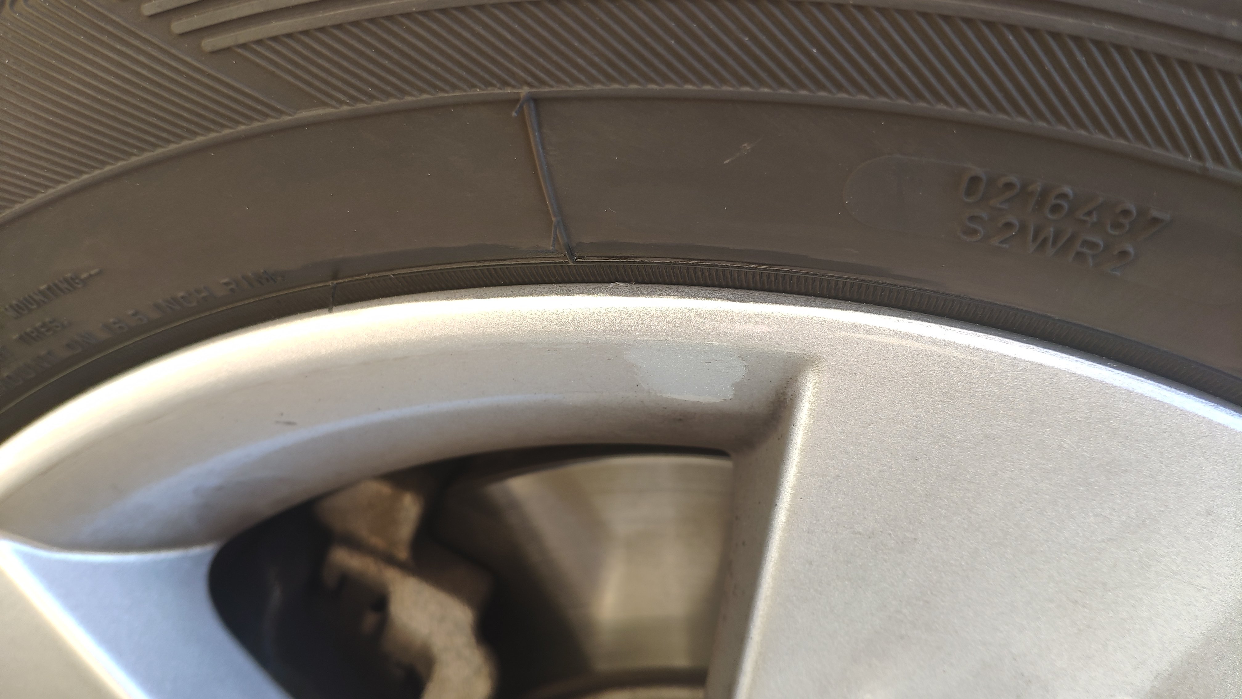

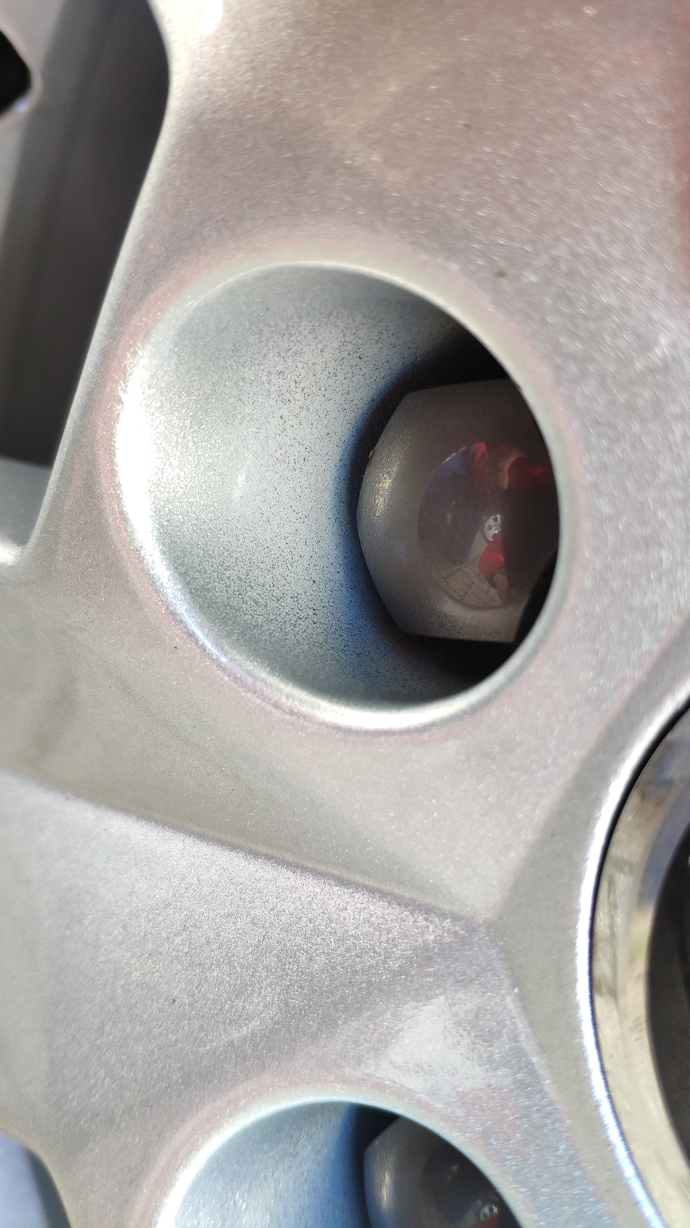

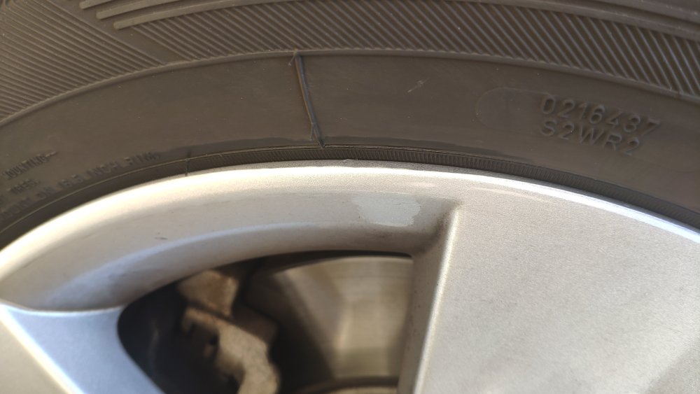

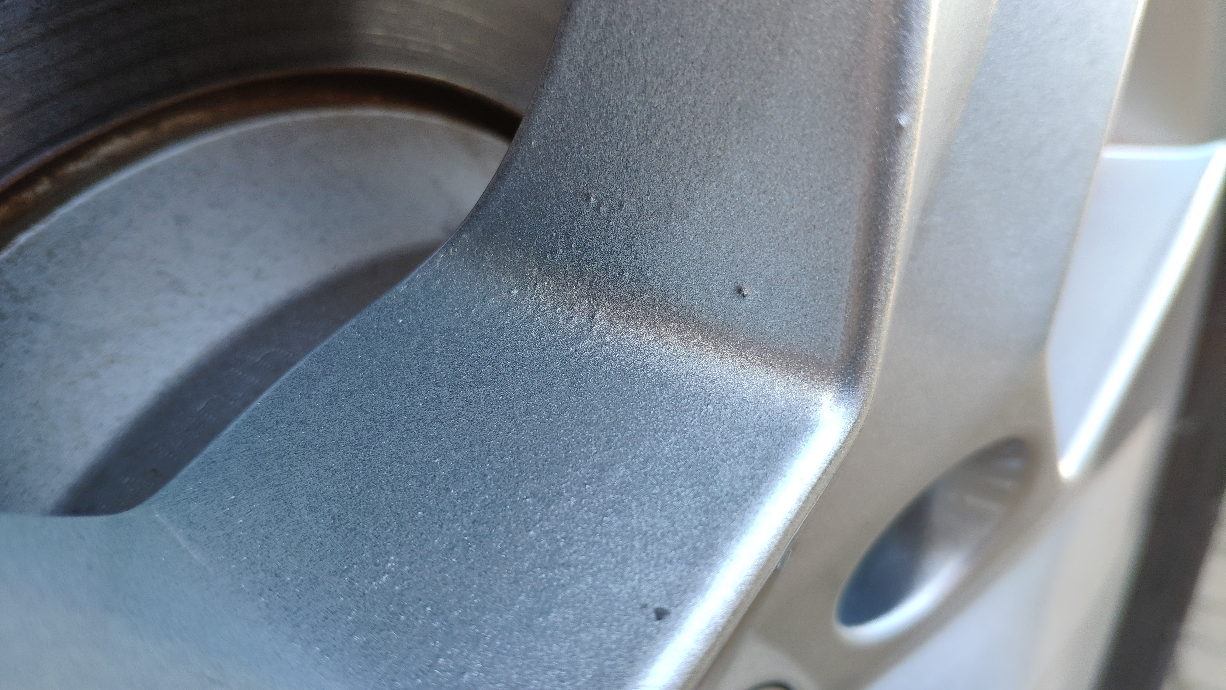

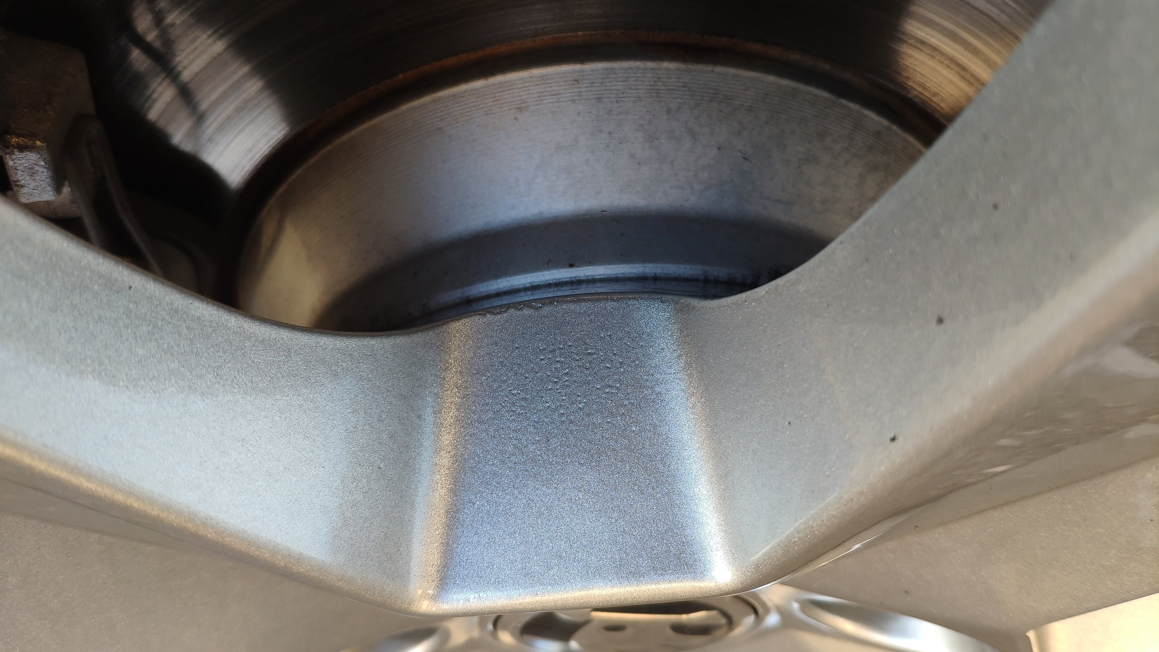

1- Does anyone know what kind of factory finish is applied to the Orion 16" rims (paint or powder coat)? I had ALL FOUR!!! damaged in a tire swap operation and the "repair" done at the cost of the workshop (twice already) is complete sh** ! They supposedly sent them for a rim specialist but both times all they did was apply a bad coat of metallic silver paint. Never corrected the metal they removed from the edges and the paint has uneven coverage/dirt (especially in the holes for the bolts, edges all around and inner spoke surfaces) . I'm taking this legal now, since they refuse to admit this is an unacceptable job (plus they damaged them again mounting the tires, but still don't care... it was in Norauto, btw). It's not even the same kind of silver satin finish, it's a very shiny, metallic flaky finish... A few pics to illustrate obvious defects are added.
