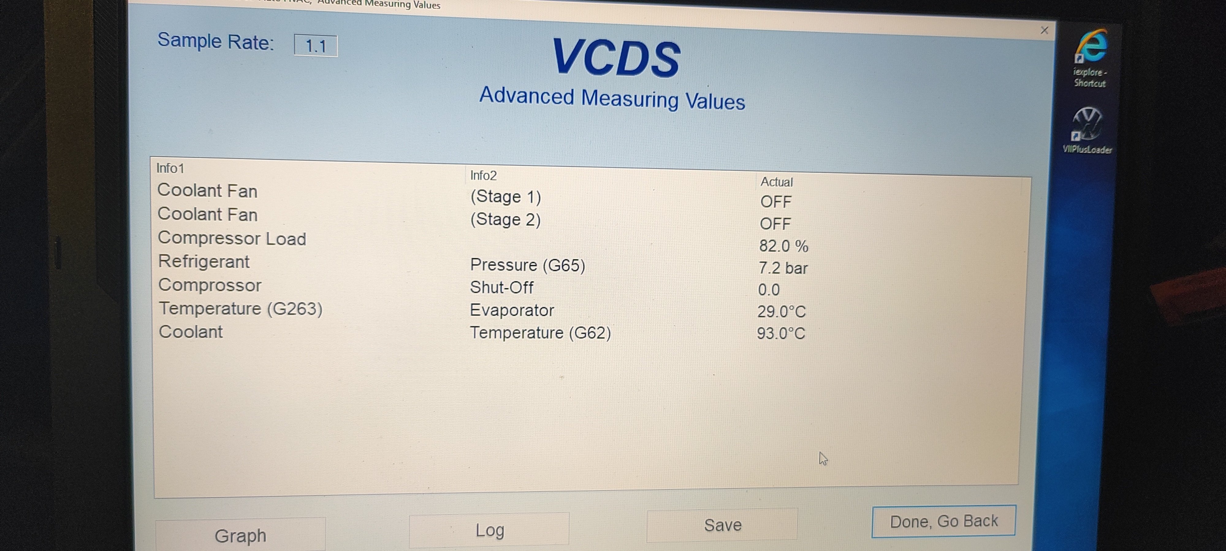

I bought a brand new one and fitted it. I bought a used module as well and fitted it. I also bought a new thermoswitch but haven't fitted it just yet just in case. Nothing worked yet. Here is a picture of my fake vagcom reading.  Car is at idle.

Have you checked that the compressor shaft is actually turning, as well as the pulley? Everything you see when you look at the end of the pulley should all be rotating.
Fan action won't be triggered until refrigerant pressure exceeds 9 bar.

The pressure guages would indeed look very different, I have VCDS which only measures the high side pressure, a manifold guage set and a vacuum pump, what I cannot do however is remove, measure the weight of refrigerant and replace, therefore I have to watch very closely the high and low side pressures & the relationship between them together with the ambient temperature whilst consulting my charts whilst refilling or topping up.
If the engine was running with the aircon on full when the VCDS readings were taken then the system does not have enough refrigerant, the high side should go up to 9 bar guage pressure (probably 10 bar on VCDS) before the fans cut in and it drops whilst the low side increases again.
