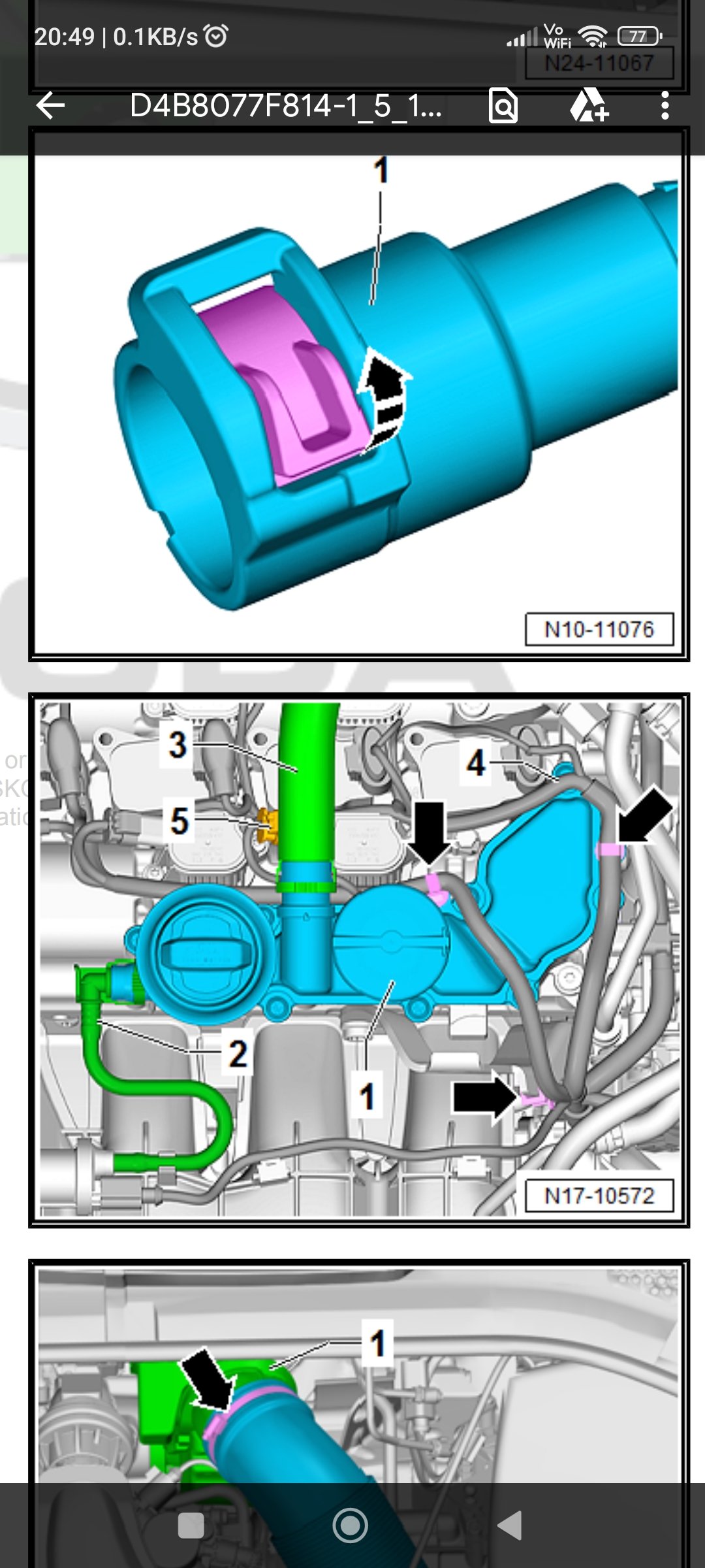

Take off the top engine cover.  Take a picture beforehand, and also look to see if it's the picture below
Green pipe 3 in image
Screenshot_2022-07-19-20-49-40-977_com.google.android_apps_docs.thumb.jpg.68788439be4661de48255f7d01a27764.jpg
Edited by varooom
Image added

Cheers for the diagrams, I've been out, removed the cover and bingo, it's the green highlighted pipe.
Clipped the pipe back on and tested it, all sorted.
Thanks for the help 👍
