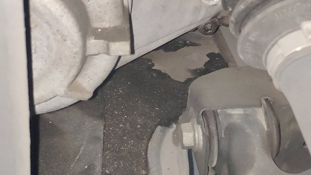

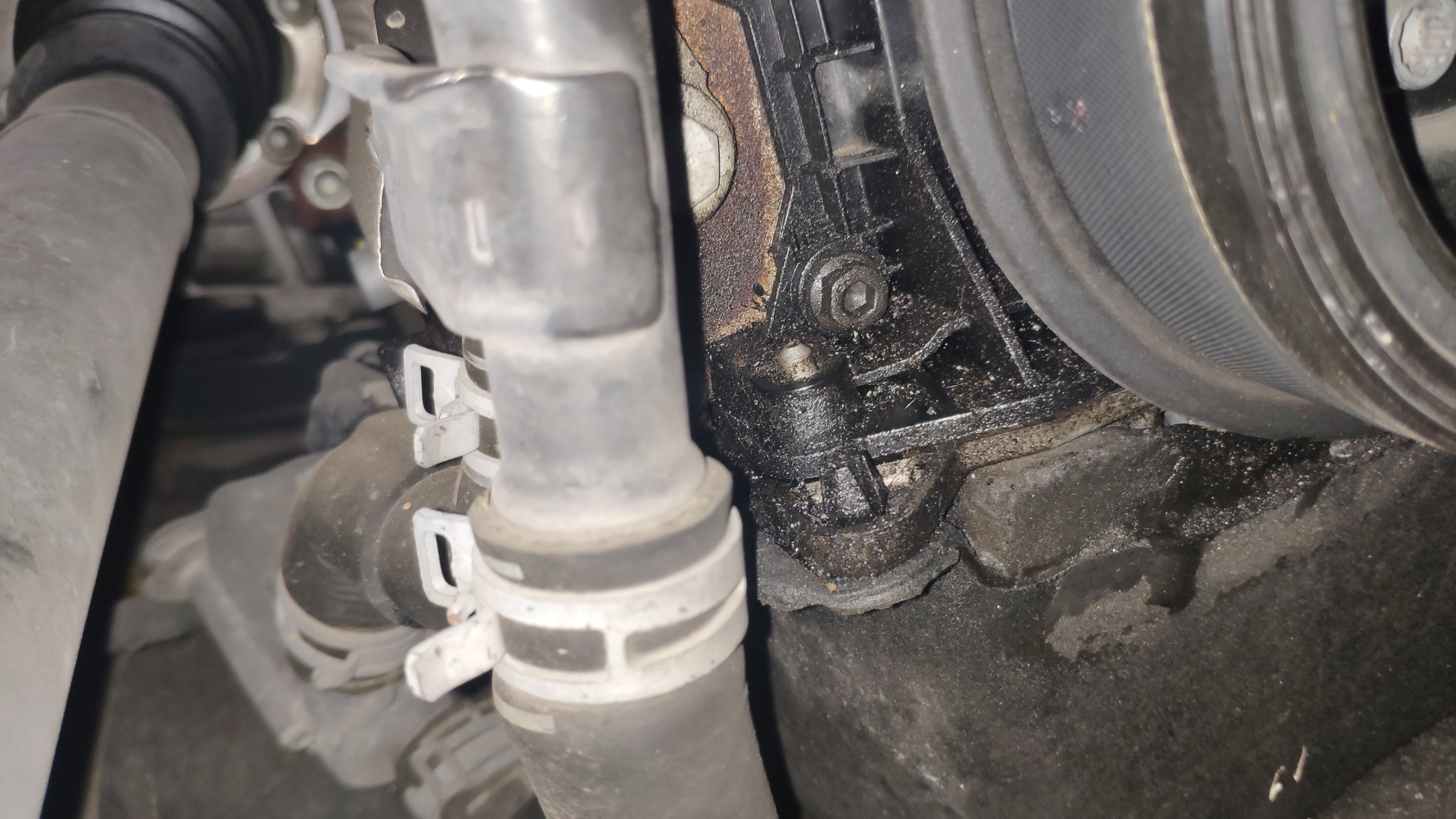

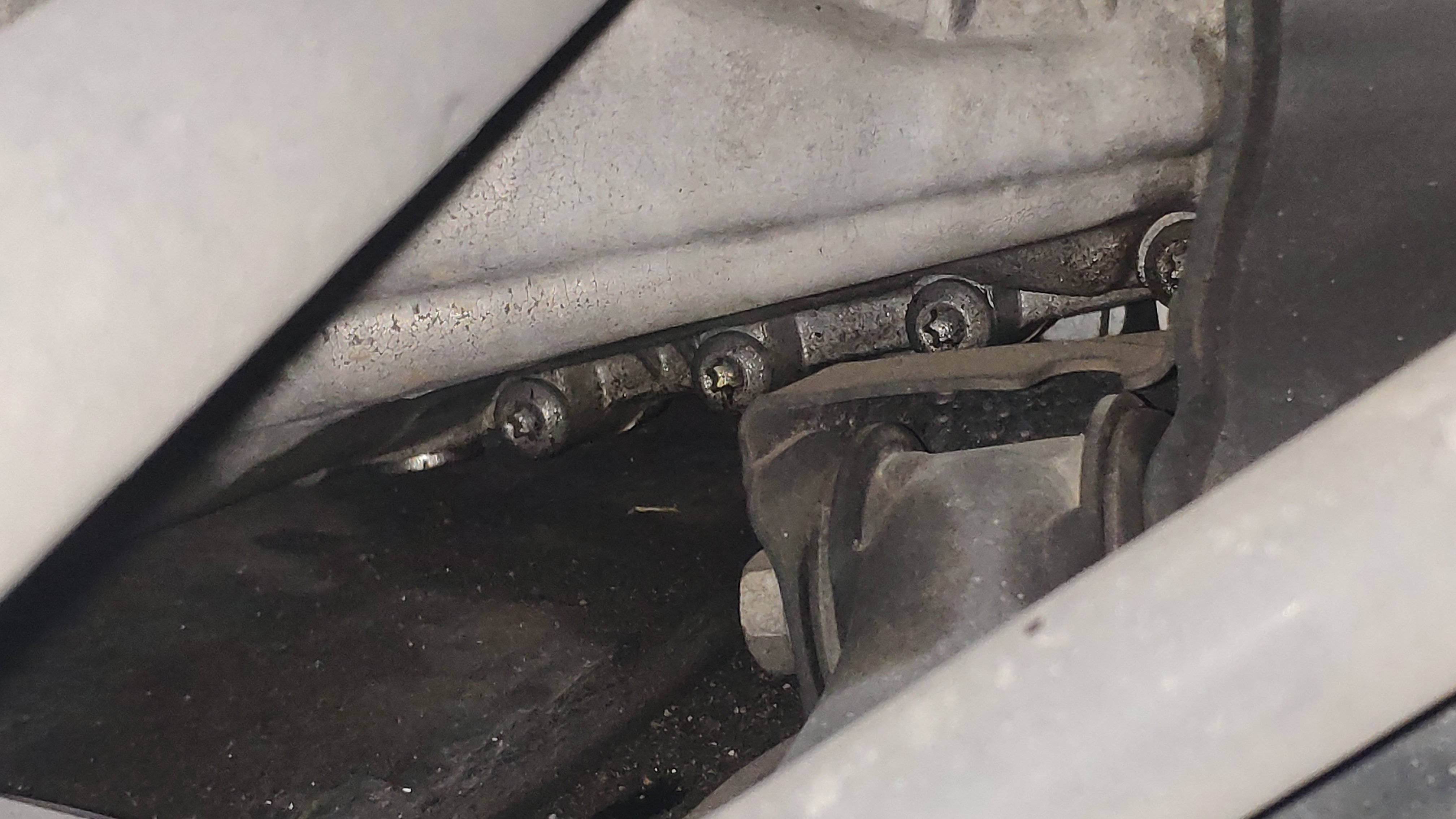

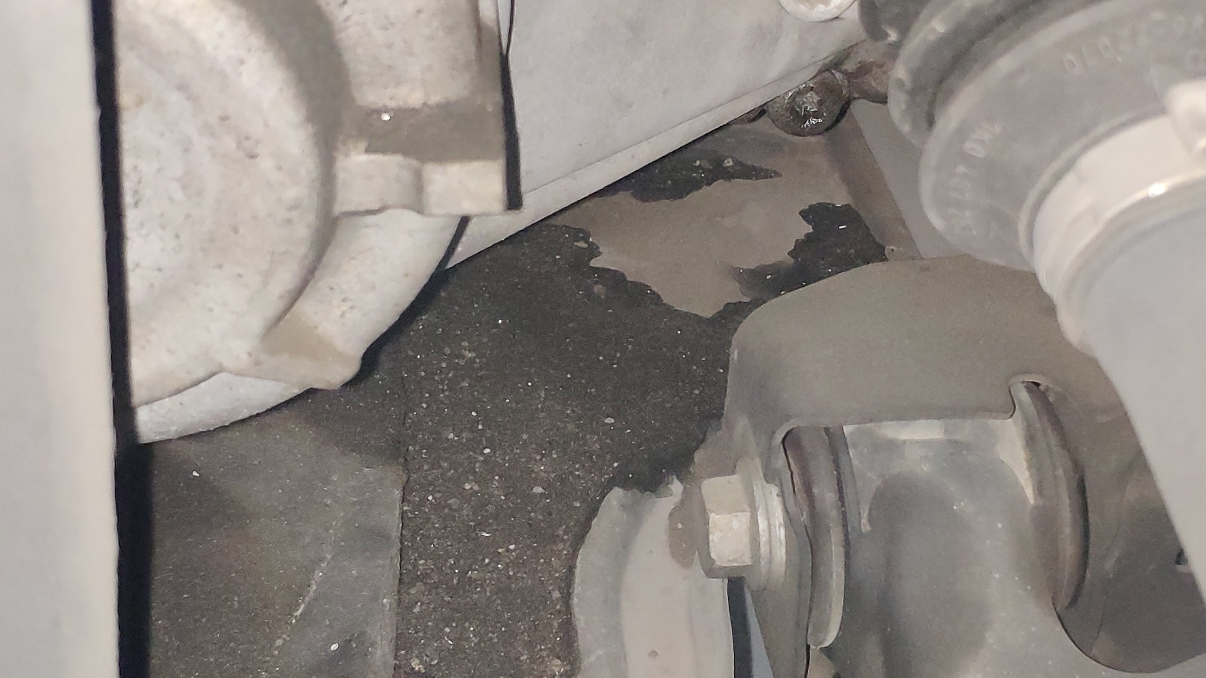

So, yesterday I removed all four wheels to send them for refurbishing and took a look at the engine areas that were visible from the openings in the wheel arches. I was surprised to see so much oil all over! Considering that no spills are visible on the upper parts of the engine (from services, since I only ever topped up once myself, very carefully), could this be a sign of oil leaks? I'm beginning to think this car will be a well of problems not so far down the line, so much so because every thing I ever complained about during the 5y extended warranty  was always "nothing we can see or hear".... Some pictures attached. Car has only done 75k km, should be as new considering my driving. It's soooo much worse than my 382k km, 21 yo petrol astra... The dark stain on the last picture is oil spilled on the under tray, can't imagine how much is soaked in the felt-like lining right under the engine...

If no oil has been spilled at any point it’s 100% front main oil seal, I’ve done loads.
Thanks Sherlocks VRS! Excuse my ignorance but where is that located in the engine and would it be a warranty issue?
Cheers!

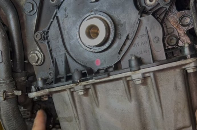

The front main seal is is the end of the crankshaft not connected to the gearbox. So just above the sump
Thanks! So, together with a video I just saw, the seal would be part of the oily black plastic bit just behind the crank pulley on my first photo, right? As in this screenshot below.
 This is where I first saw oil, but there's a lot on the other side too... I need to take it to the stealership as soon as I get my wheels back from refurbishing. They'll likely say it's nothing, it's normal...

Quick update, they did find an oil leak from the gearbox (that's what is causing the big stain on the under tray) and the valve cover (that one I could not see) but say that the crankshaft seal was "clean". I disputed this and they insisted on it until I showed my photos taken the week before. Then yeah, they agreed to send that in as well for an insurance claim... 😒 Sadly, they will only do it after the 16th since the guy that took my case will be on vacation. No matter as I'm away too, but it could speed things up a little.
