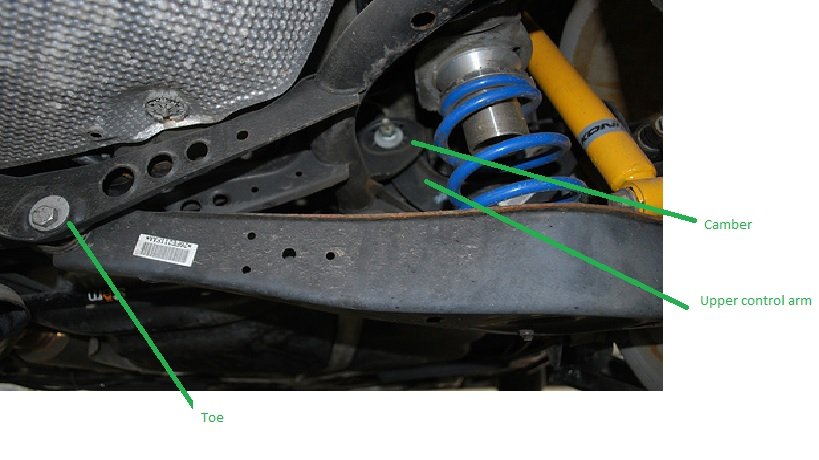

there is toe in and camber to be adjusted on rear849148086_wChEjcU(2).jpg.8714b97fe7a97ff0c338b35559619653.jpg

The cambers are both within spec. Its the toes. It goes all the from 13 down to 1.8 then back to 13 once the bolt has been turned full 360
