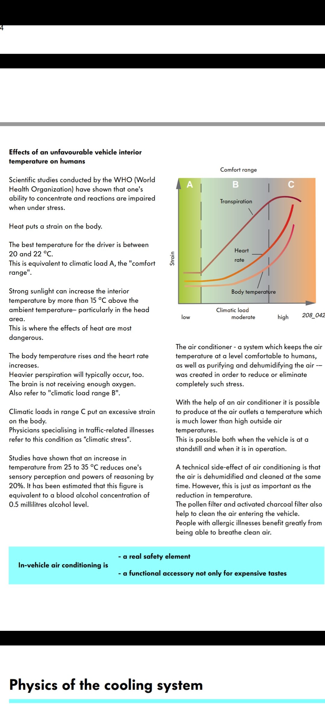

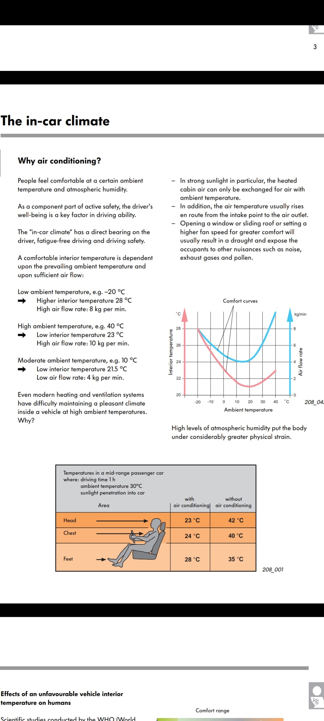

Here is some information from the technical documents describing how things work (SSP's)

Although I find auto button very good, there will always be someone that thinks they know best, so this is why we have manual settings for fan speed, individual vent controls and of course the A/C on and off (fuel savings)
So I guess this is why they are included as some will want the manual control options.
As stated in the above images, we humans tend to find 20-22C comfortable zone in the car.
I set mine in Auto with AC on all year round, often at 22C, but sometimes 21C.
Bottom line is if you have Auto, use it, and leave AC on all year too, as it makes the comfort inside the car better.
