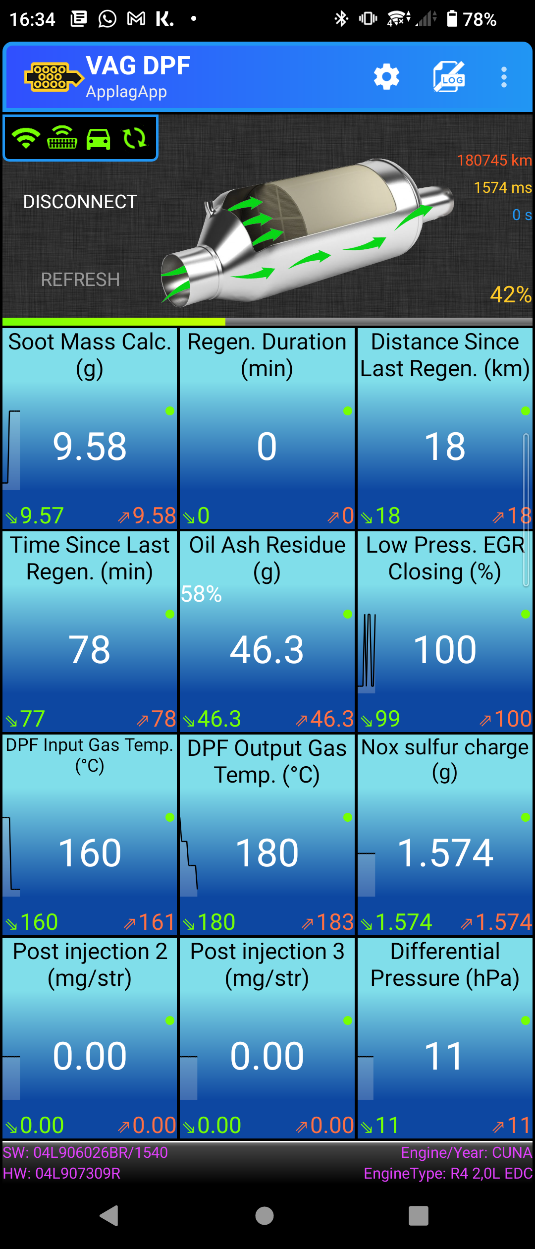

Just looking for some advice really for my Octy VRD TDI 2015. Current readouts from the VAG DPF showing attached ash levels at 45.6g.  is this acceptable/normal? Would a DPF clean at this stage be good/do any harm? It's not flagged up an uh EML or cause issues so far.
They look fine to me, if the car is not drinking excess oil, then you should be ok.  It's reported as having used 58% of it's estimated lifespan.
Does that tool measure Soot mass measured?  Ideally you want both values.
Ah ok that's good to hear. Yea I think it's at the top left which usually clears after a regen.
Yea I figured it's done half it's lifespan for the mileage (112k). Was thinking of a DPF clean to start a fresh lol since it's a second hand car. Runs smooth
You could pay to do a clean, and reduce the soot to zero (well a few grams) and within a short distance the soot will be increasing again.
The DPF is just a soot trap, and if things are working as intended, the regens will take car of themselves.
You have the tools and own gut to know if something is 'off' with the car.
Drive and enjoy it I say.
