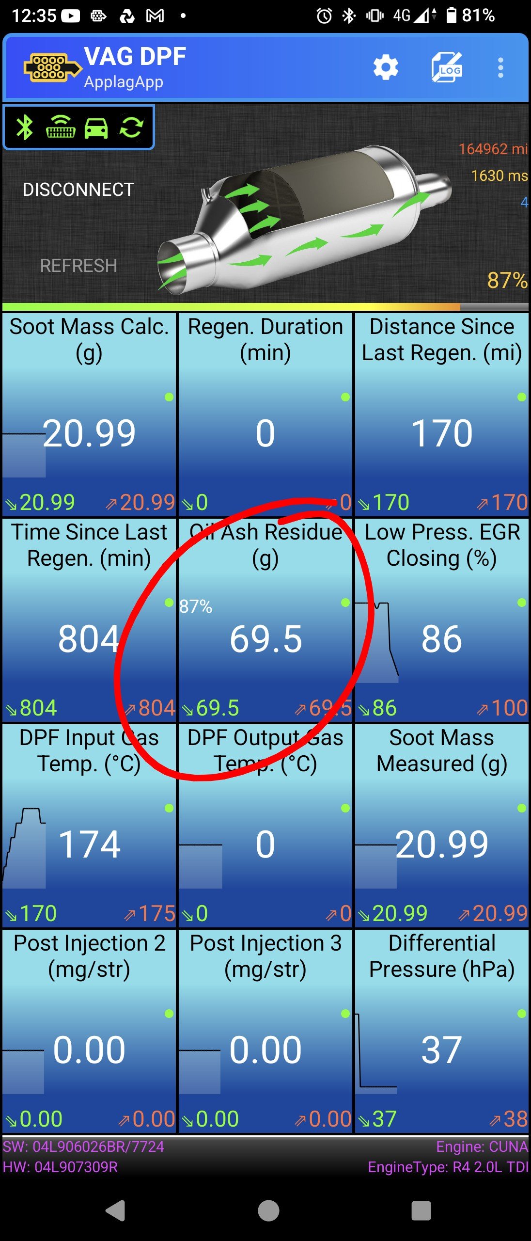

  1. Hi does anyone know how to reset this ash value after a clean out (off car) and re-fitted DPF? It also appears to be frozen and not regenerating. Tried adaptation though OBD11 but not working.

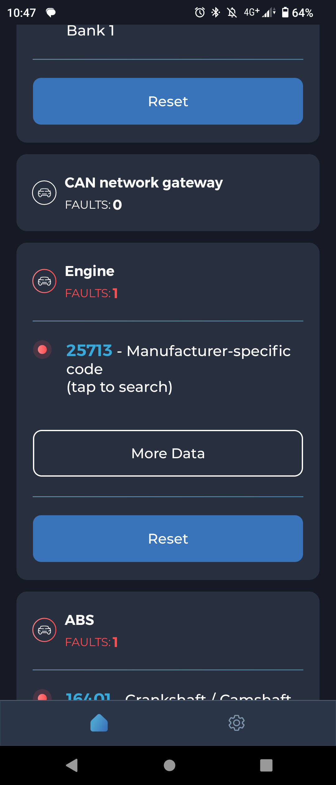

  3. Anyone know what tips fault code is referring to? It's engine related
