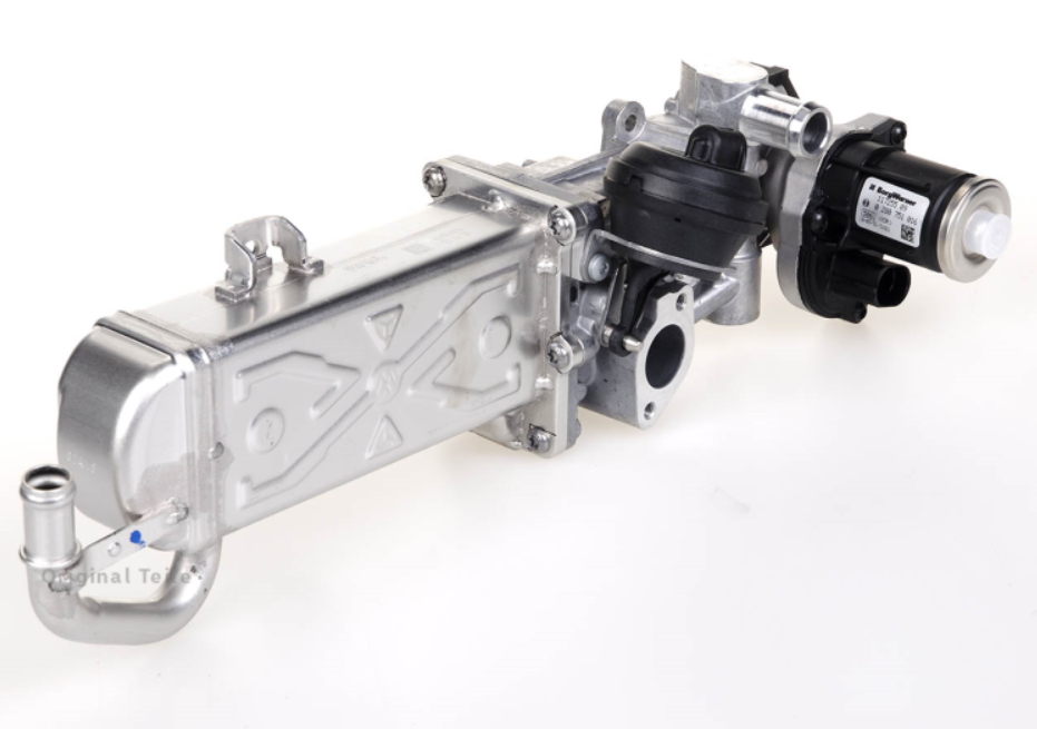

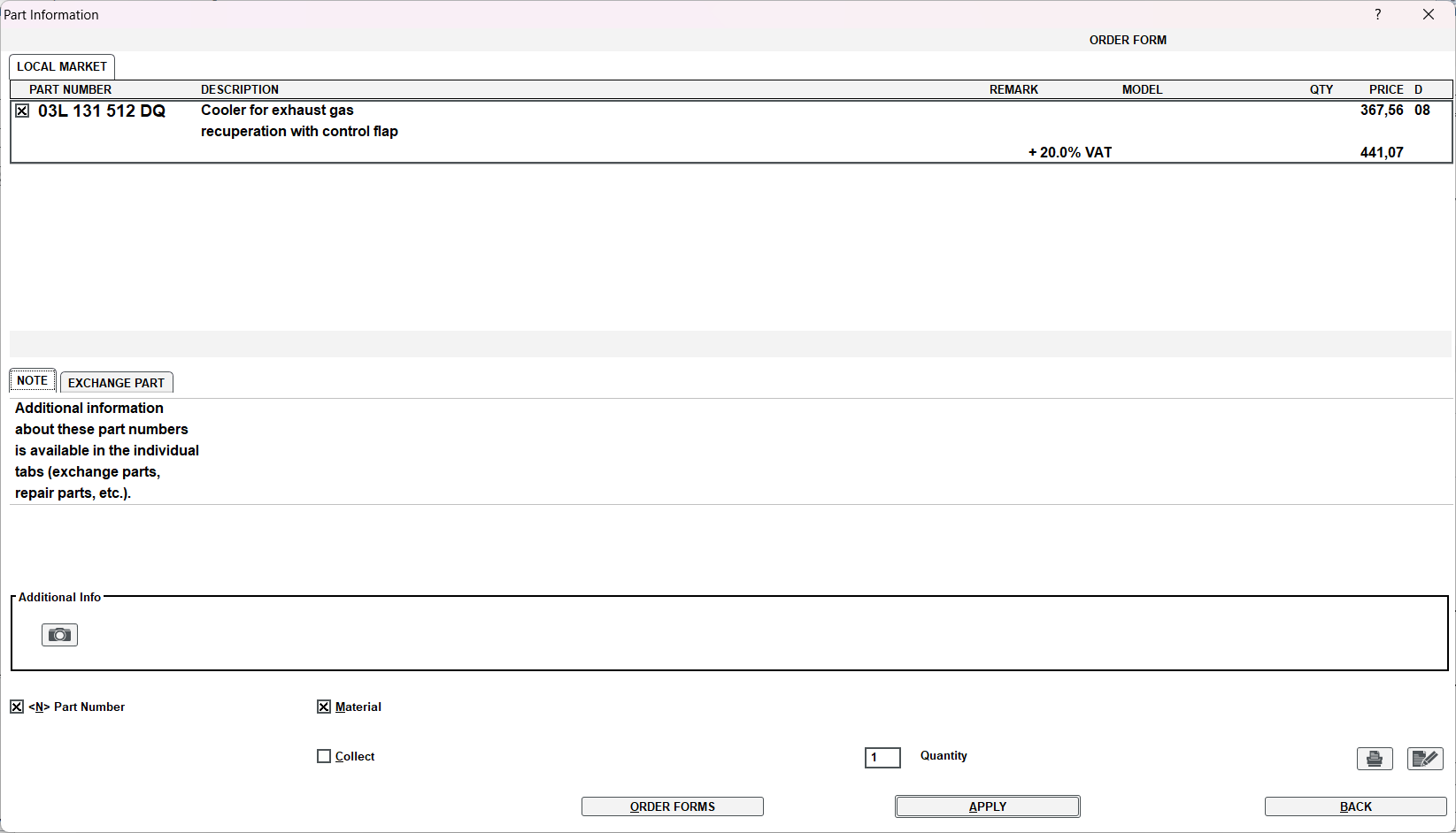

Hope this helps, here is the part code for the 10 changes made to the orginally fitted EGR cooler (yes they are that bad)
03L 131 512 DQ Use this code to look on the likes of FleaBay to find yourself one, or go with the one you linked to if you prefer
I did find a used one for under £50, though it might need a damn good clean, or could be faulty (luck of FleaBay there)

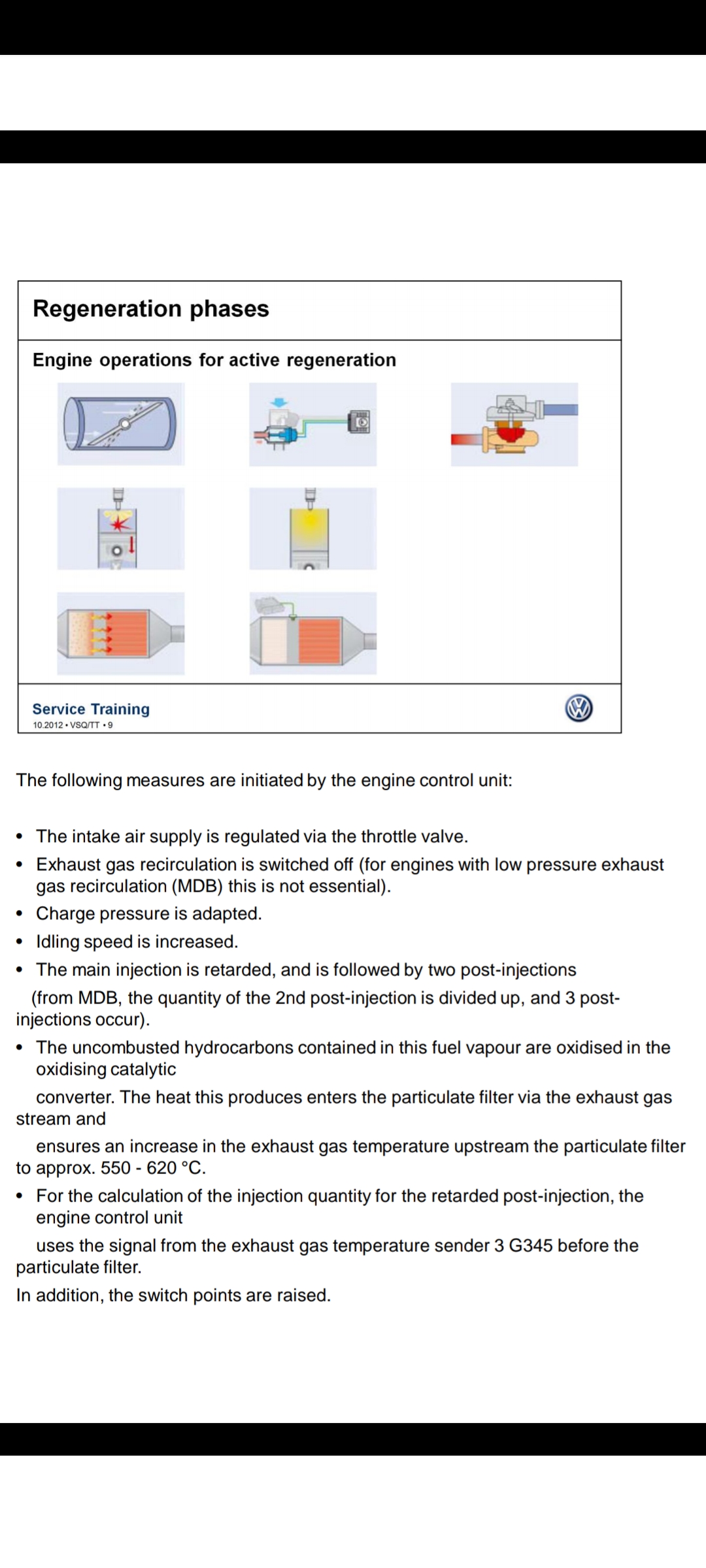

I am 800kms away from the VAG technical info I have on DPF regeneration but I'm fairly sure that it said EGR was inhibited during the regeneration process to maintain a high enough temperature, this was something that I looked long and hard at before deciding to fit an EGR emulator/simulator.
I agree that the temps are too low, it sounds like the post combustion fuelling is not happening.
Come to think of it the ECU needs to know that the EGR is fitted and working (monitoring of flap position) in order for a regeneration to happen (hence the reason for the emulator/simulator) it sounds like the "delete" is to blame.
Edited by J.R.
The car could be rejecting the process if not everything is working correctly, it could have tested EGR function and won't allow it to regen.
Screenshot_2022-12-24-20-02-33-204_com.google.android_apps.pdfviewer.thumb.jpg.79a879c4781bb66892867c117ec13e71.jpg

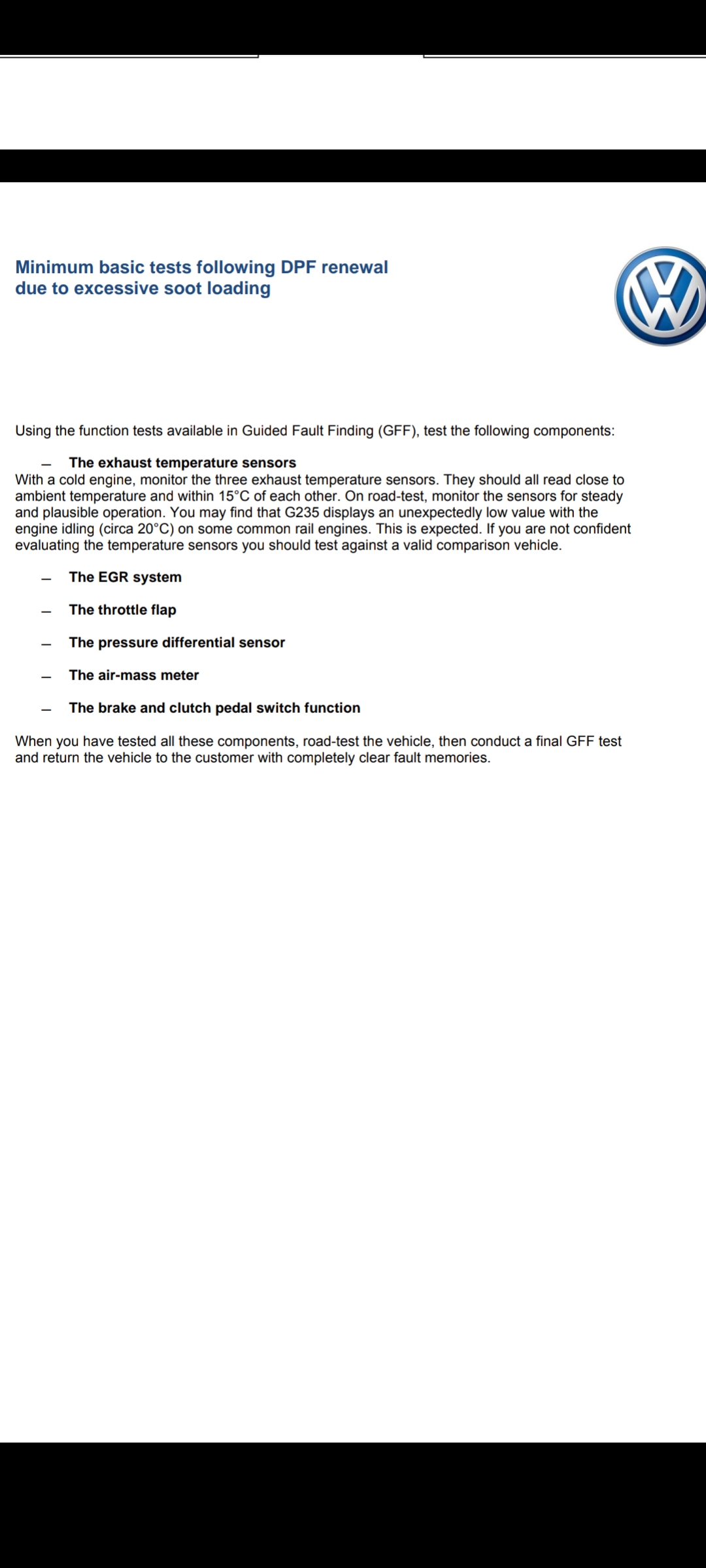

Here is part of another document about DPF checklists.
EGR System must function
Screenshot_2022-12-24-20-09-46-936_com.google.android_apps.pdfviewer.thumb.jpg.2da39056c4e61e5c27a868bf6d8bfbf5.jpg
