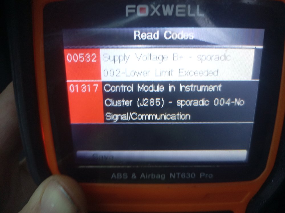

Got a couple of codes from the OBD2 meter, but still not 100% sure what they are.. post here just for anyone else's info..
says voltage supply sporadic so probably is shorting out somewhere...
If that's the only codes stored, then points towards power to the dash I think, or lack there of.  And the other is dash of course J285, that could be a canbus comms fault.  Might be idea to have clocks out and check that over.  Plenty of threads on here/internet regards to both faults.
