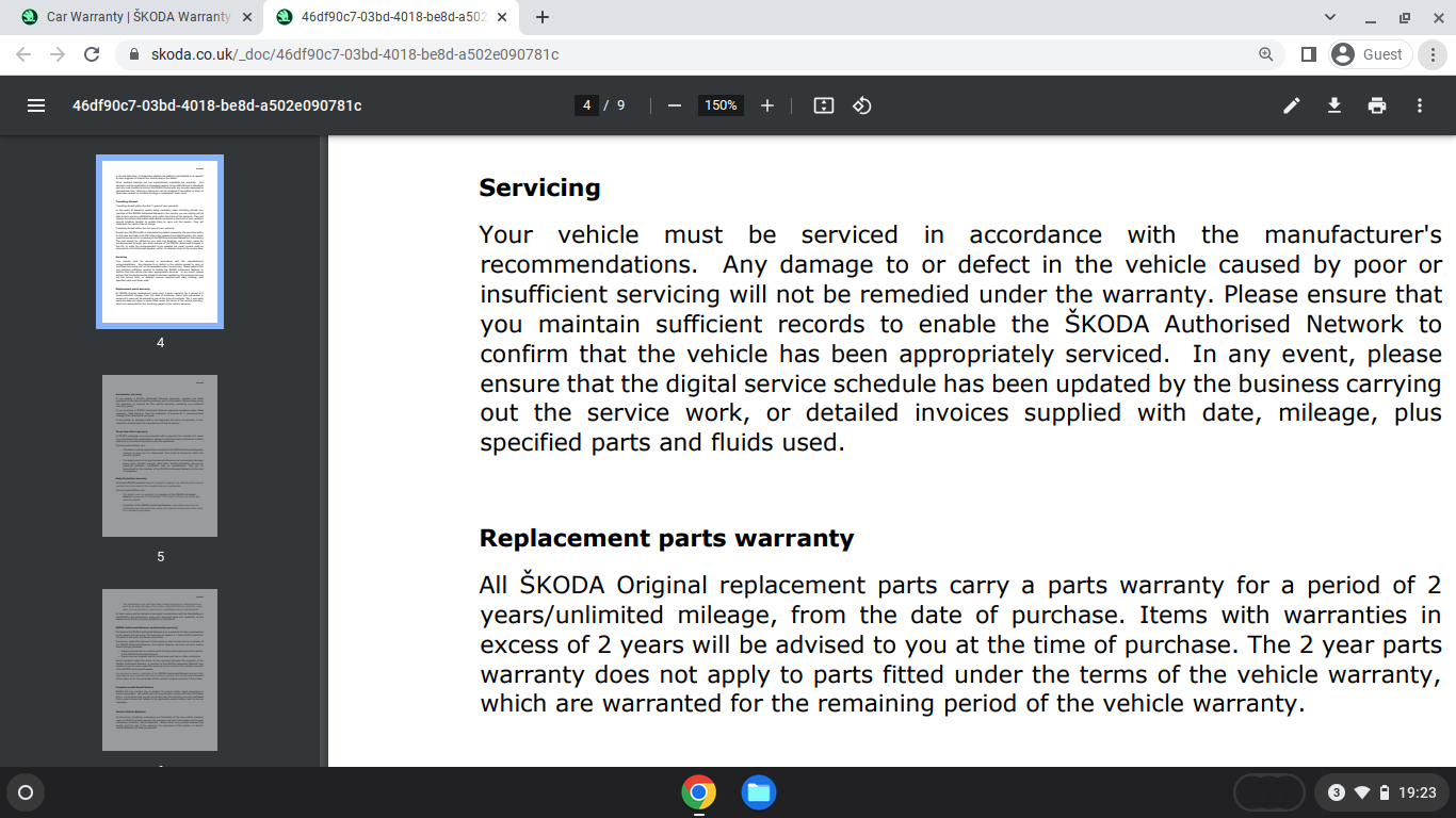

SKODA_Warranty_Terms_November_2021 (2).pdf

You are going to be on a sticky wicket with the warranty over the servicing.
There is a few weeks grace (normally a month) because dealer's can't always book it in straight away.  There were special exemptions during the initial lockdown periods because dealers were shut.
Strictly delaying the service 2-3 months means it wasn't serviced in accordance with requirements.   They are wrong to advertise it as having balance of manufactures warranty if they know it has been invalidated.

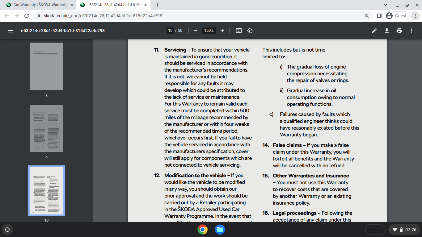

If you read the Manufacturers Warranty & Terms & Conditions & Servicing as linked above this is different from the 'Used car extended Warranty'. BOOKLET.
That is where the 500 miles / 4 weeks is in the terms.
VWFS_11815379_SKODA_AUW_Booklet_0922E.pdf
