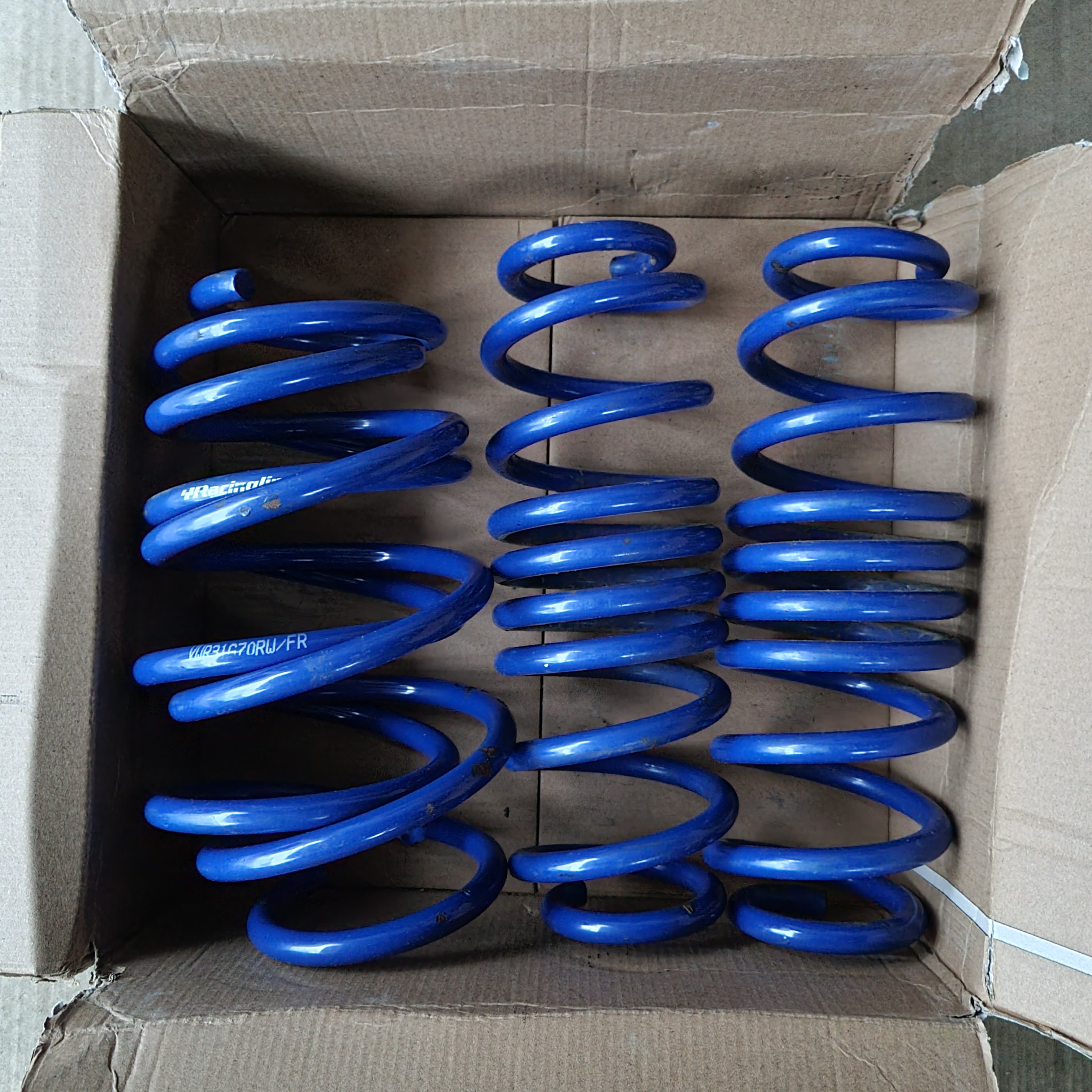

Hey all,
I've got some VWR Racingline 20mm lowering springs to fit soon and I am wondering if I'll need to adjust the headlights. Theres alot of topics from research, some saying yes, some saying no and ways of adjusting them (right way through VCDS or OBD11) or the wrong way through the Allen key screws.
Who has fitted these particular springs and did you have to adjust anything?
Thanks in advance!
