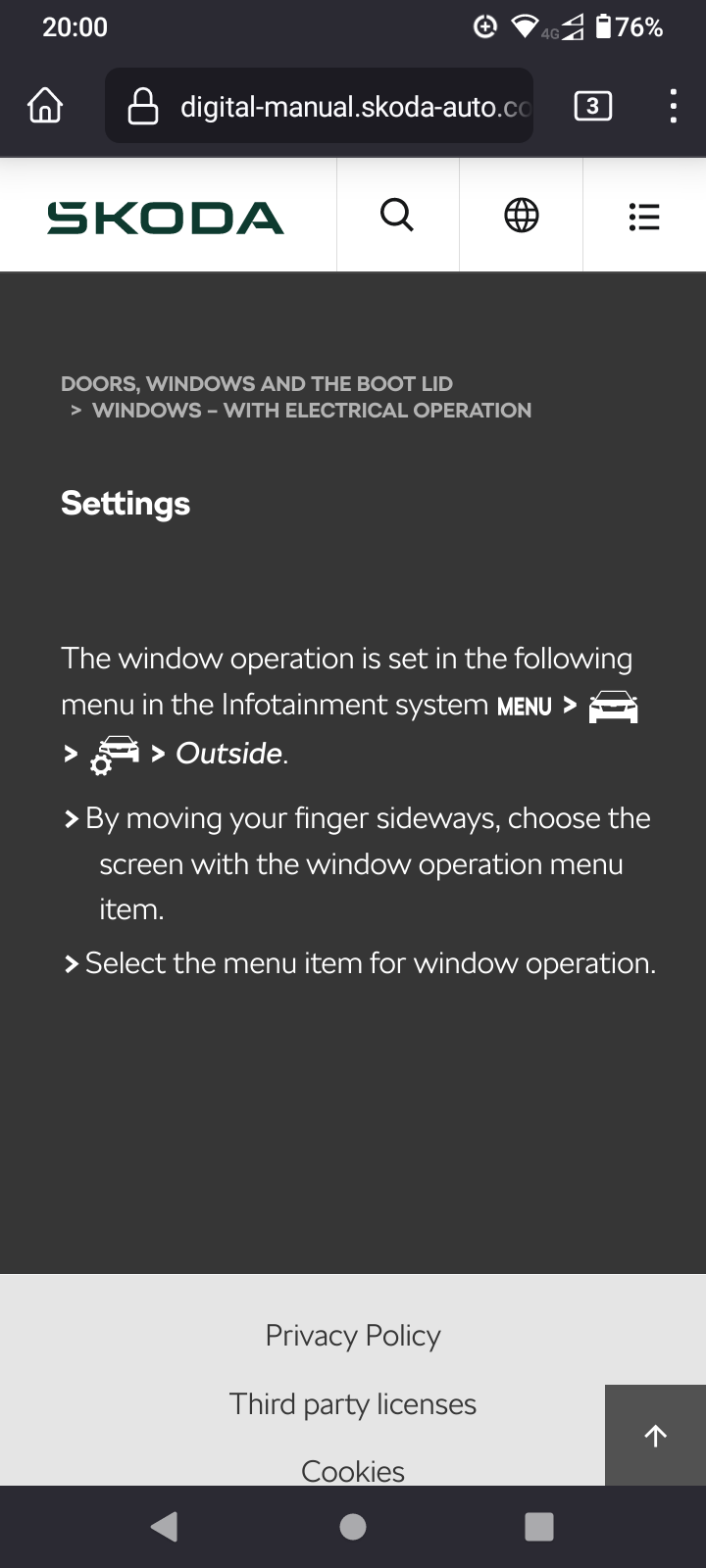

Try all the convenience or locking settings in the infotainment, car, settings, might be something in one of those sub-menus for your model.
