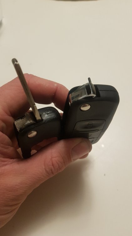

It worked!
Thank you so much guys, me and the missus are extatic that we got it working again, really appreciate how helpful you all have been!
To answer your questions above, and maybe help others in the future with similar problems, the skoda mechanic changed the ignition lock and ordered a new key.
The keyblade works in the door as well as the ignition.
The new key had the top part of the FOB+the blade, the bottom part of the FOB is from my original key.
I took out the small pin holding the keyblade in place and jammed it inside the top part of my old FOB, and it started right away(see photo).
Again, thank you so much!
Glad you fixed it. In essence what you did was use the immobiliser RFID chip from the old fob in the new fob. Well done.
