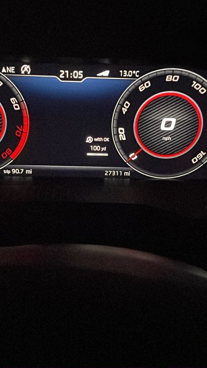

I’ve recently bought a 2020 Sportline Plus which comes with the virtual dash. I love the different layouts but haven’t been able to get the map to show. I thought it might be because I’ve been using Apple CarPlay but this evening went out and tried without my phone. Still no map.

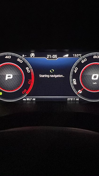

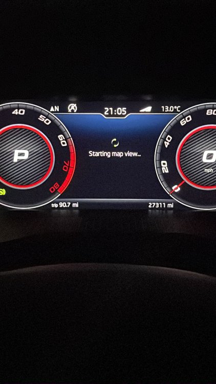

I’ve tried rebooting the Columbus unit and when it restarts, the map section of the dash shows ‘starting navigation’ then it changes to ‘starting map view’ and then nothing. When I try the right thumb wheel, you can zoom in and out but there is no map.
IMG_4677.thumb.jpeg.b5026a8b2c563474a6807099a14647a8.jpegAny ideas?
