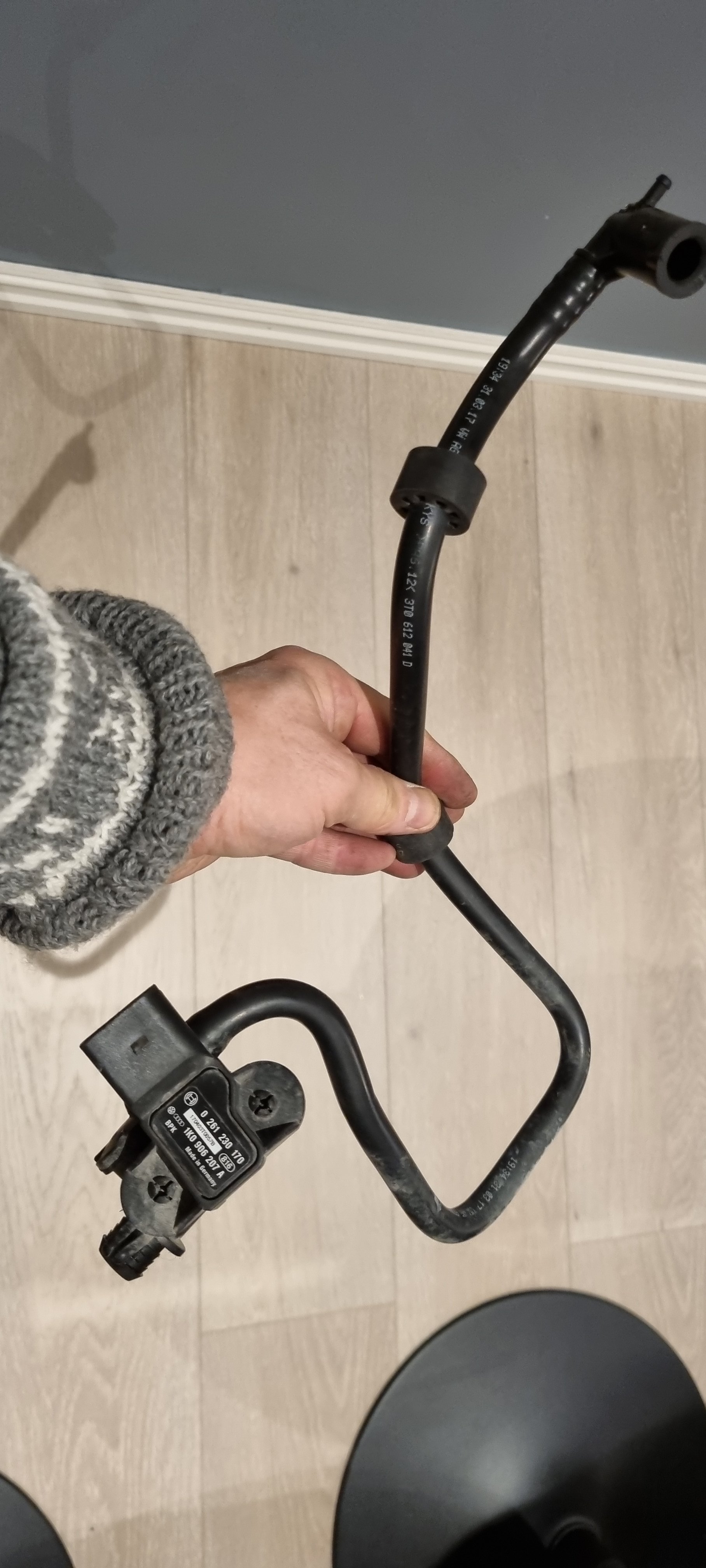

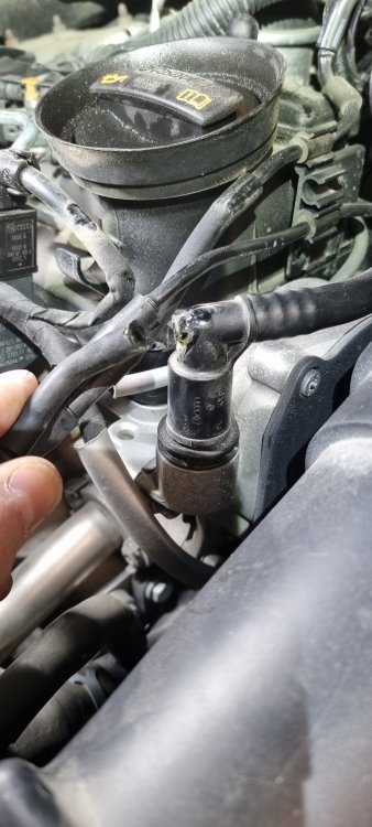

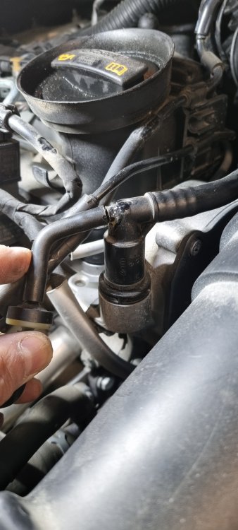

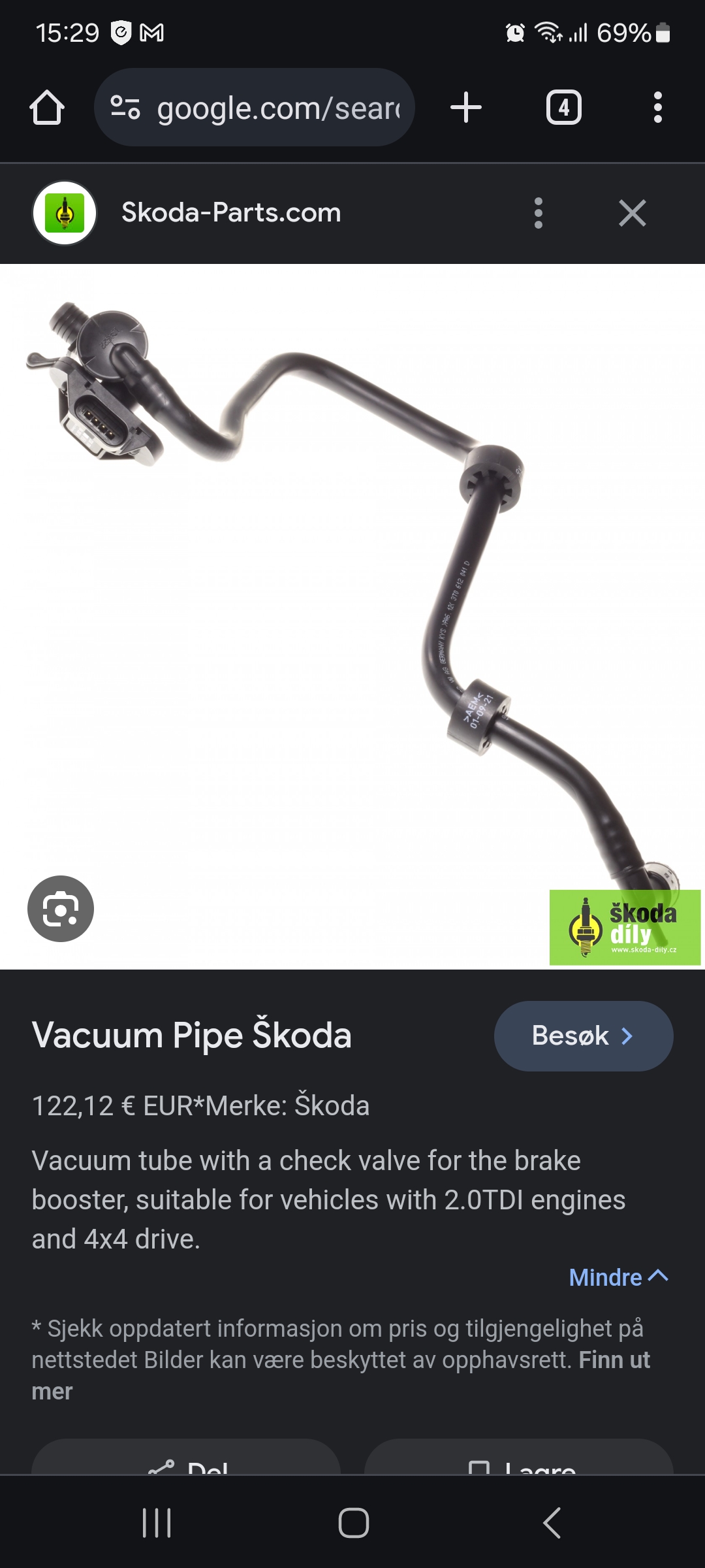

Had same fault code 1 week ago. P2563, with MIL engine and blinking glpw plug symbol. Got home to check for vacum leaks through vane turbo rod, to n75 valve and of course all turbo intake hoses, clamps etc. Found out that a non return vacum brake booster hose had a disconnected hose. A part had been broken off and to my surprise, this had happened before. Because the small hose intake had been glued before. See my picture. So I just superglied it back on and tried to se if that emergency fix worked. And it did, at least until I can order a new non return valve brake booster hose from dealership. Partnr for my 6spd dsg,  4x4, 2.0tdi engine is 3T0 612 041D. The pipe is connected directly to vacumpump in engine and to brake booster housing. The small vacum hose notch almost directly connected into vacumpump that was broken went to another vacum hose. I bet you will locate it in your engine bay.
