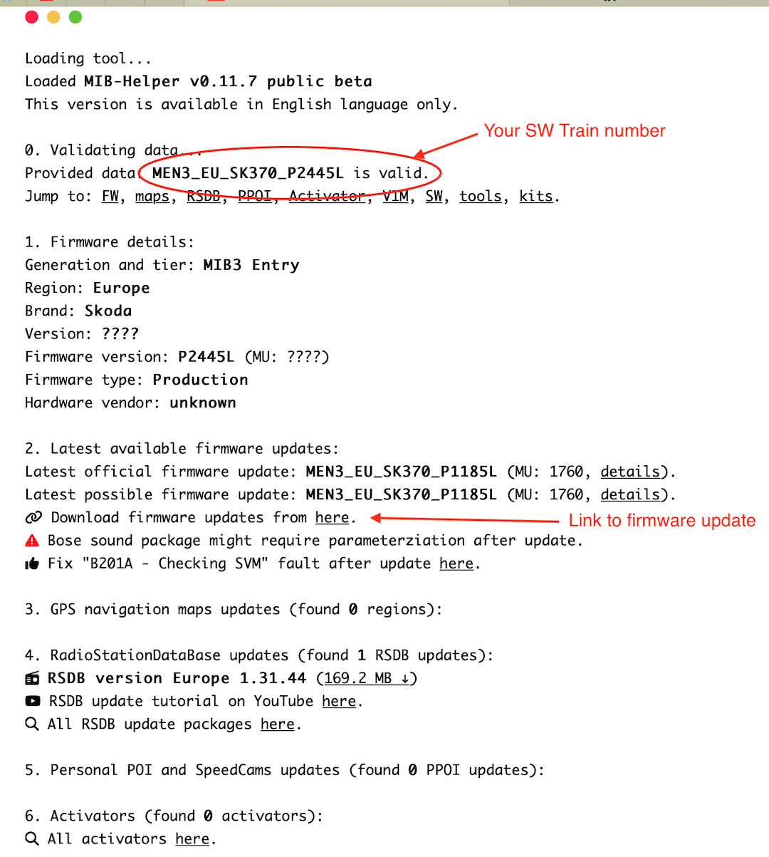

This is the result of putting your SW Train number in MIB-Helper.com but I do not know enough to advise on CarPlay updates.  I would advise NOT to do a firmware update until you find out if this is required for CarPlay.
