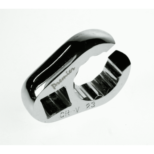

  11. My friendly garage has agreed to lend me the tool. Is there a torque setting for the inner nut?
  12. Not sure to be honest. I need to get someone to waggle the wheel while I feel around for movement but I'd have thought worn wishbone bushes would need more than a gentle rock of the wheel to show up. Regarding undoing the nut I guess the advantage of a crowsfoot is being able to use a ratchet with its short throw between clicks. I have access to a 4-post lift which will make it easier I guess.
  13. Just seen this and I suspect I have a worn inner tie rod. Had excessive wear on driver's side tyre and fitters didn't track it as they said there was excessive play. Sure enough a small but noticeable movement laterally but nothing top and bottom. Anyway couldn't see any movement wheel off so went for the cheap option of a new track rod end. Movement still there but inner rod did seem quite loose and holding the gaiter I could feel very slight movement. Before I commit to buying a 32mm crowsfoot spanner - mine are too small - why can't it be done with an open ended spanner? On the first picture there looks to be ample room for one. Oh, and does it need to be a thin crowsfoot or will one like this do?
