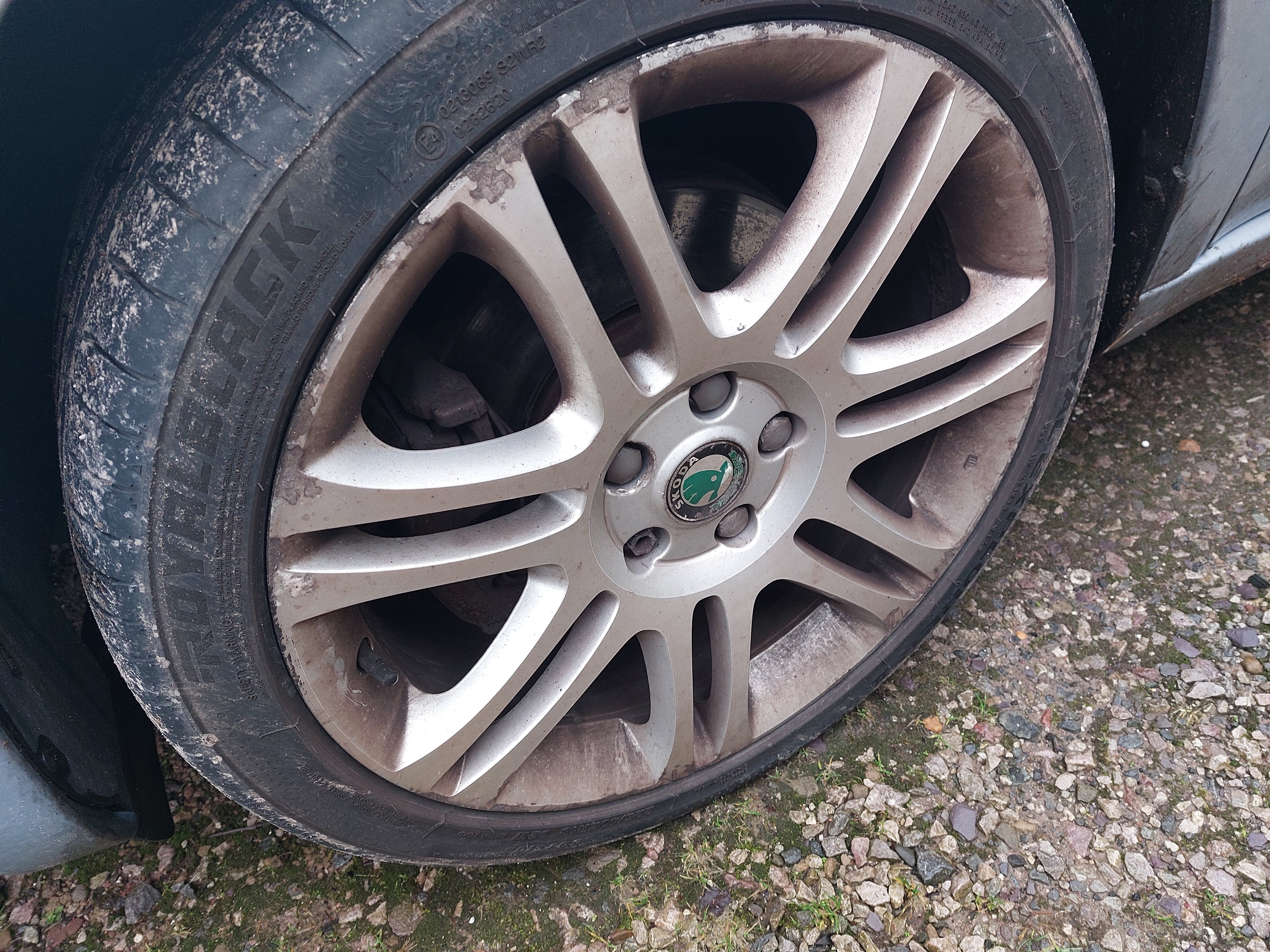

Will these audi rìms ( et43 ) fit / replace  my standard skoda rims ?

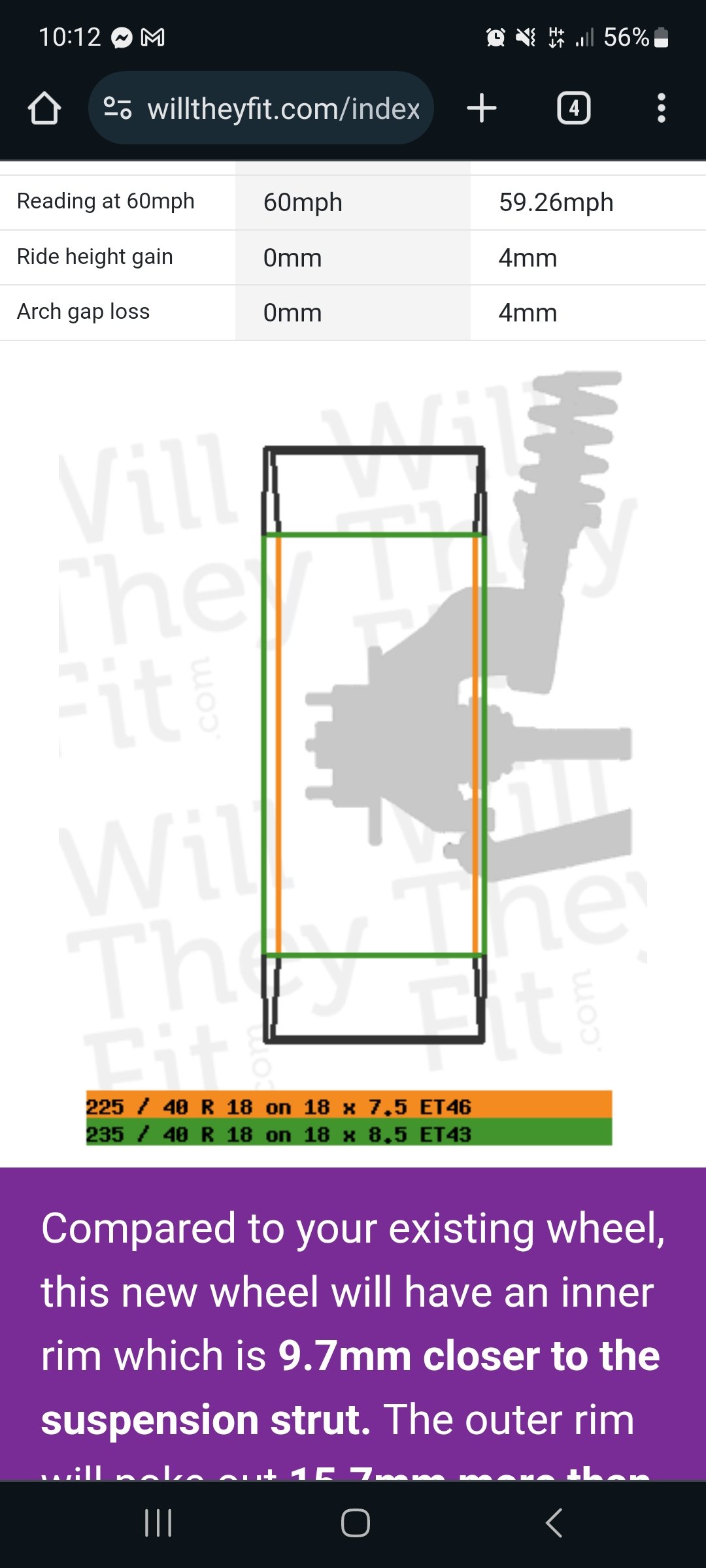

According to willtheyfit.the wheel ìs 10mm closer to the strut. Will this be a problem  ?
Anyone?  Will10mm difference be a problem  ?
Those charts are wrong because the widest part of a wheel isn't the rim, it's the inflated tyre.

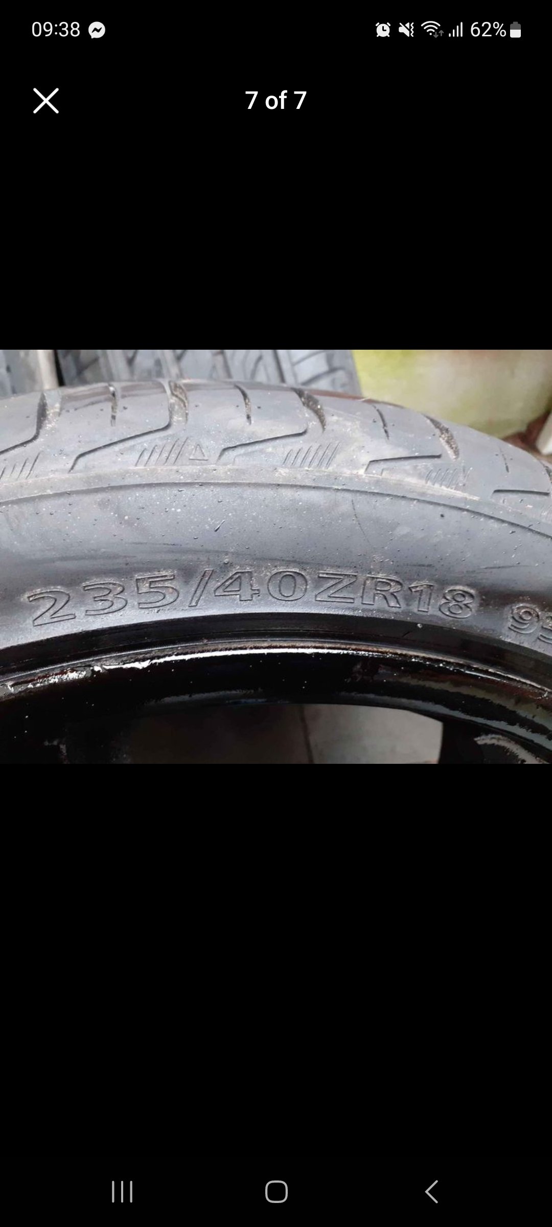

Actual width of inflated tyre
225/40R18 fitted to 7.5J rim 224mm
235/40R18 fitted to 8J rim 235mm
So if you fit a tyre that has an actual inflated width of 235mm instead of 224mm, it will be 5.5mm closer to the strut assuming the offset is the same. If the offset is 3mm further out it will be 2.5mm closer to the strut.

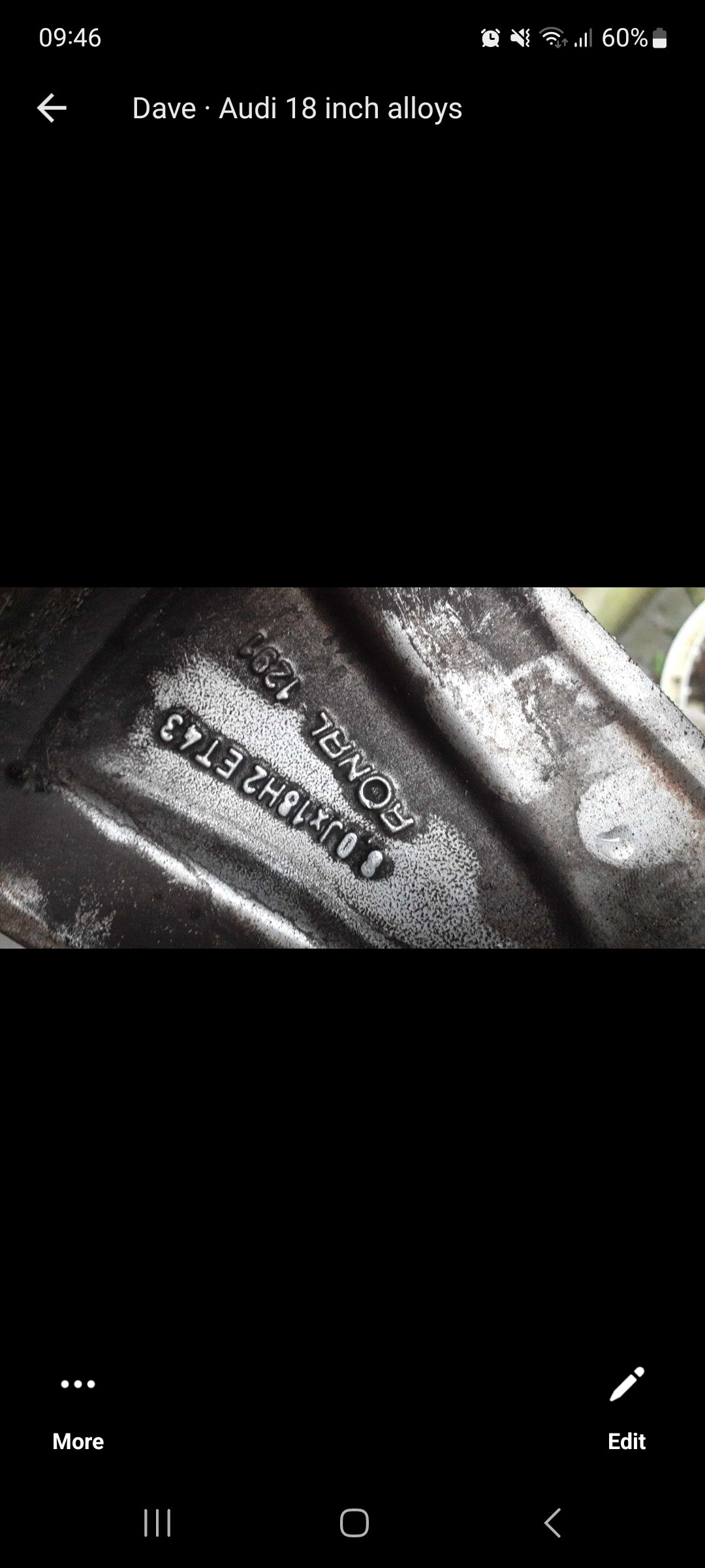

What is the full specification of the Audi rims you are looking at?
The full specification looks something like this: 8Jx18 ET43 5/112 57.1
There was a big change in the hub centre bore when the Audi A4 B8 came out in 2008...the hub centre bore changed from 57.1mm to 66.6mm
So if the rims are from one of these later Audi A4 cars the hub centre bore will be too big.
Edited by Carlston
 8Jx18 ET43 5/112
Can't see the bore diameter though.
