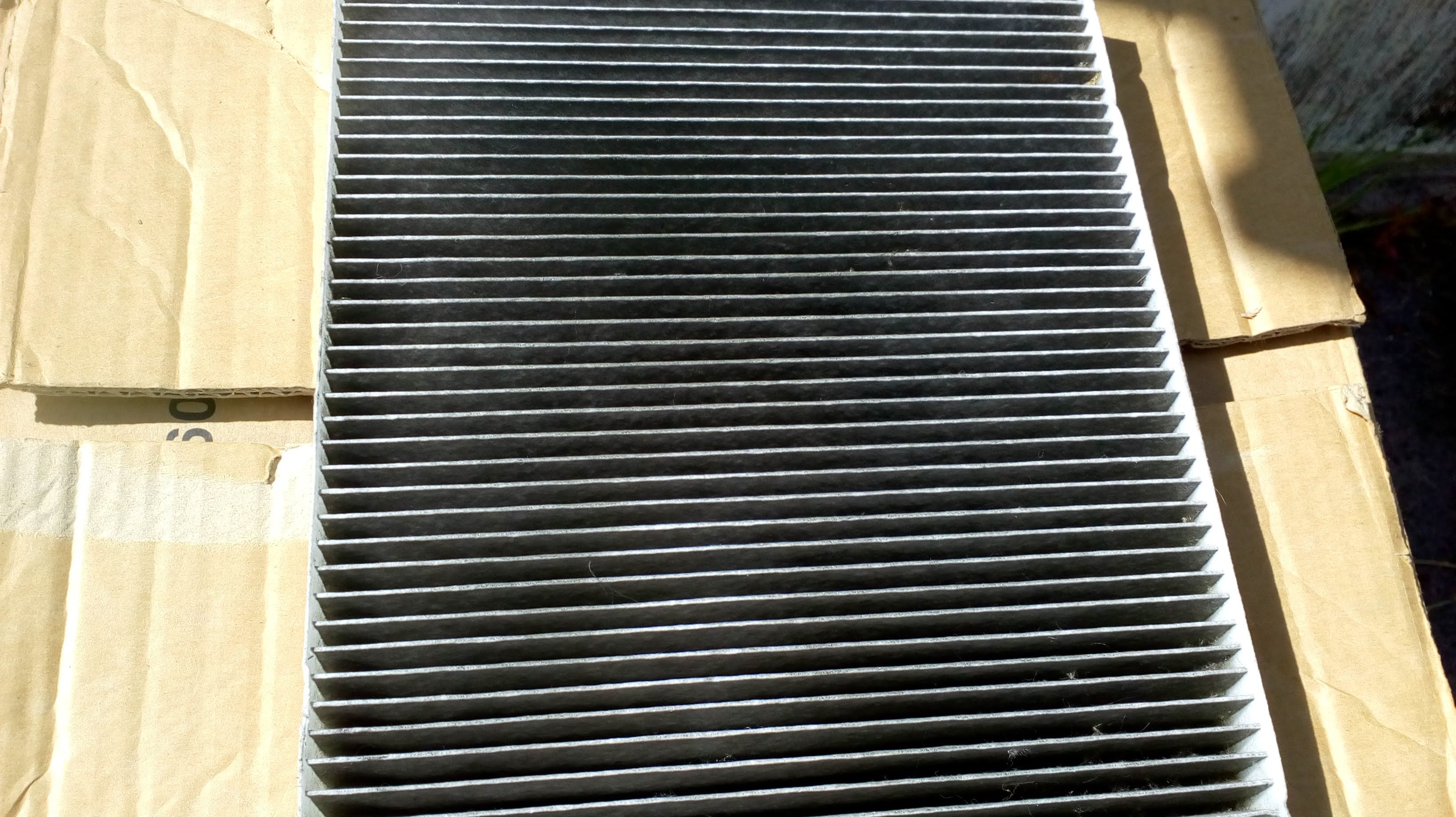

2, Cabin Filter
The old one pretty dirty.
[img]https://i.imgur.com/GpO34qR.jpg[/img]
Not changed since 2018 and 37k miles the service history suggests.
Already checked this a few months back, so knew it was only a 5min job. Just push the two clips inwards and the cover comes off. Slide the old one out and the new one in observing the air flow arrow on old and new filter and hope that the old one was in the correct way round (air flow pointing towards the driver's side)?
