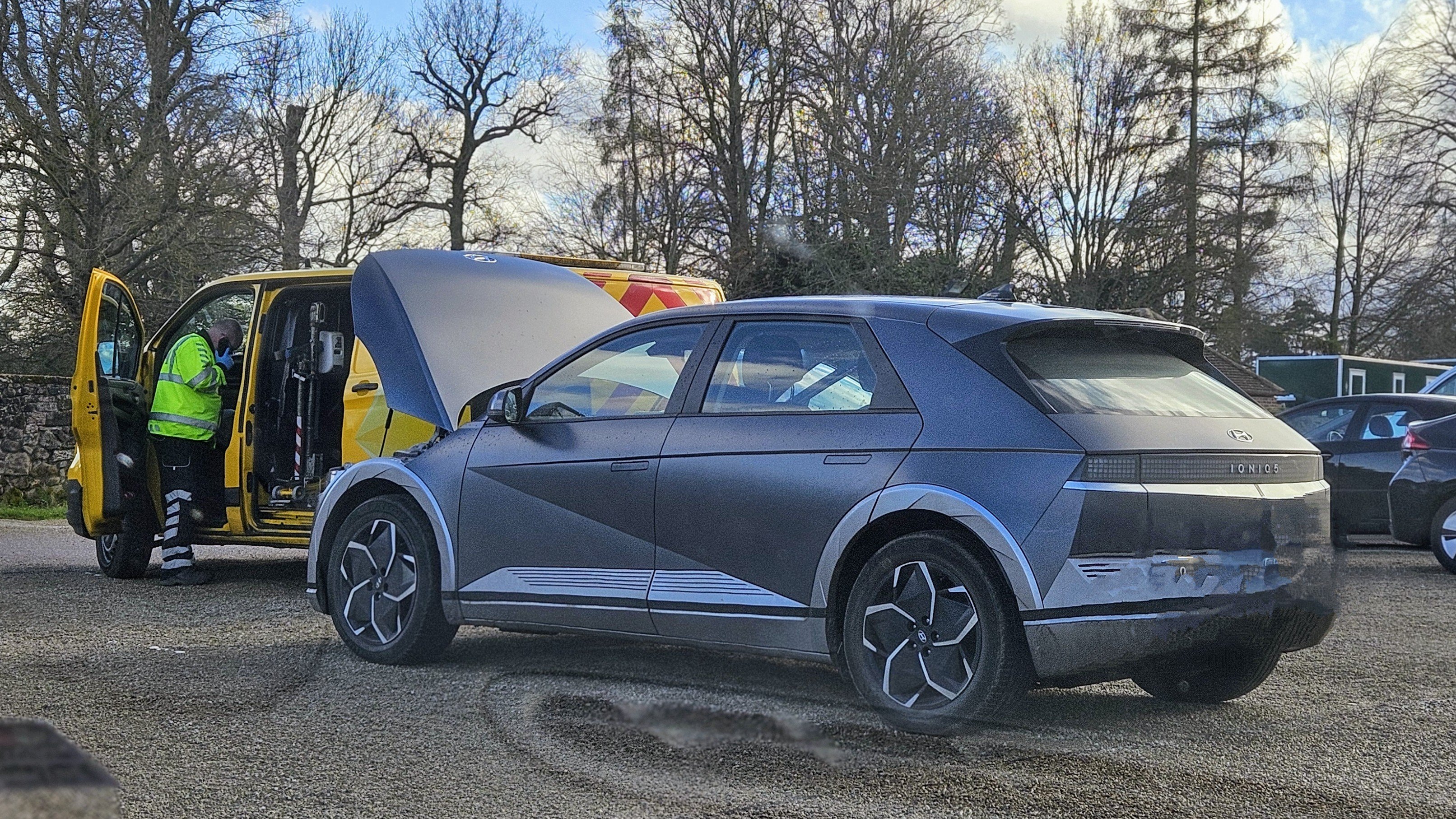

Not a sight I expected to see....
The AA guy looked a little puzzled and was presumably seeking advice from Head Office?
I was passing in my 21 year old V8, but suspect a jump start wouldn't have helped matters ⚡️

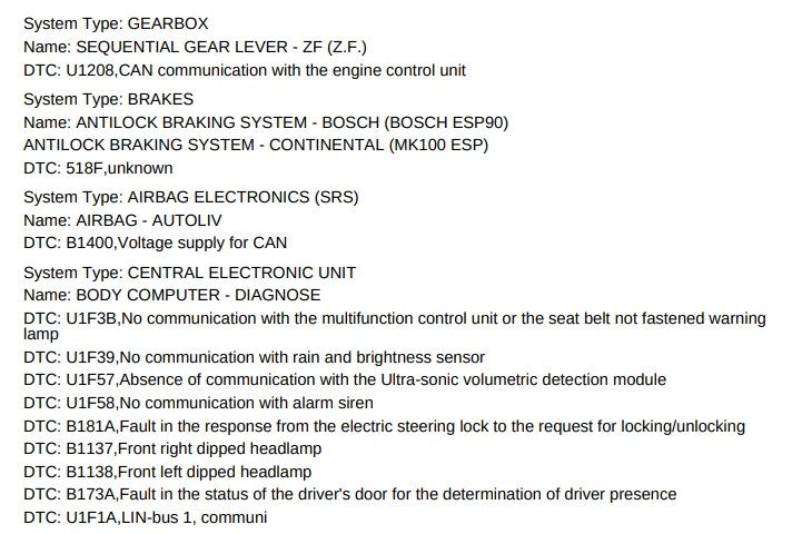

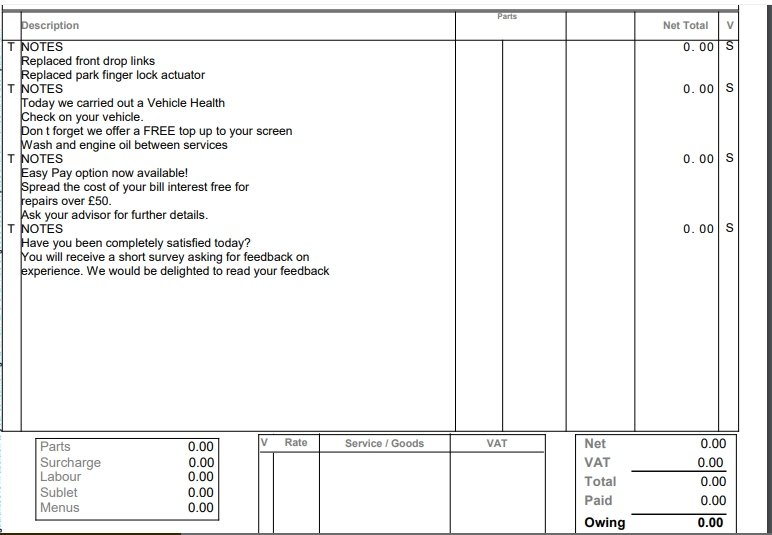

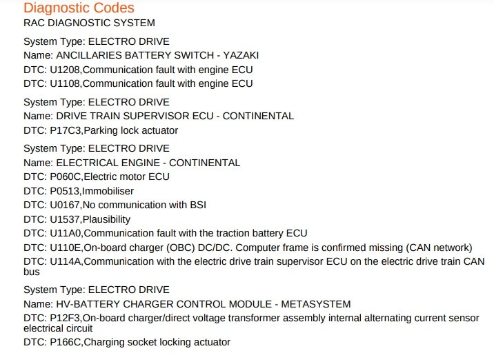

Usually it is just AA or RAC attending and after trying to start the cars or trying plugging in and doing a reset then calling for a recovery vehicle.
eg
All day before being recovered by someone not prepared for a BEV and without any idea which were the drive wheels and all 4 wheels were locked / braked.
Weeks to get fixed.
* The Recall was out for quite a while without Keepers being told of the Recall and even though the car was recovered because locked in gear and non start the car was returned without the RECALL ACTION having been carried out.*
