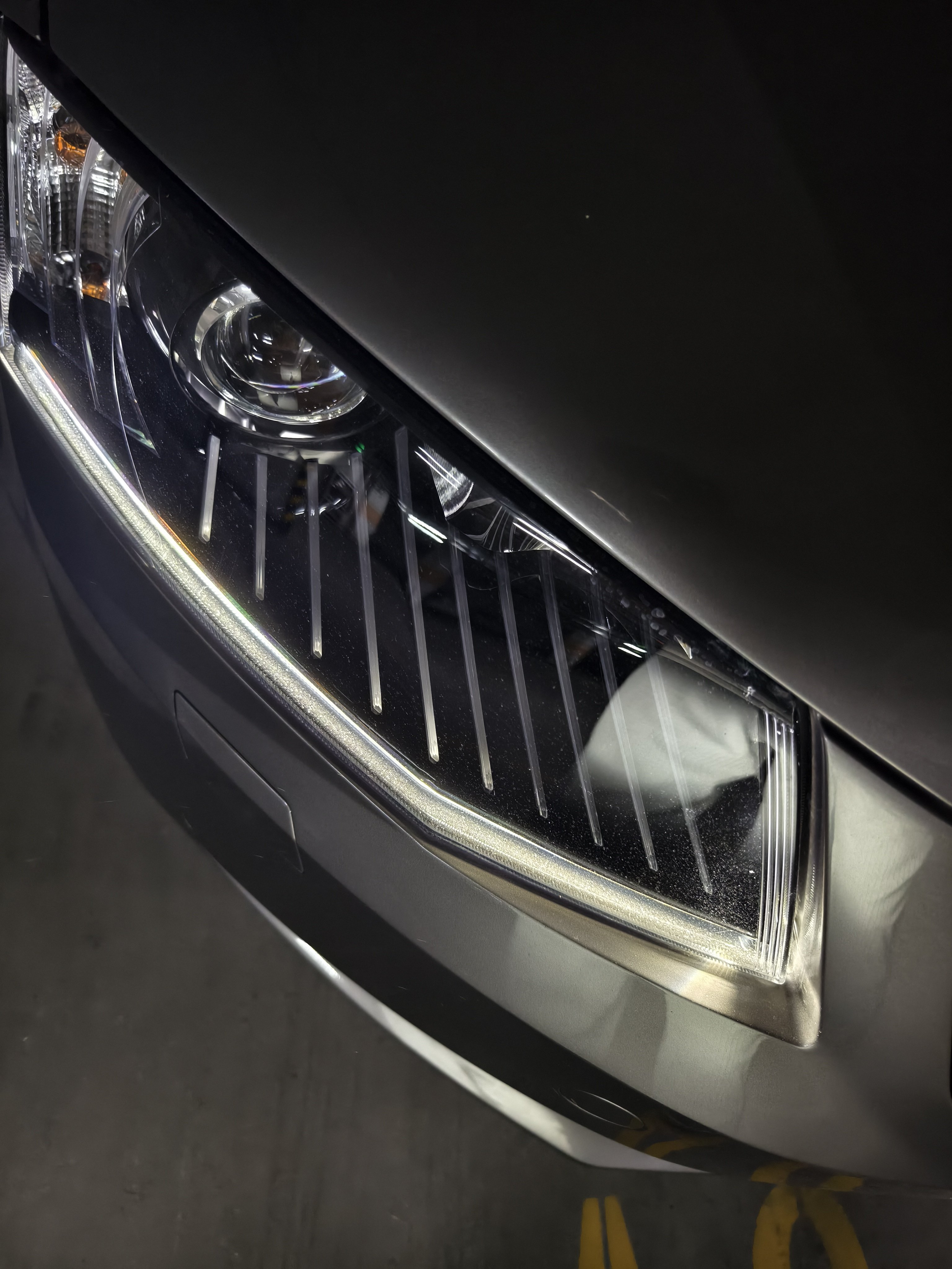

朋友们,我的车是奥克塔维亚MkIII2015,黄色睫毛灯怎么开?就像图像一样它不起作用。

My car is Octavia MkⅢ2015,How to open the yellow eyelash light? Like the image,it doesn't work.
I checked the little lamp back of the reflective tile it's ok,Can i open it in VCDS?

Yes, the LED daytime lights are not removable,and my LED is good.

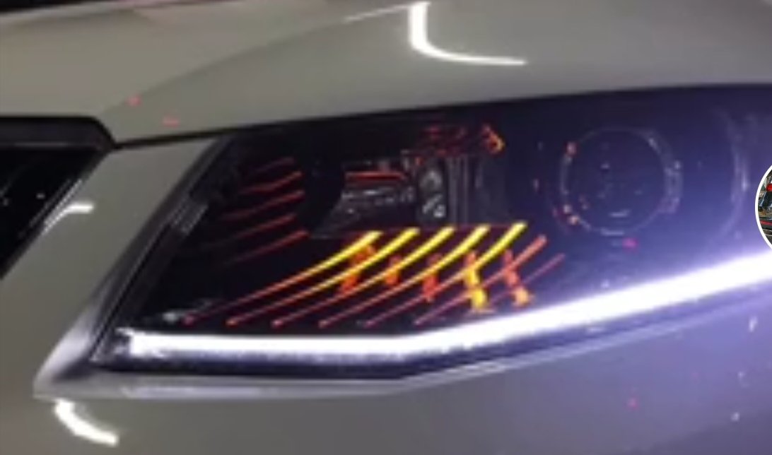

In fact,what I want to say is that the part above the LED, I think is more than someone coded off.Just like the yellow light in the picture.
22 minutes ago, Eastnieder said:
There is a small yellow bulb on the back of the reflective tile which provides light source, I took it out and did a test, it is good.
